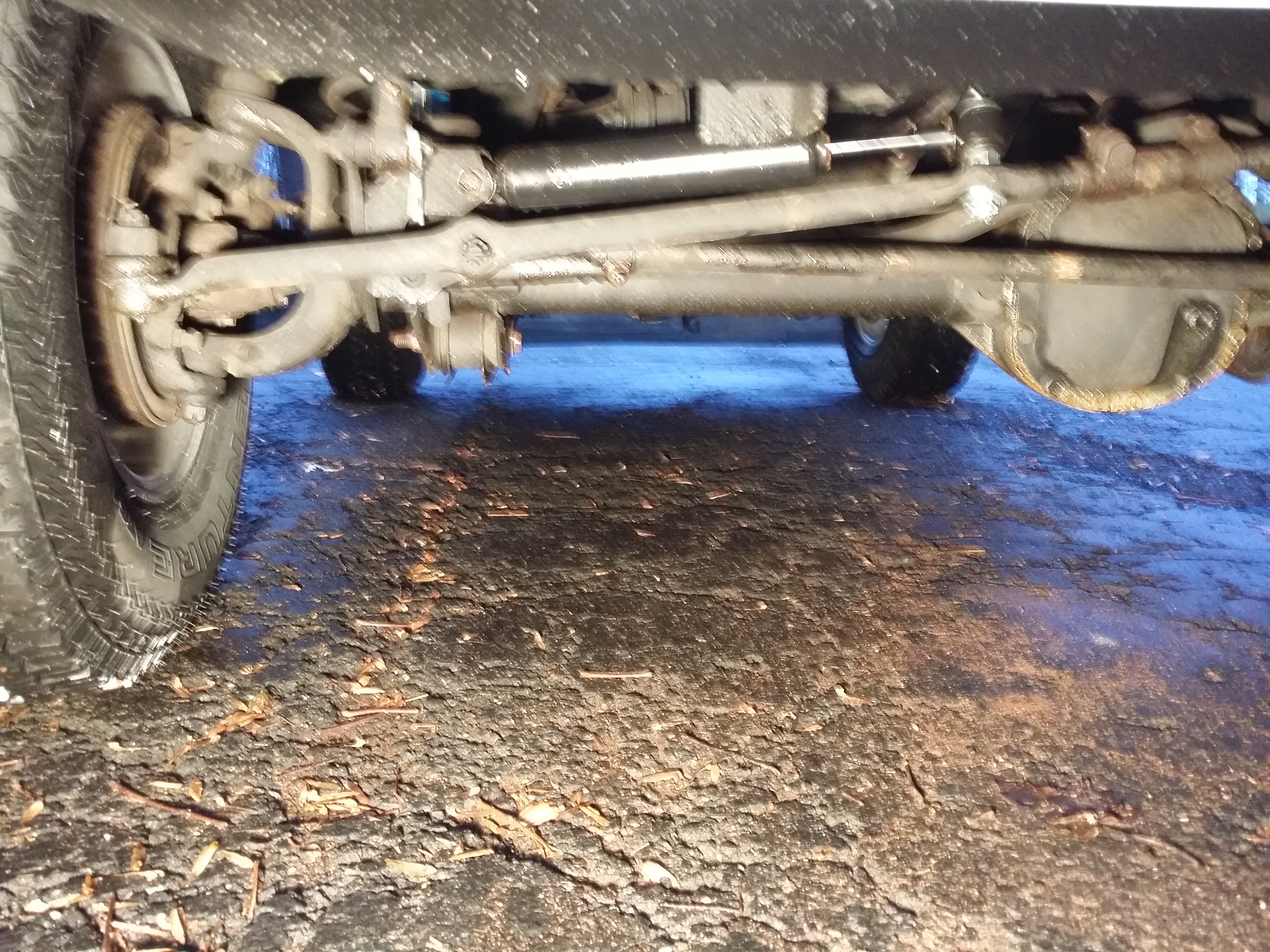

Shoot a pic of your front end like the pic I posted of someone else's vehicle.
Here you go sorry cant do chalk test till it stops raining

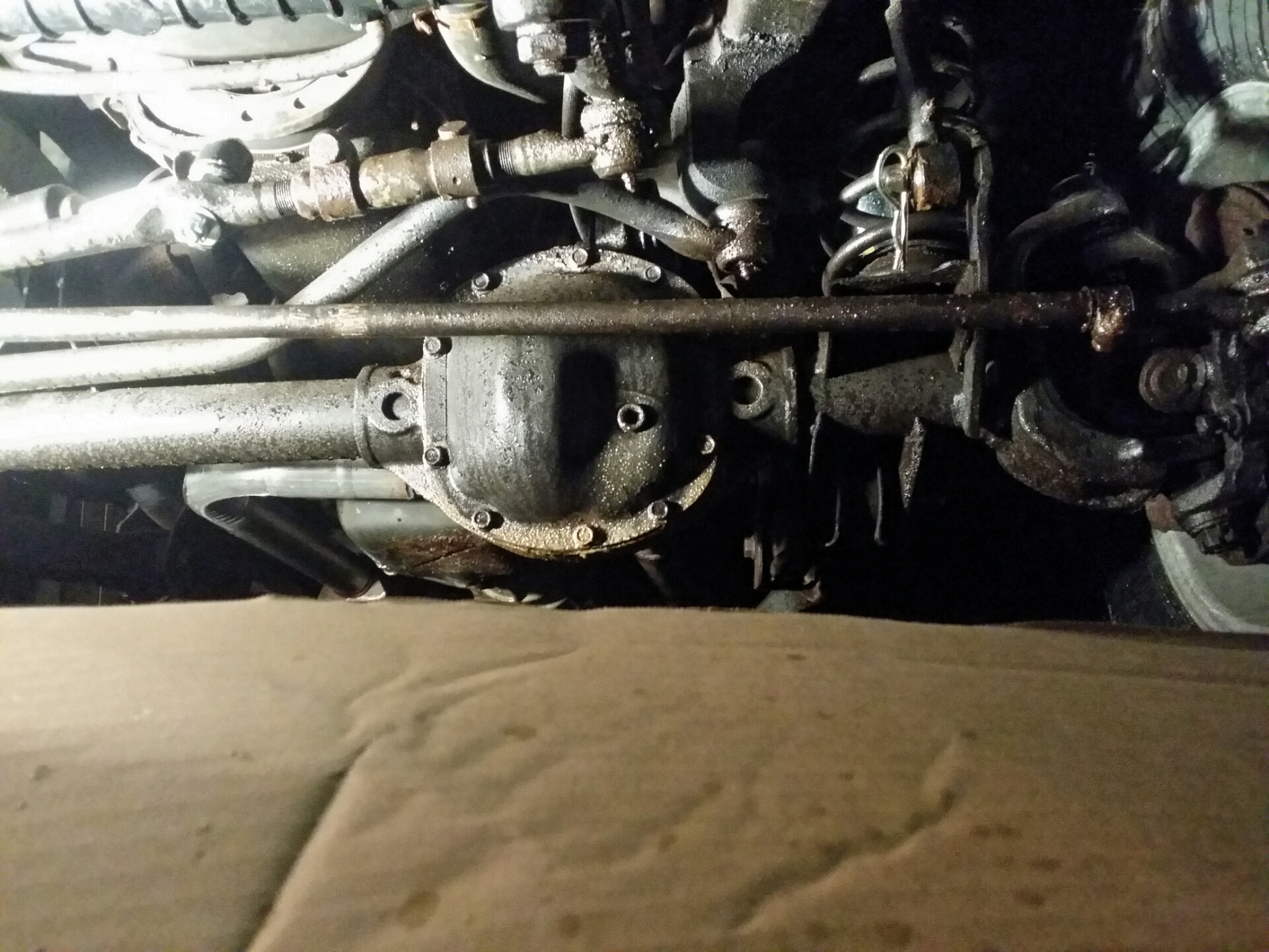

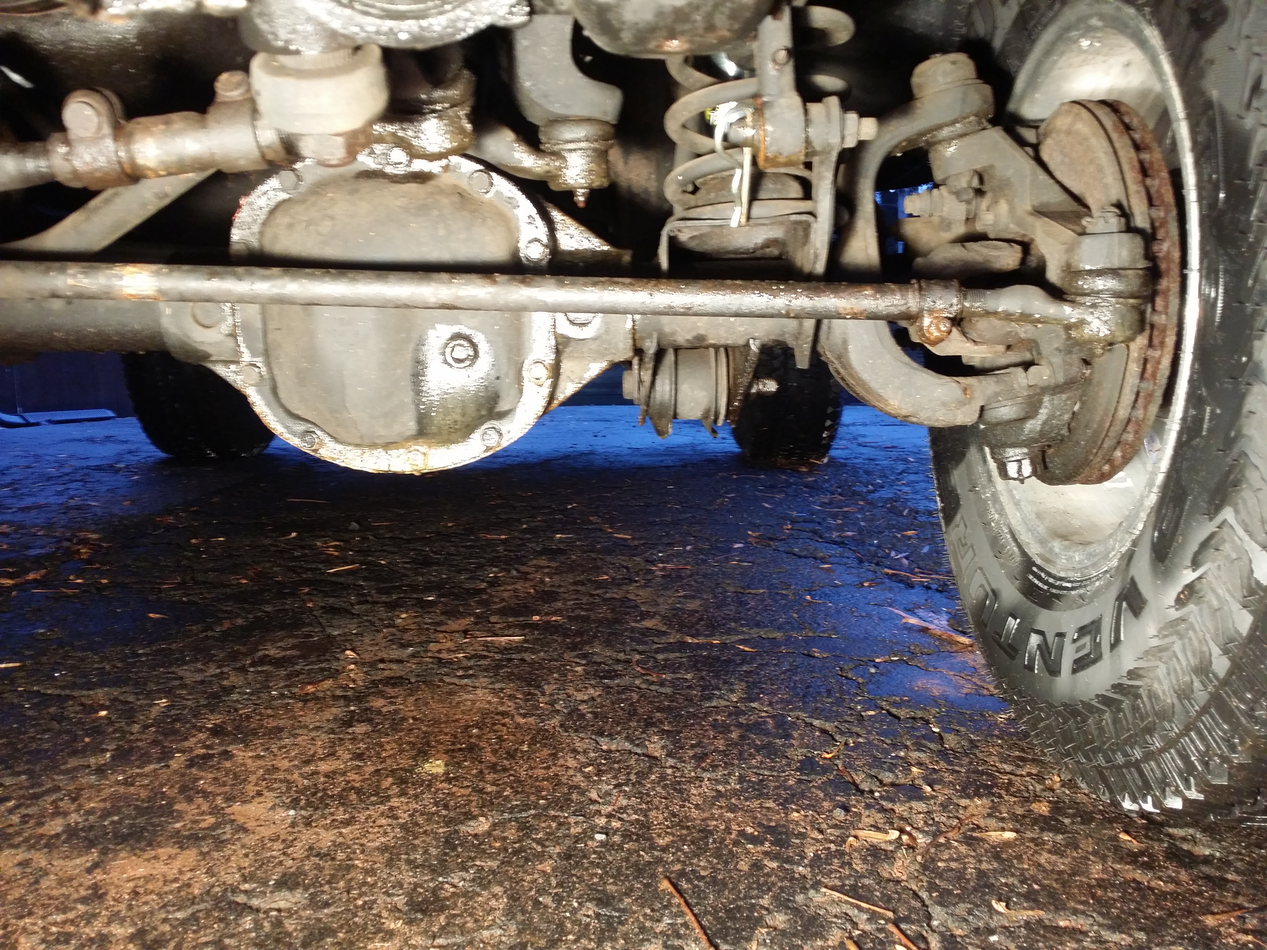

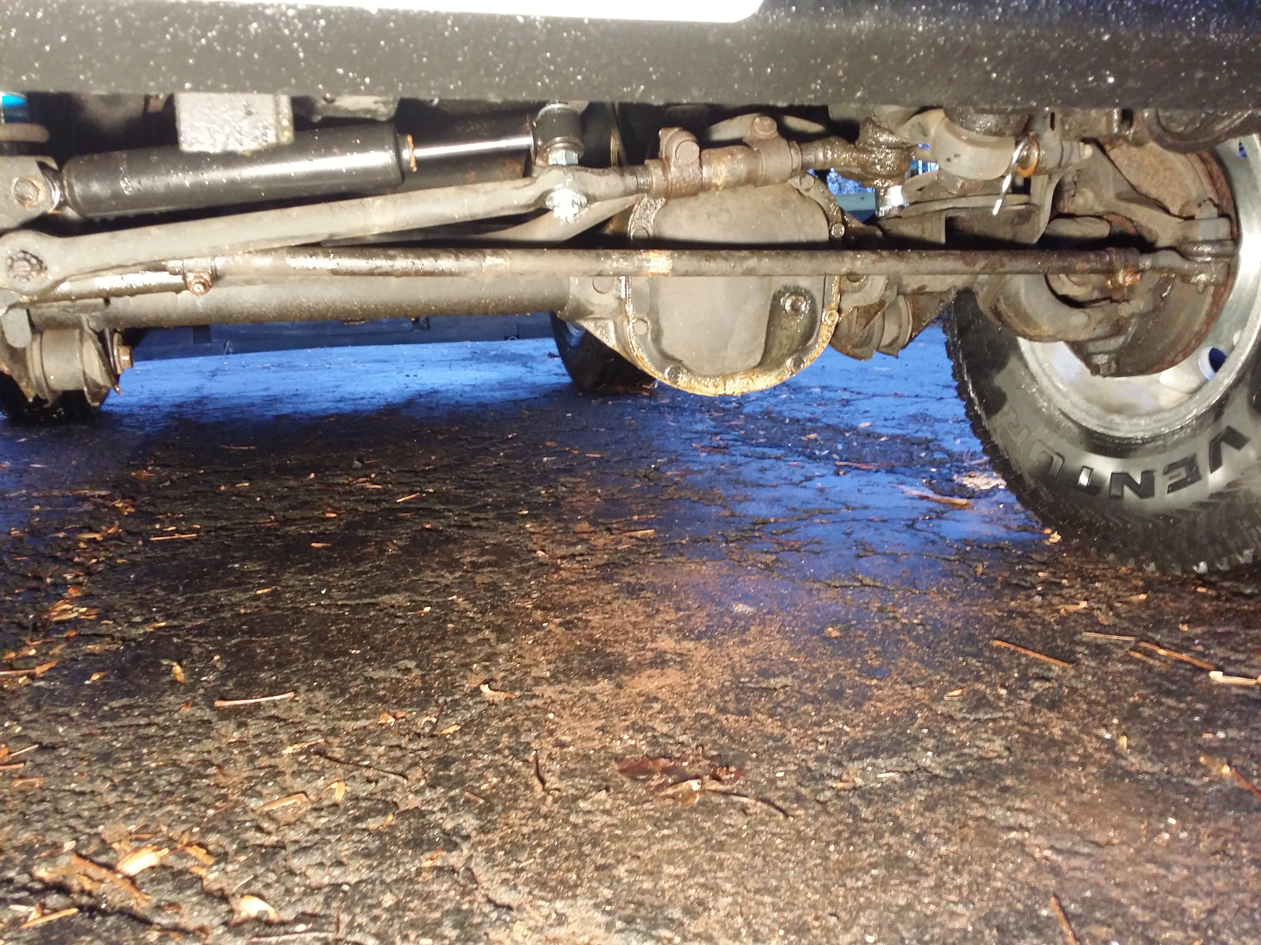

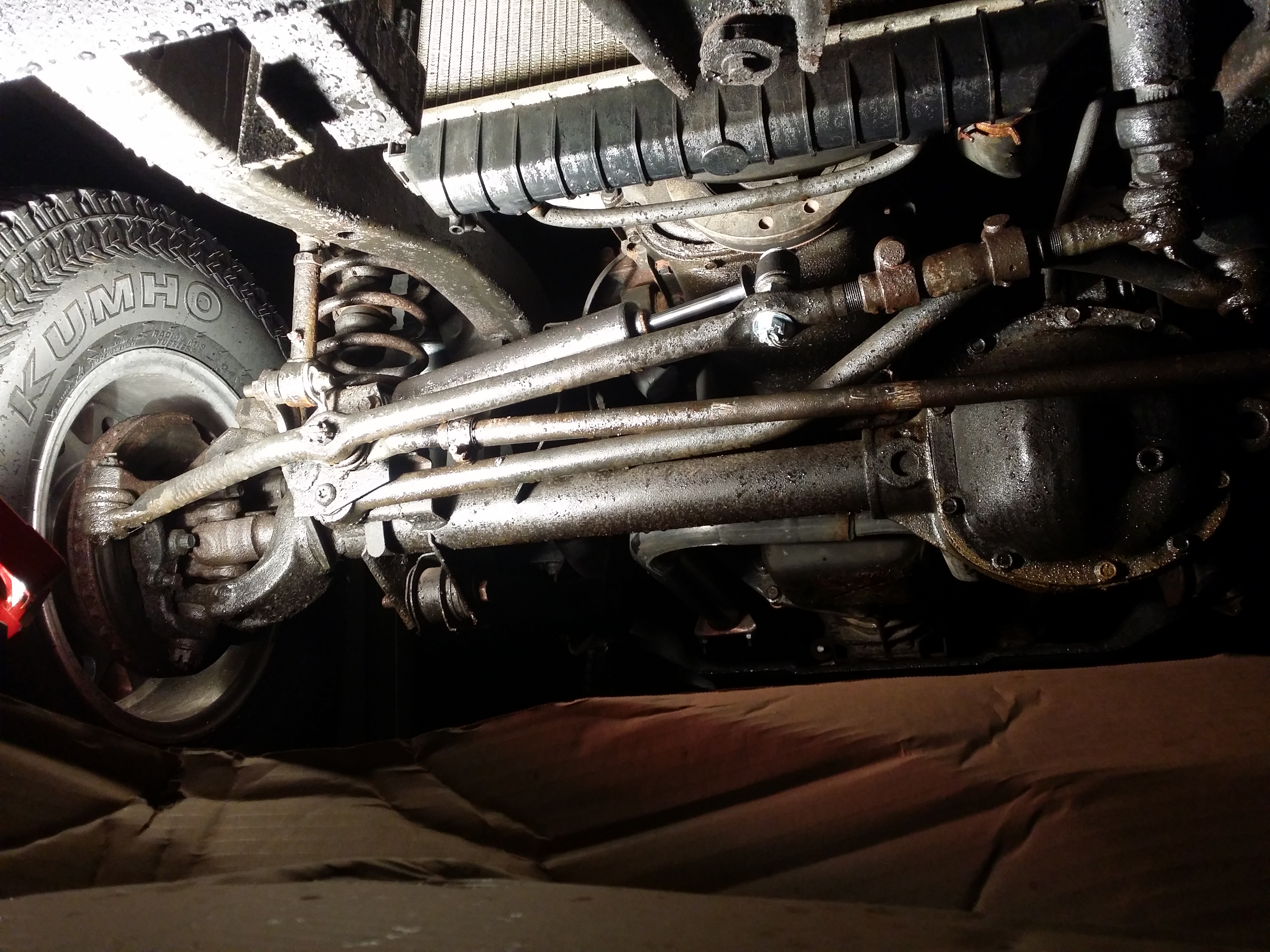

Here you go sorry cant do chalk test till it stops raining <img src="http://www.jeepz.com/forum/attachment.php?attachmentid=21362"/> <img src="http://www.jeepz.com/forum/attachment.php?attachmentid=21363"/>
Whoa! A few things need to be verified. I'm hoping more will look at this and comment. Maybe more pics in the light of day.
The short side of the axel drivers side looks to be severely bent.
The drag link past the tie rod looks bent. Ok that may be normal. Not sure how much bend there should be in the drag link.
Tie rod is bent.
There is a slight bend in the passenger side axel tube..
Is that upper ball joint on the driver side new! I'm wondering if it is an offset one to correct for the bend?
That's got to be an illusion because of the lighting. The axle tube being bent that bad and the steering linkage being bent that bad would have caused someone to say something

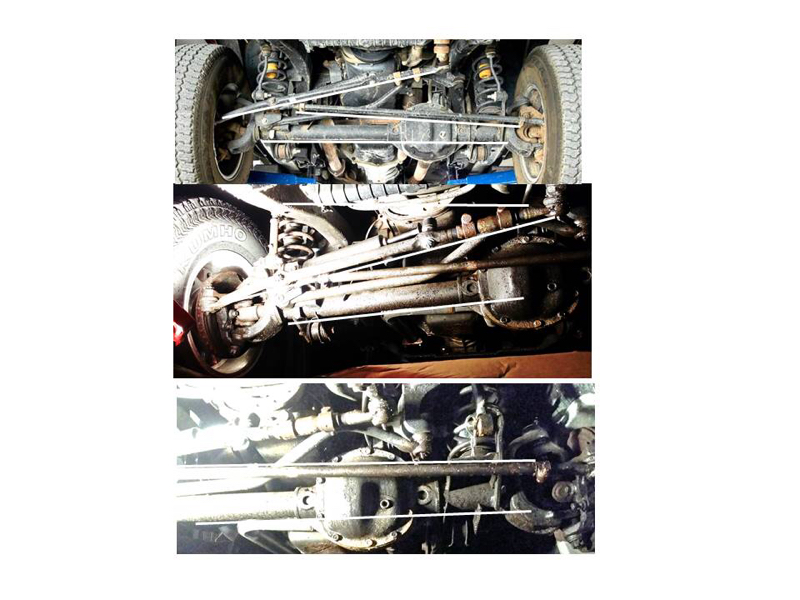

You guys are a riot i just ran out in the downpour half dressed to check if i got ripped off and i can confirm the axle is straight. Talk about phone distortion. Any chance you could mark specific areas on photo to check for any bend? Im afraid at this angle without a lift it will never look truthful.
There are three images.
The top is the picture I posted. The white lines are straight.
Biggest bend is the driver side. Right on third image down.

The better lighting does help but if I draw a line across the bottom of the longer side of the axel the shorter side (close to the knuckle) still appears to have a gap.
