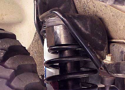

Caster reduces with suspension lift. You are correct stock springs or a tired lift springs they are at stock height. Given there are no thick spacers on the springs (called budget Lift or budget boost. See pic) you should be at stock caster of app 7 deg. I don't know where the change in caster would be from. Shorter lower control arms or longer uppers.
Wait, so thats a third type of lift that can add inches to total height in addition to people having suspension and BL? I think i might have those spacers thought they were just stops i have to look closer one looked cracked now i hope its not a lift lol. As for the steering having a valve put on to control PS softness, fingers crossed.
Yes they are spacers the spring sits on. A cheap way to get up to 2.5 in lift.
