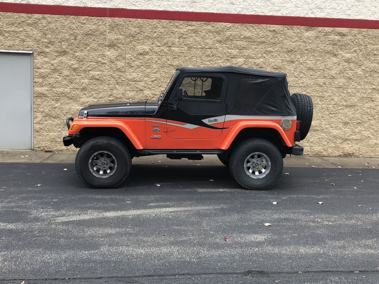

This is a 3 in lift with 1.5 body lift on 33s. See how the wheels look pulled to the center. Image1699577424.790229.jpg
Center with the bottom control arm and correct caster with mostly with the upper.

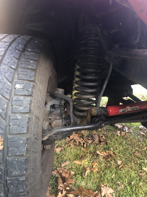

How about images of the front end underside? Like this
Never look down on anyone unless you are helping them up - Jesse JacksonImage1699847243.961997.jpgImage1699847250.797316.jpgImage1699847261.092459.jpg

Your tie rod is not parallel to the front axle, or ground. Thats something i remember reading that will cause issues. Is lie where it connects to the driver side is upside down?
Let the tj pros come look and see what they see, though. Dont go solely off my response as my tj has its own steering issues, still :(
Your springs look bound up from not having longer control arms. They are bending along the radius of the control arms. Also the Cs look straight up and down so caster is zero.
It looks like you have the original track bar. With this the front tires will stick out the drivers side more and not be centered under the vehicle. Cant tell from the pics.
Check your shocks the one doesn?t look right. It looks bent at the axel side. Could be the pic angle.
The drag link and track bar are parallel so that is good. But the track bar looks original and likely short.
Edit ok so the drag link should have a bend near the end. Had to look at myown.
Hmm that drag link bed or lack there of is curious…it could be something that was “fixed” as they were trying to get it on the road after it got totaled. Previous owner said it got hit on that side.
