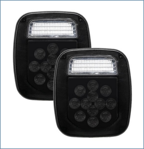

Black / smoked tail lights - $30.29 on Ali Express.
These are generic black tail lights, and you could also get them on Amazon for a few dollars more. They also offer red if you're not into the Knight Rider look that I'm going for.

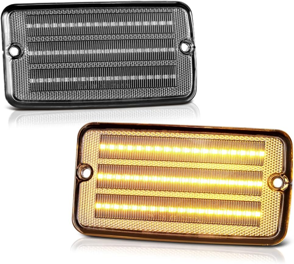

Amber Sequential Turn Signal - $29.99
These have a cool feature where the turn signal starts at the center of the Jeep and moves towards the outside.

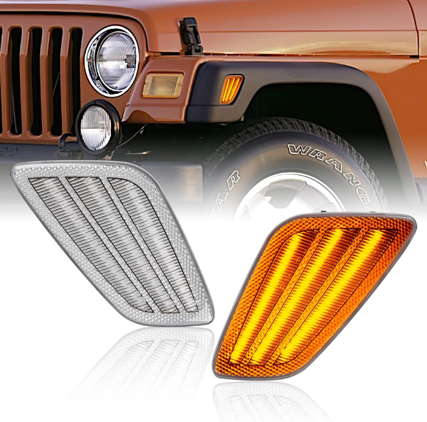

Front Fender Side Marker Lights - $19.99
Nice looking clear lights that light up yellow

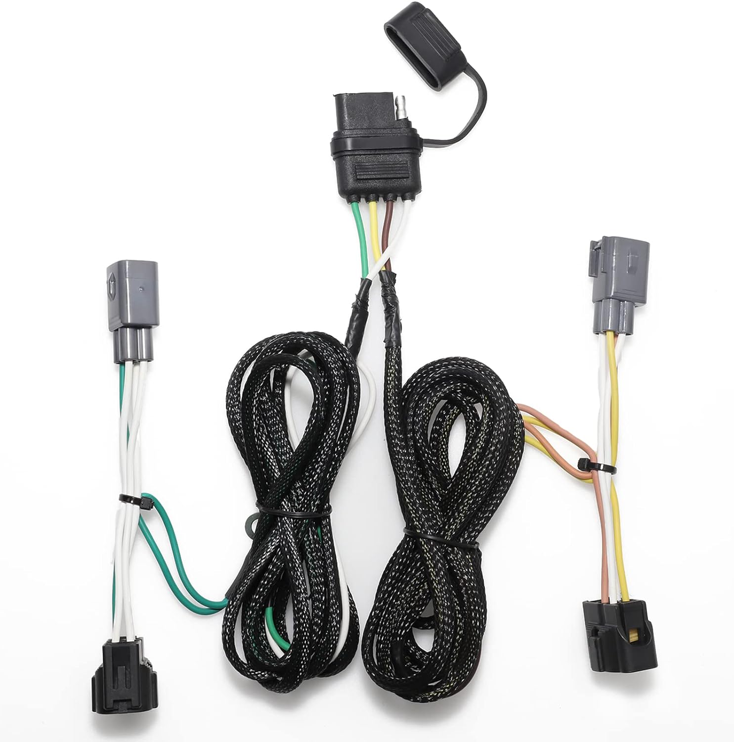

Flat Trailer Wiring Harness - $26.99
I didn't want to cut my Jeep wiring harness to install the brake lights, so I bought this trailer wiring harness that is plug and play. It will get cut instead of the Jeep.

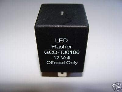

GCD Fits Jeep® 2001-2006 TJ Wrangler LED Flasher Relay - $28
This is required in order to use LEDs in a TJ. You replace the flasher in your steering column with this. If you don't replace the stock flasher, your LEDs will not blink or work correctly.

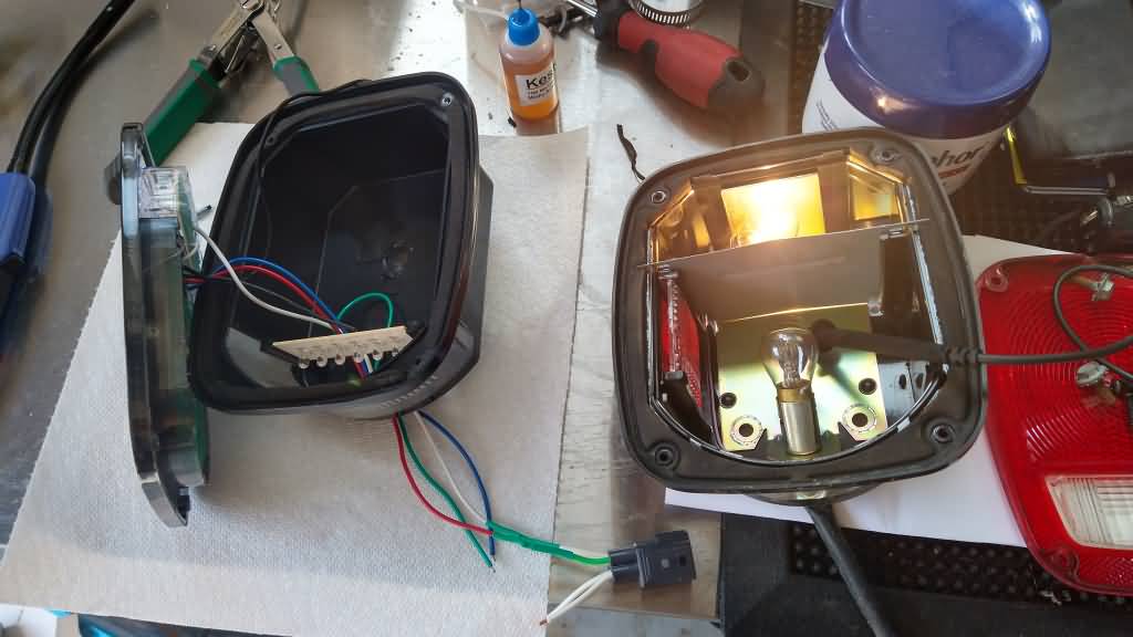

I started by wiring up the brake lights to my bench power supply. AliExpress didn't send any instructions, so figuring out what wire did what was a bit of trial and error.
You can see in this photo where I cut the trailer wiring harness and wired it to the lights. I soldered and used heat shrink tube for everything.
![IMG_20230826_151524527_HDR-jeep-led-lights.jpg IMG_20230826_151524527_HDR-jeep-led-lights.jpg](https://www.jeepz.com/forum/data/attachments/29/29008-aae0854055ab85f64a56f74a57d88f3b.jpg)

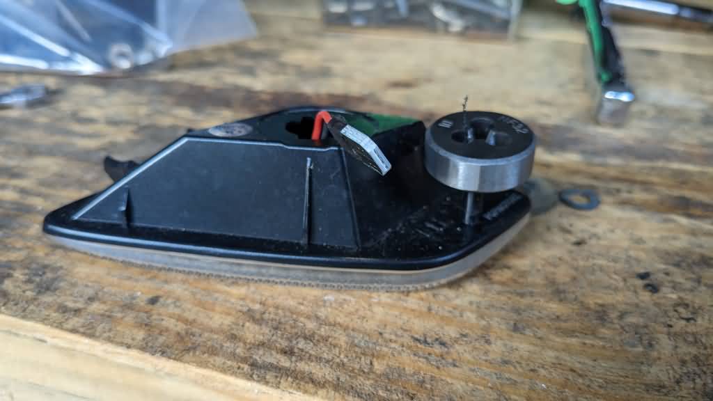

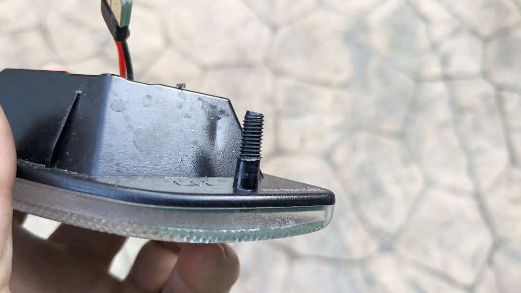

The only other thing that gave me pause, was the side markers. They came with a smooth stud that the stock nut wouldn't screw onto. I used my tap and die kit to cut threads into the light, then used a nut from home depot to hold it on.
![PXL_20231013_213738520-jeep-led-lights.jpg PXL_20231013_213738520-jeep-led-lights.jpg](https://www.jeepz.com/forum/data/attachments/29/29009-66efa2400b477b9bf1cbe8c36542eb8c.jpg)
![PXL_20231013_213952787-jeep-led-lights.jpg PXL_20231013_213952787-jeep-led-lights.jpg](https://www.jeepz.com/forum/data/attachments/29/29010-7a7f287bb01bdf1014788d4b83e2b4d2.jpg)
A note on LED flashers vs load resistors.
I originally purchased a "load resistor". This is an option when going from traditional lights to LEDs. They draw enough current to fool the stock flasher into working. They do indeed work, but what I found, is that they convert this power into heat. So much head that they will burn you if you touched them. I originally mounted them inside of my brake lights, and they were waaayyy to hot. I have no doubt that they would have melted the plastic housings. In my opinion, the LED flasher is a much better solution, and only $20 more.

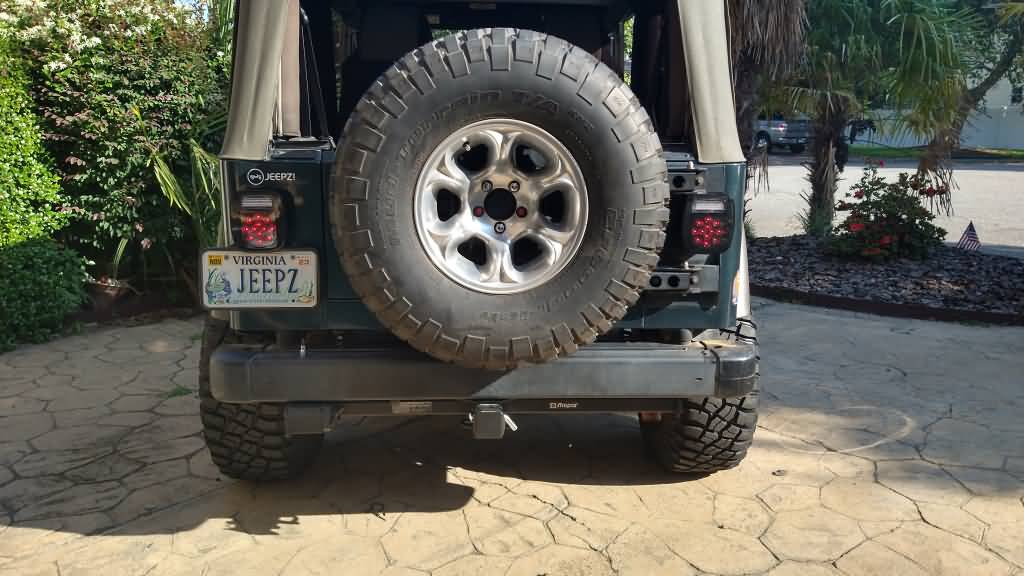

When all is said and done, here is how things look:
![PXL_20231013_221805362-jeep-led-lights.jpg PXL_20231013_221805362-jeep-led-lights.jpg](https://www.jeepz.com/forum/data/attachments/29/29011-a3d053e53098d57d7ac2c0321f9a2488.jpg)
Brake lights on
![IMG_20230826_171109686_HDR-jeep-led-lights.jpg IMG_20230826_171109686_HDR-jeep-led-lights.jpg](https://www.jeepz.com/forum/data/attachments/29/29013-a7e78dc3fe8f5486fb32d398bb70602a.jpg)
