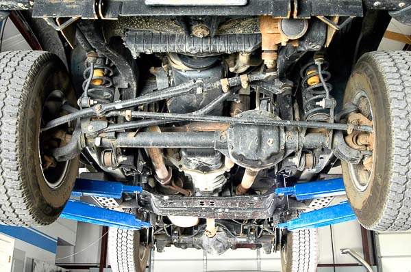

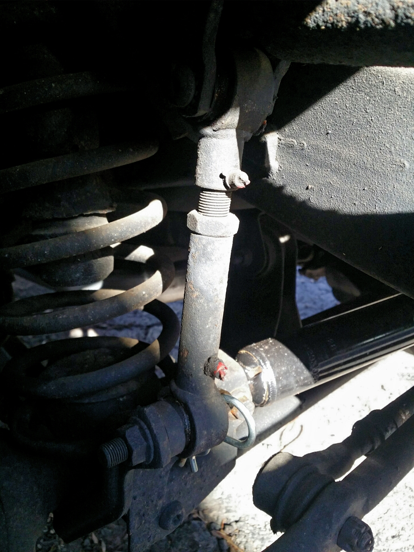

Heres a pic of steering box and some steering components, wondering if theyre all stock or modified. No extra lines on box just 2 i assume thats stock.

The other image shows mostly stock components. The drag link, tre, control arms.. The track bar is not relocated but can't tell if it is stock. The sway bar connectors are JKS quick disconnects and not a bad thing. I cannot speak to the health of the components from a still picture but could say the grease boots are not damaged.

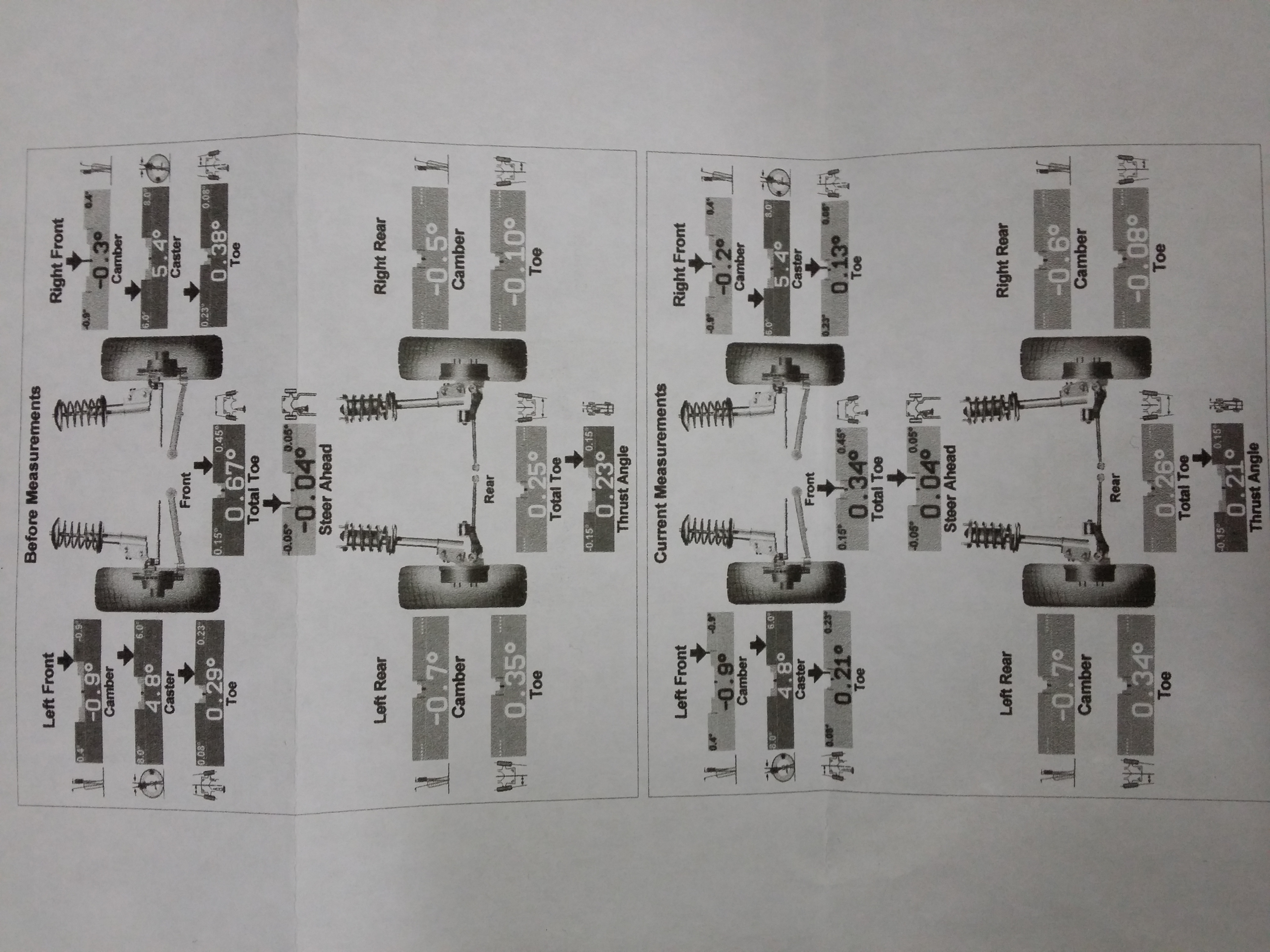

They finally sent me the specs, above is what it was originally on 33s, below is on 31s. Theres a note on bottom that somethings not within specs. Not sure how this will help since we dont know what specs for lift should be....20151222_222454.jpg
Stock caster angle should be closer to 7 deg. The closer to zero the easier it becomes to turn. With 33+ tires you would want to be around 5. I'd like a picture like I posted showing all the components. Specifically the control arms, pitman arm and how the drag link and track bar lignite up.
They have caster as in spec but they can change specs by overwriting them on the screen. Cast is mainly controlled by the control arm lengths. However with modified vehicles owners may be welding parts closer to where they need them without changing control arm lengths much.

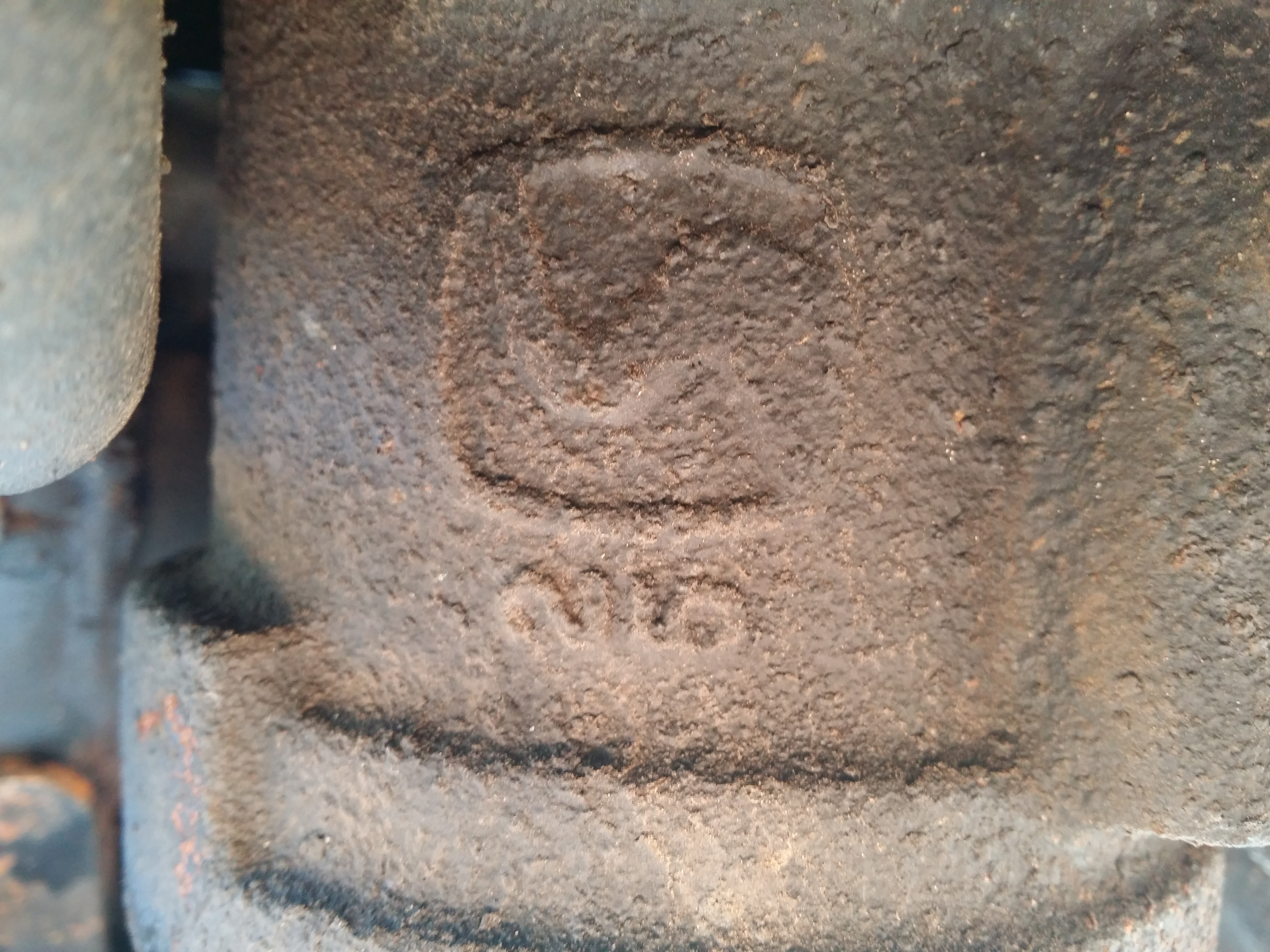

I'll check for a shop, btw the way heres jeep dealer response about steering box which had a small number on cap of 5689010.
"The part number you provided is a General Motors part number. From this information it appears that somebody retrofitted GM parts onto your Jeep Vehicle. Because of this, the gear is most likely not of the same ratio/operation as the original Jeep part that was designed for your vehicle. "
Am i onto something here or unlikely?
