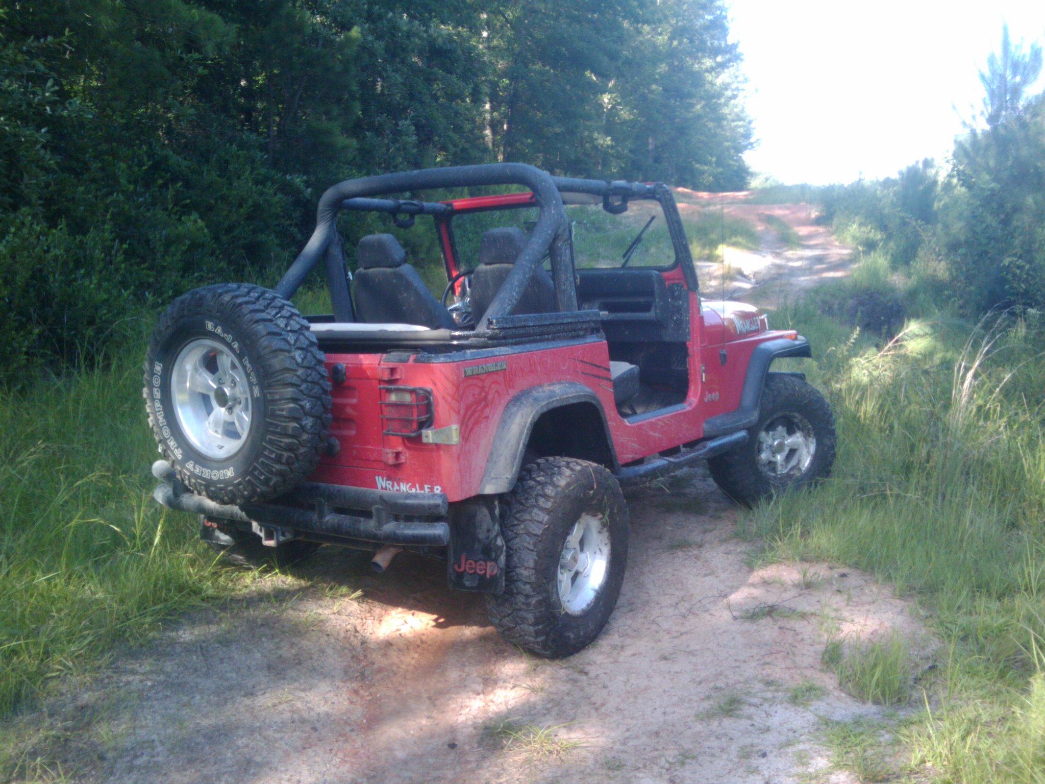

The picture below is from riding around today.
