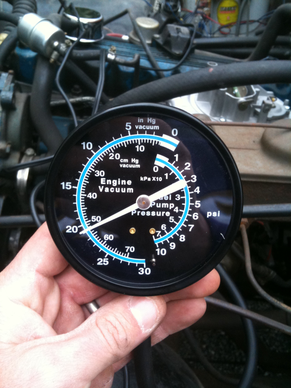

Whoa!! Got a vacuum reading. Approx 20.5 at idle. Still need to time it though

S your distributor hooked up to ported or manifold vacuum? I am hooked to porter because when I hooked up to manifold vacuum, my timing jumped so far advancedthat I was afraid it would knock going up the on ramp

I'll check the potted vacuum. I only hooked that up quickly to make sure the gauge was working cause I couldn't find a manifold vacuum to save my life. Finally found one.

i found out why my vacuum is pretty low. when this engine was stroked, the block wasn;t milled to adjust for the new crank and rods so the pistons are a fair amount below the deck height. that explains why it felt like a dog so much
