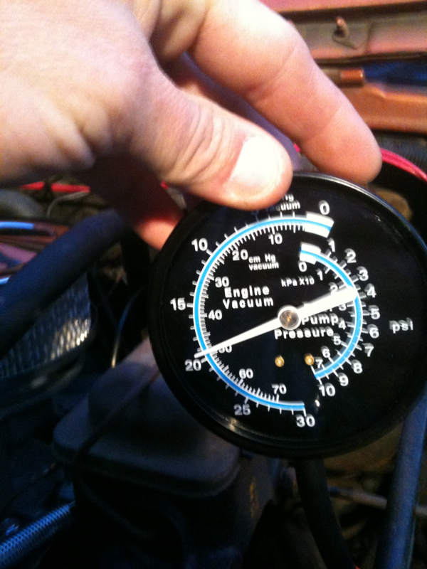

Current vac is 19.5. My mixture screws are out now about 4 1/4 full turns. Sound right?
Hay Bryan. I was wondering about that -8 also. From zero at tdc with the light on it your timing should be moving towards the passenger side as you advance it. You follow me?
Ok. Yes. Sorry bout the (-). That is how it goes, towards the passenger side. When I shine my light my mark is on the 6th mark. That should be 8
Maybe your timing is advancing a hair quick? The guys I keep talking to on jeep forums said if you get it good except for a bit of hesitation or pinging under lOad, then may e the vacuum advance cannister is advancing to quickly. To adjust, you put a tiny Allen wrench I the spot where the hose hooks to distributor and turn it one turn out or in, which ever way makes your trouble get less.
Did you ever see what size jets you have in your carb? Didn't someone say it should be 47s? 48 will make it hesitant too?
Yea I have 48's. For some reason I fell as though 4 1/2 full turn out on mixture is way to rich. This is my next learning curve I quess. Don't worry, when I get this down, I have plenty more threads to start.

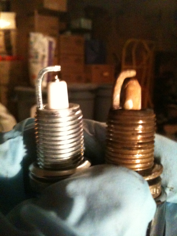

Looks nice. Bet that will keep you a little dryer. Carb is giving me a headache. And I think im from exhaust fumes. Get this. I am still tinkering with the Fuel mixture screws and she just shut off. She was idling fine and just stopped. Screws are at 2 1/4 turns out. Man I'm glad I am not a mechanic. I would have jumped off a cliff by now.
Won't start. I pulled plug one to see what it looked like. Left one is new. Right one was just in there. Yuk
