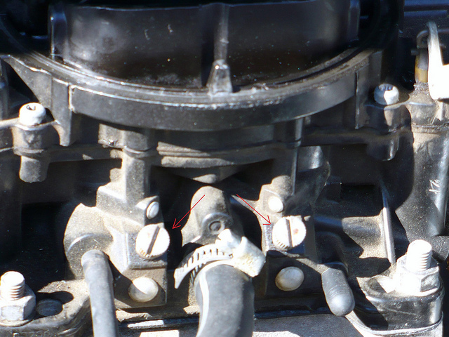

I think I have a carb problem. I have an amc 360, eldebrock intake mani, and eldebrock carb 4bbl. This has all been recently set up and I'm running into problems with the carb(I think, I'm not really sure). What is happening is that I can only push down on the gas pedal half way before it starts back firing and what seems like flooding. Which I think is odd because it font think it is tuned too rich, I have each seat tuned to 2.25 turns.

'Betty' my '78 CJ5 had a 'Carter AFB' clone Edelbrock when I first got her. I had similar problems but, like the AFB, the screws in front are not mixture screws, rather they're secondary air bleed screws. To change the mixture you'll needs a 'jet kit' that comes with metering rods, springs and jets. Using the correct spring, rod, and jet will yield better carburateion. A chart is available on the Edelbrock website to help detirmine the combination nesessary, but after I replaced that clone with my old 'real' AFB, I went a little leaner and it hasn't had any problems since. Good luck.

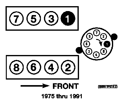

Well, I'm not really sure where 8th cylinder firing point is on this distributor because it doesn't match the diagram I have. Ofcourse my diagram is of a amc 304 but I'm not really sure if the hei will match to the distributor in the diagram. Do you know if it does? Can you show me where your 8 is on your hei?
pull your number one plug and put your thumb over the plug hole. rotate the engine until the copmression in the cylinder pushes your thumb off the spark plug hole. open your distributor cap. the way the rotor is pointing is number one. from there, put the wires on in the order the book says and your good.

Get a black marker handy. With #1 at top dead center, remove your distributor cap and mark the location of the rotor tip to the distributor cap. That mark should point to the #1 spark plug wire. #1 cylinder is on the driver side front and #8 is on the passenger side rear. I have oriented my HEI vacuum advance facing the radiator to give me enough room for timing adjustments. Here's a diagram i got from a site.
Firing Order AMC 360cid : 1-8-4-3-6-5-7-2
Distributor Rotation : Clockwise
Drivers Side cylinder numbering (front to back) : 1 3 5 7
Passenger Side cylinders numbering (front to back) : 2 4 6 8

I remembered where one of the wires were and I just worked from there. I'm back to square one. I have the deep gurgling and back firing when I press more than 1/2 way down on the gas. Also now I have a new symptom, the engine when wide open quits at 4 rpm and sometimes pick up around 1 rpm but when I step on the gas again it completely quits.
