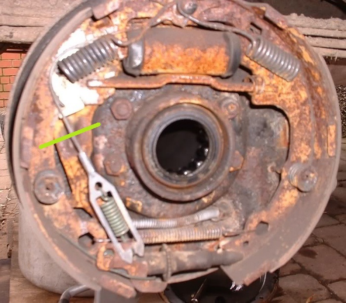

One thing I should mention that could be a factor here is that when I took off both drums there was the same piece broken in each one...the odd cable part that hooks onto the thick top anchor point where the top two shoe springs attach, does a 90 deg turn around another piece to the side then continues down to hook into the odd J looking piece close to the bottom adjustment wheel. I think this part has something to do with the emergency brake but I'm not entirely sure. The green line in pic below shows where each of these pieces/cables were broken. The pic isn't of my brakes, just one I pulled off the net.
