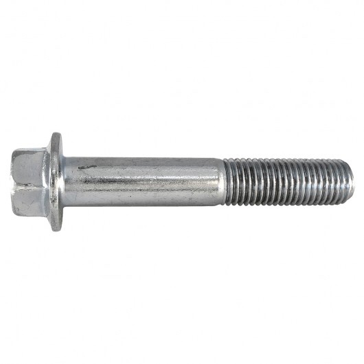

New JKS front track bar
New grade 8 tight fitting axel side bolt.

New axel side tight fitting link bolts metric M12 1.75 thread i believe.

Number of new tight fitting bolts.
Shocks and track bar grade 8 metric 12m 1.75 thread. I believe.

Need to go back and trim some bolts cause i made sure the bushings ride mostly on the bolt shaft and not threads. Little to no slop.
