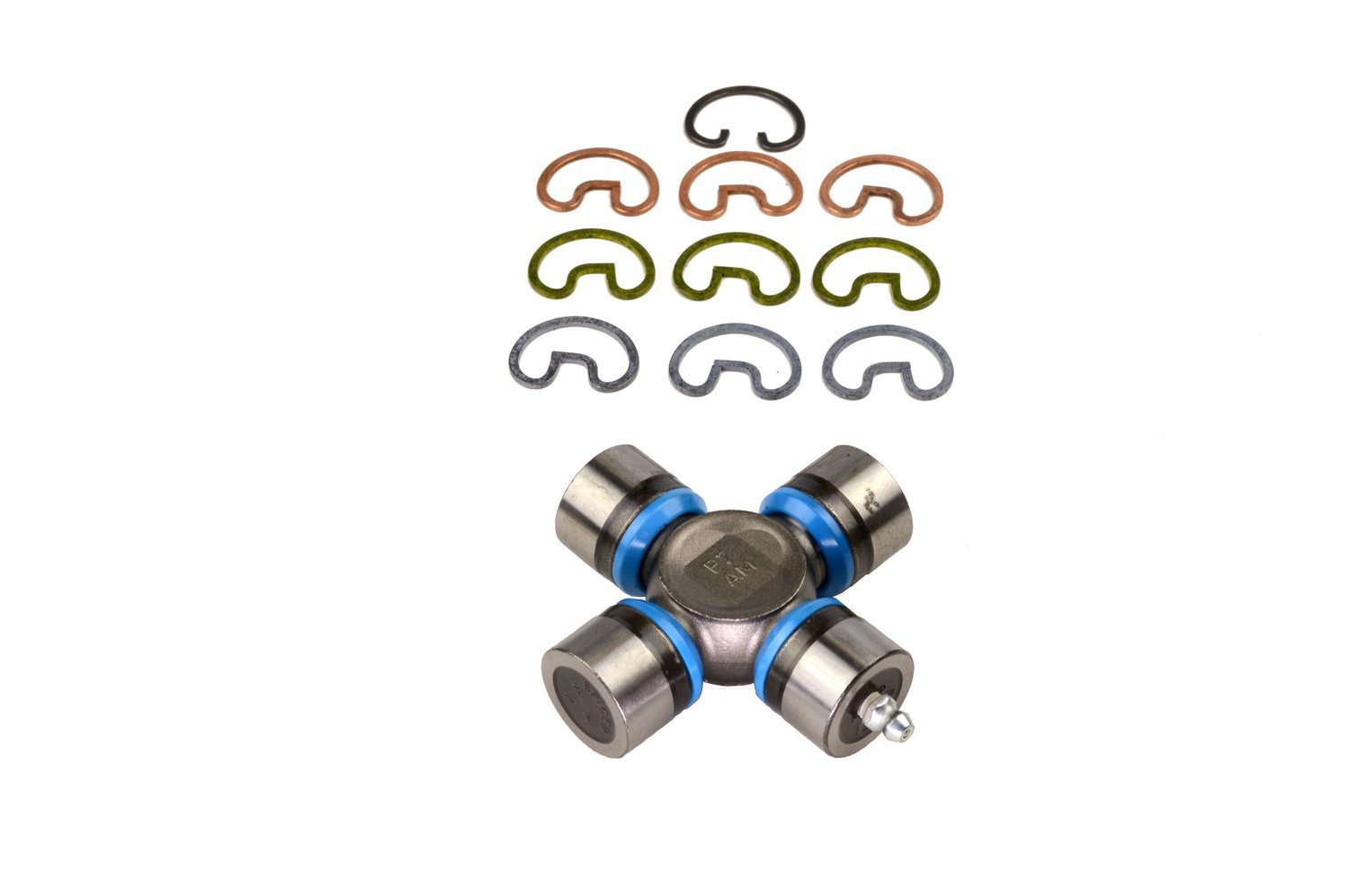

The angry sparrows are back, so I ordered some Spicer 5-1310-1X U-Joints for my rear driveshaft. I like that these can be easily greased, instead of the traditional kind that have the nipple on the cross.

View attachment 23523Spicer 5-1310-1X U-Joint
I watched a video explaining D30, D44 and D60 axels. He covered a lot more in the vid. One was mentioning joints that don't use needle bearings. Not sure what the advantage is or where they use them but something to look into.
Second is this one you had replaced before and have you been greasing them.? If so you got to ask why this failing. If it's one never changed before... Well maybe it was time. Spicer offers joint packs that has all the joints for your vehicle. Not sure if they are the greasy kebab ones.
I previously had problems with the front driveshaft - I built it with non greasable ujoints, and those wore out so I used these greasable ones. This time around it's the rear shaft (I believe). My rear shaft is actually a cut down cherokee front shaft, so it's got a cardian joint in it, and I run a SYE.
Having said that, I have not been greasing the joints the way I should. I may roll around with the grease gun and lube everything up next week.
