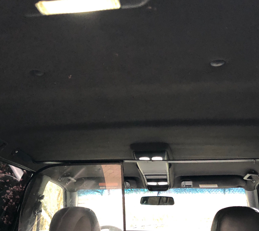

Changed the interior lights out with LEDs
I hated that ugly orange / yellowish light the factory halogen bulbs give, these LEDs gives a nice white light without being too bright either.
Also considering the previous owner installed an ugly bright blue LED light in the back...this is a huge improvement.
And it looks like I also managed to take a crappy blurry picture of it at the same time

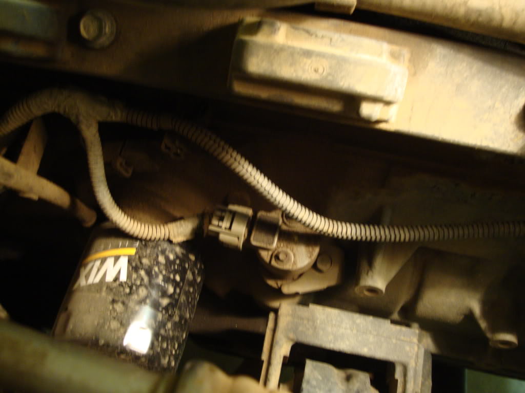

Installed new camshaft position sensor and a crankshaft position sensor (second one since March). I sure hope this fixes my problem. Only thing left is the wiring I guess.
Were those difficult? I've never done either myself.
Camshaft position sensor was very easy. It's on the side of the engine right next to the oil filter. Two screws and the wiring connector and that's it. I know some jeeps, older ones I think, have it inside the distributor. Looks a little more complicated from the youtube videos but not too bad. The crankshaft position sensor is on top of the bellhousing on the drivers side. My shop replaced this under warranty so don't know how difficult it is but just looking at it, it looks pretty tight.
What is the issue?
Since I had the new engine installed last year I've had periodic trouble with a rough idle. Barely noticeable but there. Every once in a long while it would die. It would start right back up though with no problem. The last few months it has gotten worse. It just died on me driving home one day. Waited 20 minutes and it started and drove it home. Took to shop and they replaced the crankcase position sensor. All was good for a few months and then it did it again. Died on me twice before I could get it home. Checked the code myself and again said crankcase or camshaft sensor. I replaced the camshaft sensor with a mopar part and hoped it was fixed. That weekend it did it again twice. Back to the shop and they think it was a bad crankshaft position sensor. They replaced it with a mopar part and called it fixed. We'll see.
