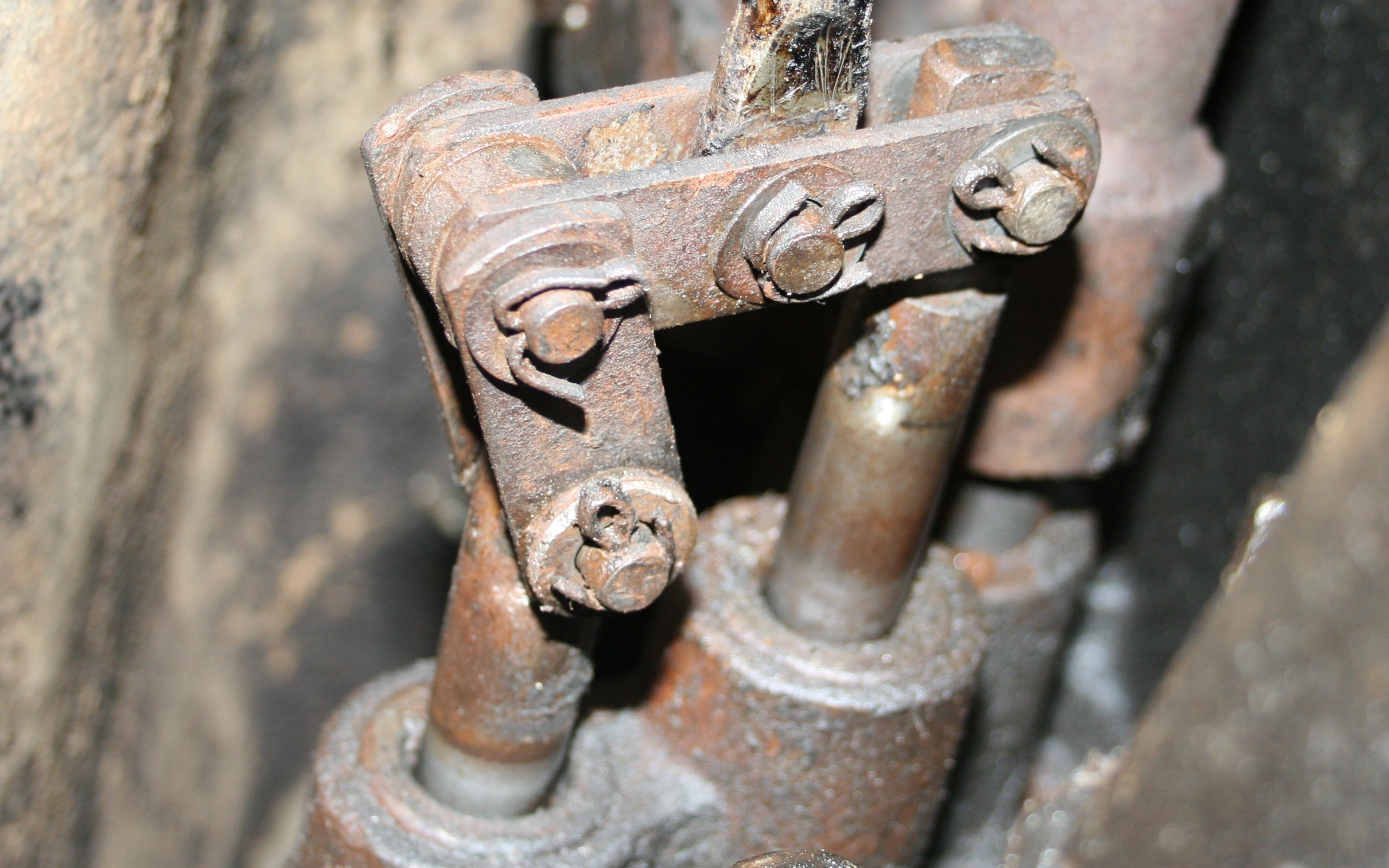

trying to attach a photo, hope it worked. cant see any mud in way. seems to be a linkage issue and dont see way to adjust. worried it could be problem w transfer case.

I guess no one is interested. My issue is the linkage on the left wont move, the one on the right does(i know it controls the rear axle) In the photo i forced the linkage on the left forward which is 4w high(front axle). And it works when I drive it. You can see by the clean metal exposed. it will shift easily back to neutral but not any further back then that. And my next question is isnt it supposed to move back to get to 4x4 low (for the front axle)?

I'm not that familiar with the Dana 20 t.case but it doesn't look too much different on the shift rods compared to my dana 300. If the shift forks move manually without using the shifter, then i would assume that the t.case is sound. I would look into the linkages on the shifter and see if there's too much play especially with the linkage on the left . On my Dana 300, i had an issue shifting to 4 low. It ended up to be a worn shifter pivot shaft.
thanks for your reply. I am leaning that way. my only question is; how many places is the shift rod on the left (front axle) supposed to shift to,because I can only get it to move into two positions (which I assume is 4x4 high and neutral for the front axle off-course) I am concerned it is supposed shift toward the rear past neutral to a 4x4 low???. the shift rod on the right moves into all four positions with no problem.

I think there's 3 detent grooves on each one of the shift rods attached to the shift forks. Positioning both at the middle should give you a neutral on both front and rear. Positioning either one of them all the way in or out will give you either front or rear engament in low or hi. jack up the front and rear and slowly turn the driveline as you shift the t.case.
I sorta did that by getting them both all the way forward and the front drive axle spun when wife pulled forward while I watched the front axle( wont spin when jeep is only in 2 H) so I know that 4x4High works (thats w me forcing that shift rod forward) it wont however go back past neutral to 4x4 low (only the driver side shift rod will). I cant force that shift rod back so am thinking this might be a busted transfer case???
It's possible. If it's got a pan under the T.case like the dana 300, you can pull that off and do a quick inspection and assesment of the shift forks and gears. That would be my best advise at this point.
