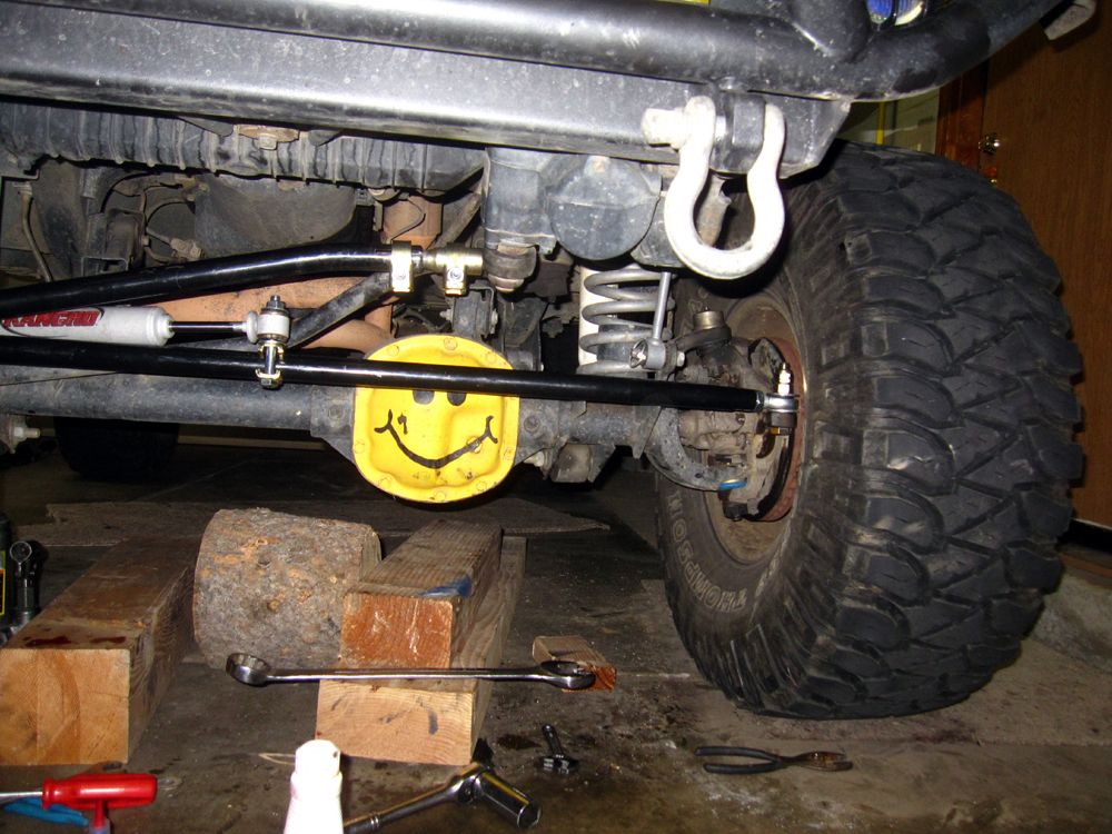

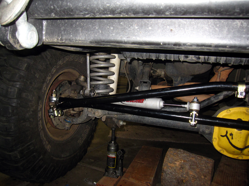

For the inverted 'Y' style (stock), that you have now, Currie Currectlync is probably the most popular, personaly I think its ok, just a beefier version of the stock setup. I wouldnt reccomend the Savvy upgrade for it for the same reason the ZJ upgrade with a beefier tie rod isnt a good idea, with a super strong tie rod and a stock drag link, your asking for trouble, same thing with the Savvy upgrade to Currie, if the tie rod cant flex or bend, the drag link must bend, and the tie rod was way easier to bend back and get off the trail than a drag link.
there are several full cross over systems, like the one OTPJeep has, ORO U-Turn makes a good system, its about $600, but very well designed and trail worthy.
There is also the inverted 'T' systems, like Rugged Ridge and a few others, very affordable, but people will go on and on about ackerman angles, I have to guess they are rock crawling at 40 mph.
