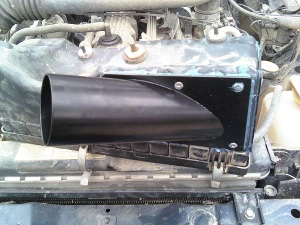

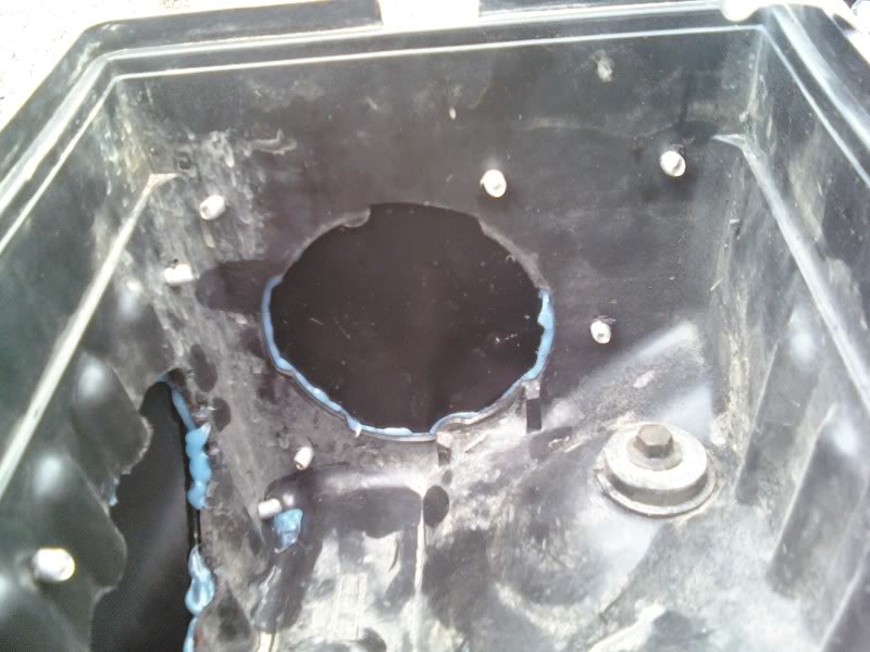

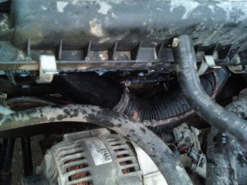

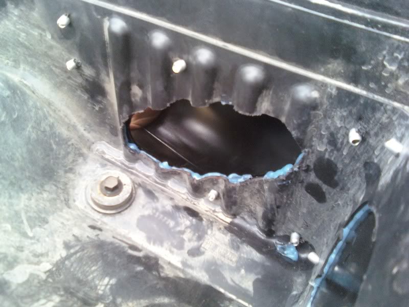

#'s 1, 2, 3, 4 & 6 are true (especially #6). #5 is a myth when it comes to the ARB Safari Snorkle... it utlizes the stock air box that you modify... "So easy even a caveman can do it!" I just did a snorkle on my Jeep. The hardest part is the 3" hole drilled into the side :cry:. No bugs yet... I suppose if you had a pre-filter net it would grab alot of garbage you suck up. OH, DON'T FORGET THE NICE SOUND IT PRODUCES... :shades: IT SURE DOES SUCK SOME AIR!

Hey Zach - got any photos?
Also, did your mileage / power change any? I imagine the engine would breathe easier, but you'd probably pickup some drag (if it's possible to decrease the aerodynamics of a Wrangler)
none of the Jeep yet just the steps

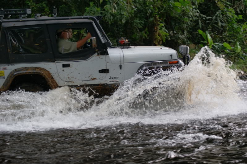

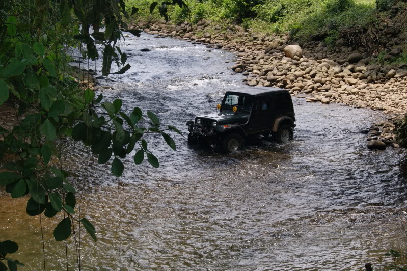

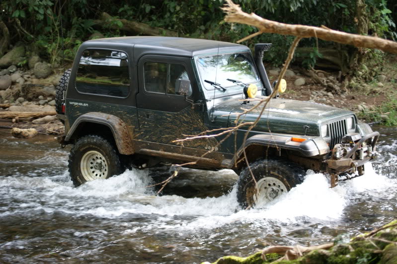

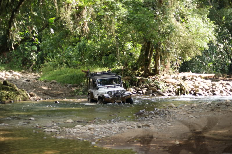

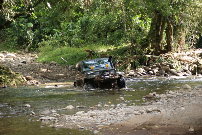

I also run the ARB Safari snorkel on my YJ. I also installed it myself in a few hours, with no adverse effects noticed (if enything, engine performance has improved).
Keep in mind, though, that just because you have a snorkel it does not mean your Jeep is a submarine; you still have to worry about getting the ignition or the ECU wet (ECU's can handle some water and are theoretically sealed, but submerge them often and water can find its way through cracks, and they WILL die). The big advantage, though, is that it's easier and cheaper to repair a damaged ignition than a hydrolocked engine, so that, to me, makes the investment worth it...
Felipe
PS: Here's something from my last wheeling trip for you to enjoy...

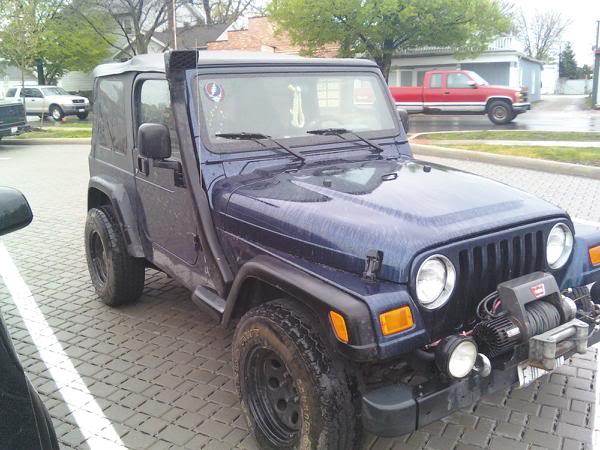

I bought the ARB Snorkel and yes its very scary drilling the 3inch hole in your quarter. but well worth it. It looks great and when you put the hammer down it sounds Great! but my question is...........................what about the water during driving in the rain? thats the only thing that makes me worried about mine while driving during all kinds of weather.
Well, getting 5 inches or more of rainfall in a month in Panama and Costa Rica is kind of ussual, and I have yet to have any issues. If you think about it, when it's raining cats and dogs, ussually you are NOT driving 65mph (it's more like 20mph, 'cause you can't see A THING!). Hence, the opening of the snorkel (which is slanted, by the way) is not exposed to that much water, and the snorkel is designed (at least the Safary one) to be able to route water out of the system. I have had mine for a couple of years and the driest place it's been in is Miami, FL. I have yet to have any water damage...
If you look at the head of the snorkel you'll notice it doesn't fit tightly around the down tube in some spots. This allows rain to be directed out of the tube instead of down... I'm still thinking on some kind of drain plug in case of water getting in there though.
