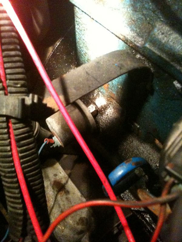

There is something mounted to the passenger side rear of the engine block. Don't know what it is but it has one wire that is connected to the wire harness. Y'all got a clue what it is. Here is a pic. It is the small cylinder under that wiring harness bracket.
