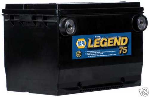

NAPA has got a legend 75 that is a very good battery i have one in my jeep that sets all winter long and it has a 18 month free replacement warranty and you can get it in top or side mount..
If You want the scoop on gel battaries check out the link that Phil sent, Thanks Phil! What I really need is a good starting battery as I don'r run a bunch of accessories, and I got a lot of great information and sources for different batteries.
