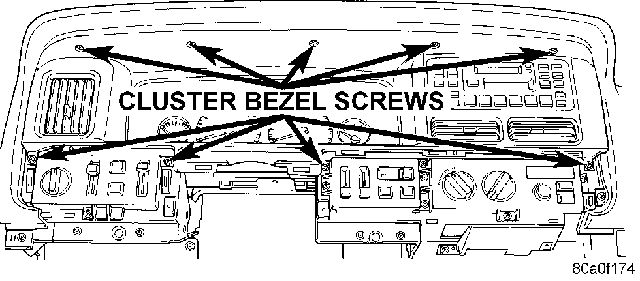

Hi everybody I'm new here and this is my first post, so hello. Has anybody had to replace a dash light on a JGC? I could use some help/ instructions. What is the best way to get at them?
Thanks
INSTRUMENT CLUSTER
[SIZE=+1]WARNING: ON VEHICLES EQUIPPED WITH AIRBAGS, Refer to PASSIVE RESTRAINT SYSTEMS BEFORE ATTEMPTING STEERING WHEEL, STEERING COLUMN, OR INSTRUMENT PANEL COMPONENT DIAGNOSIS OR SERVICE. FAILURE TO TAKE THE PROPER PRECAUTIONS COULD RESULT IN ACCIDENTAL AIRBAG DEPLOYMENT AND POSSIBLE PERSONAL INJURY. [/SIZE]
  1. Remove the cluster bezel as illustrated.
  2. Remove the two screws securing each end of the cluster to the instrument panel.
  3. Pull the cluster rearward and remove it from the vehicle.
  4. Reverse the removal procedures to install.
