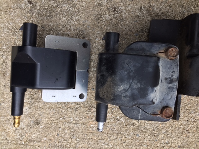

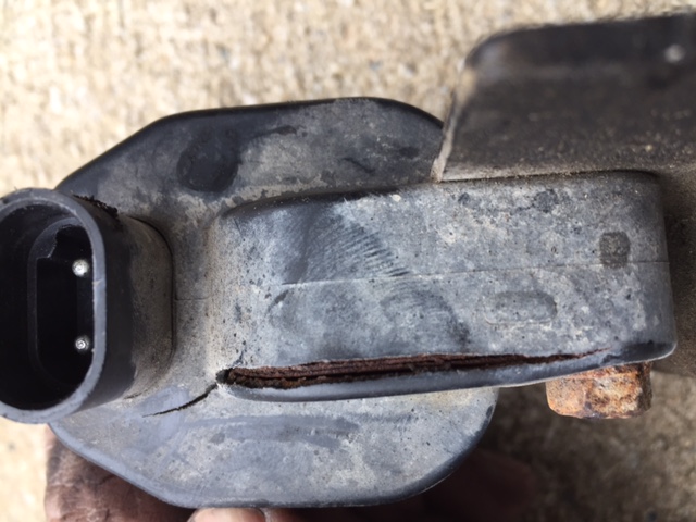

Per your direction, I went ahead and pulled the ignitioncoil. All the bolts were pretty rustyand I had to cut the ones from the old coil to the mounting bracket. I included some pictures also. Unfortunately, I also had to cut the groundwire from the alternator to get the one bracket screw out. Since that is a monster cable I have to hooka new connector and possibly replace some bolts to get this thing hooked backto normal. This may entail solderingthat connection.
Because my patience isn’t too good, I went ahead and hookedthings back up to see what would happen and plan to go back with new bolts andsuch once we solve this puzzle. So, I attemptedto start her up and pretty much had the same result.

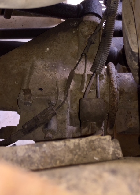

And additionally I found a loose open wire where the 4 wheel drive is engaged. Not sure if this could be one of the culprits?
Thanks again!

On the first picture post , the casing is clearly split and at the minimum , must have been arcing but what oil,is packed from the factory is long gone . Give it last rites and pitch it .
On the second picture post , that's the front axle shift motor . Won't have any bearing on the no start . When it's up and running , that'll be another project . Doesn't look functional as it sits .
Once the coil is bolted up and the wiring repaired , back to looking for a voltage signal from the harness plug with the newly acquired computer safe test light . Once that's sorted out , the NOID light will get a work out . Come on little YJ , you can do it ! There's always room for a Christmas miracle !

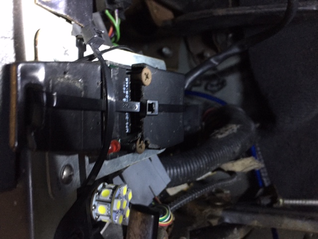

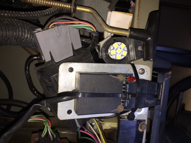

I wanted to mention (because this is my first jeep) when I purchased this rig from my uncle (he had it 7 years and had bought it from an auction) that was a bonus for me so I had a little history to go on.
He had changed the distributor, spark, plug, and wires less than a year ago because something came loose and sprayed oil all under the hood. He cleaned it up pretty good and as I mentioned it ran GREAT in the Carolina heat and cold. He had a slightly oversized battery also. I changed that out to what the manufacturer called for this past spring/summer. When I noticed it dragging (probably from sitting for 3 months) I took the battery back yesterday and got another one like he had with a longer standby and CCA.
One thing he mentioned was that when it rains, the check engine light may come on and when it dries out it will go off. This has been true. It still runs fine, but wanted to throw that out there. Its been dry now for a while so I don't have this issue. Also, he said to never "bump" the little computer under the dash. I included a picture. He said to never take the zip tie off or it wont run. When I called him recently about it, he asked if the fuse had worked its way out or not. It seems secure to me. I am guessing that most jeeps have a cover over this but all I know is if the little red light is on then its good to go.
I noticed when I put the new battery in yesterday the little red light was shining bright. The other thing is that I was attempting to "test" everything prior to securing the gas tank back in case I had made a mistake somewhere. It all appears to have fuel coming around the recommended psi and I am smelling fuel under the hood which I hope is a good sign. Or maybe its flooded? I read a post about somehow fuel got into the oil and that was preventing the start etc...

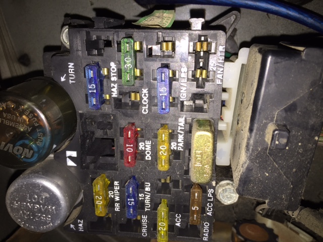

I cannot identify that " module " , I'll call it , or its purpose. I'll have to say it's an add - on since its zip tied and fastened with sheet metal screws . Can't find it on a FSM ( factory service manual ) . Curiously , we would be interested where it's wiring goes and connects . Ok , a oil pressure sending unit switch was replaced due to a major leak ( typical) and trashed the distributor ? That being replaced , the engine ran afterwards .

Before this however , please check and verify all fuses , under the hood and under the dash.
The ignition fuse under the dash ishould be checked . Don't remember was that for the cranking circuit , which works . Good to check ( ignition switch in ON position ) fuses on both terminals to ensure connectivity of voltage flowing from supply and into the circuit . Of one side reads good and other side dosen't , that will have to be investigated . I believe you already have a problem on the blower motor circuit , previously posted .

that looks like some kind of alarm. I don't remember anything like that on either of the yjs the wife and I had. that could be your trouble.
Trace the wires to the module. Could it be a remote starter? Being cracked it may be damaged causing the no start issue.
Just a thought.
