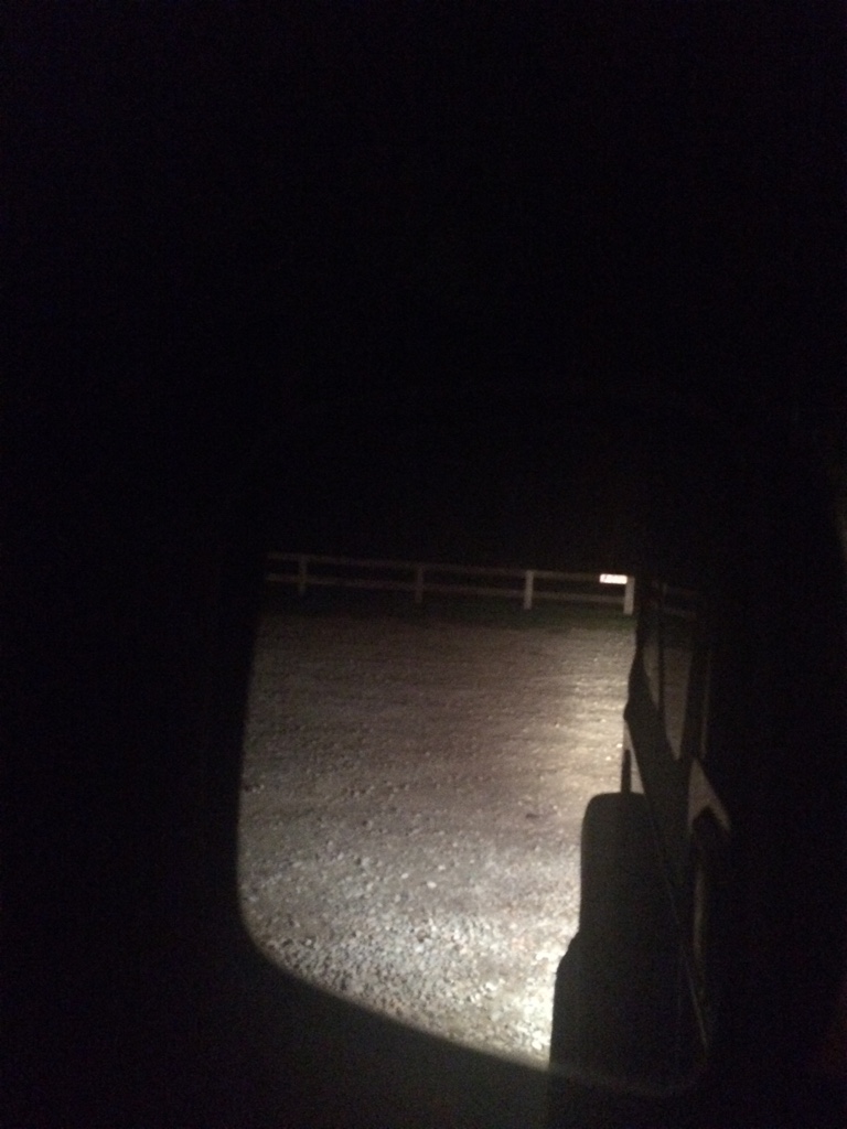

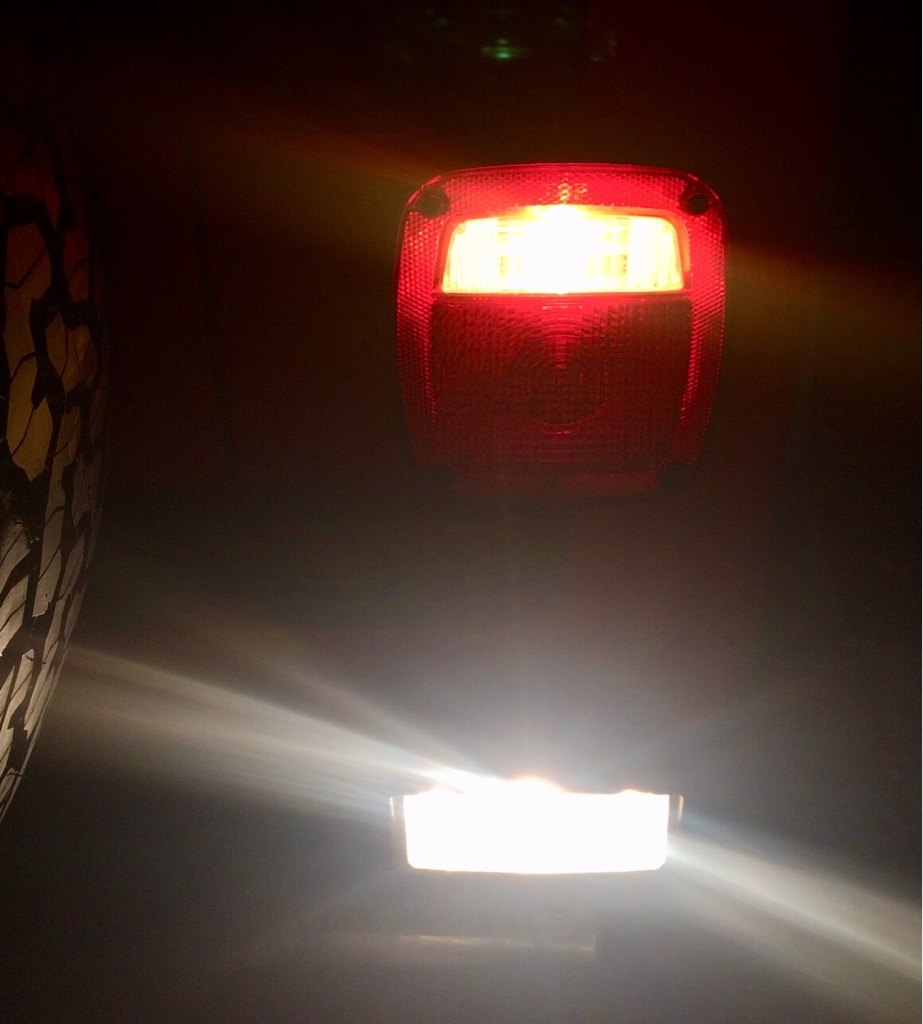

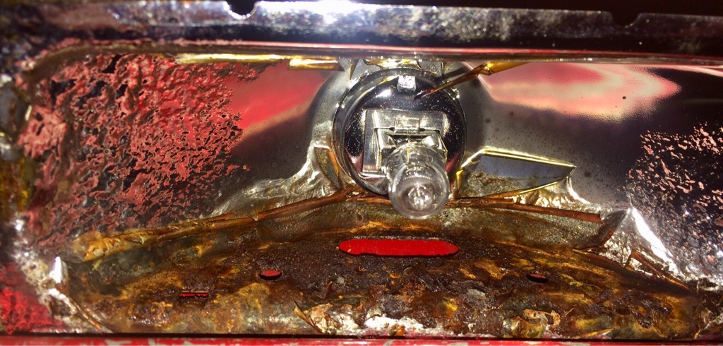

Rebuilt backup flood lights with new reflective shields and bulbs. Fixed a bad ground on the one. Added some silicone calk to potential leak points. Will be swapping original screws with Stainless or brass.

Thanks. If anyone else has these lights.
I siliconed only the top of the outer housing. The part that holds the lense in. I left the bottom alone for drainage. The lights were taking on water during rain showers just sitting in the driveway. I used thin film of silicone on the gasket to hold it in place. Also a small amount on the outside of grommet cause it seemed loose. I'm guessing the plastic changes shape over time in the sun and form leak points.

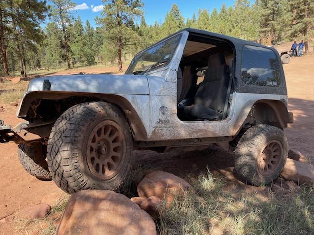

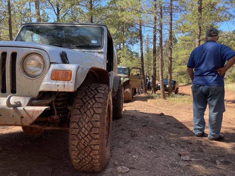

My son loves that wrangler we got him. He sent me tons of pics from Colorado and he is with the Colorado jeeps and 4x4 club out doing trails right now.
He said someone is having trouble on some stairs and mini Moab but his is making it without high centering or getting caught up.
Here is pics for you guys
Of course his is the silver one in the pics
