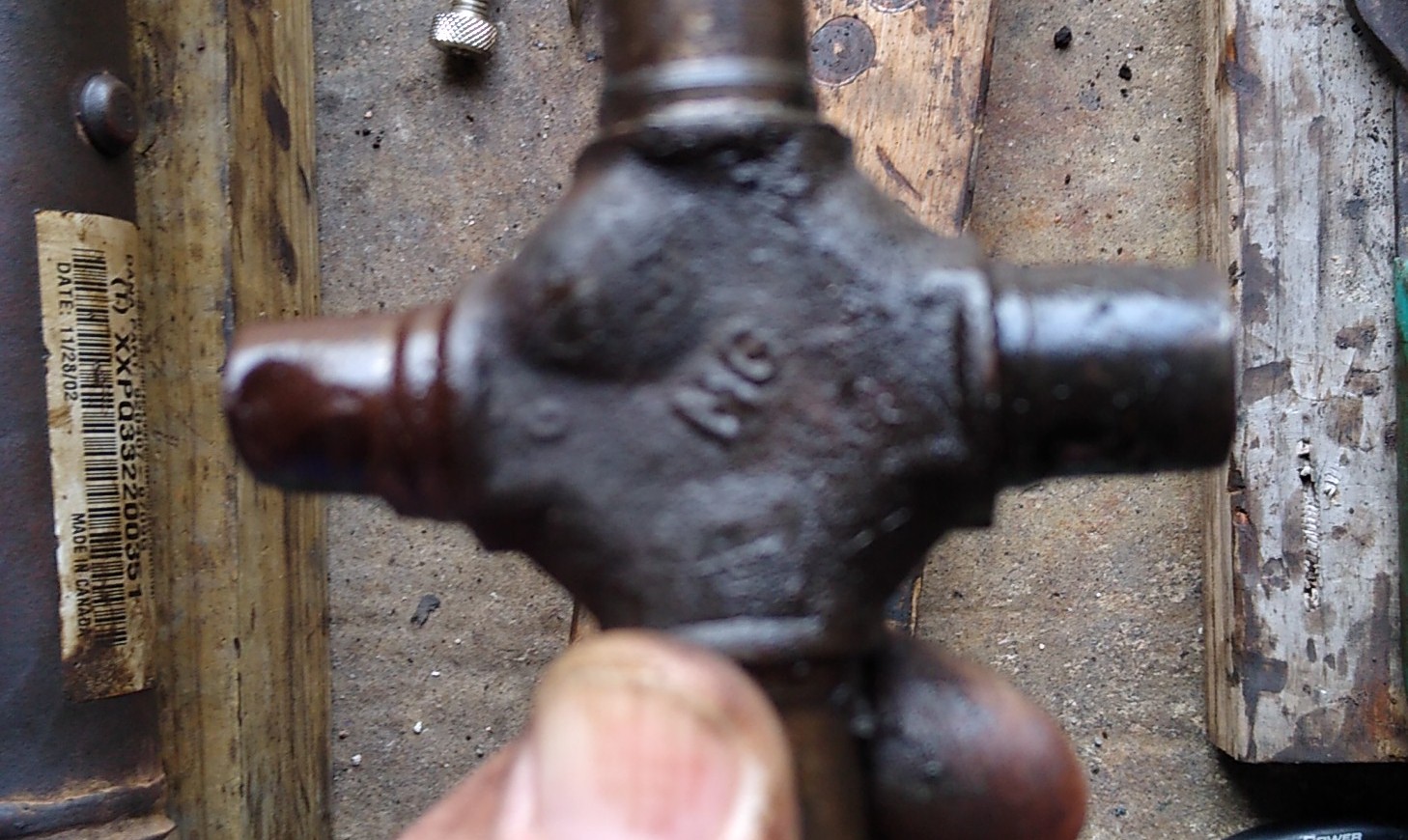

finally changed the u-joints. i need to remember to load the pictures so you guys can see how terrible the one was. i cannot believe it didn't until recently, the internal bearing races that are part of the center of the u-joint assembly were almost half way gone on one side and visibly worn away on the other side.
the old ones were moog and had no place to grease so that is what happened to them. the new ones are spicer and have zerk fittings and to grease like normal.
