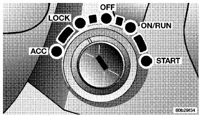

Do not turn the key to the "On" position but rather the unlocked "Off" position. You should not have anything illuminated on the instrument panel but the steering wheel will remain unlocked.

thanks for the info,but i don't understand the part about leaving the transmission in park. when you put the transfer case in neutral does this disconnect both axels from the transmission?
If the trans is not in Park, it allows the internal parts in the transmission to spin without proper lubrication, thus ruining your transmission.
Transfer case in neutral, auto trans in park and manual trans in 1st.
