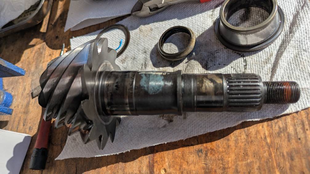

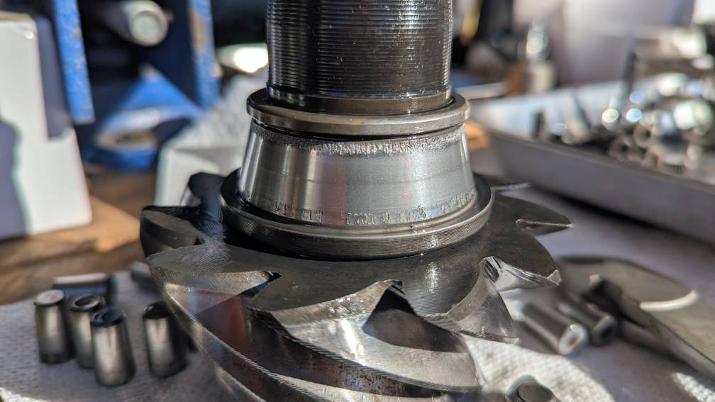

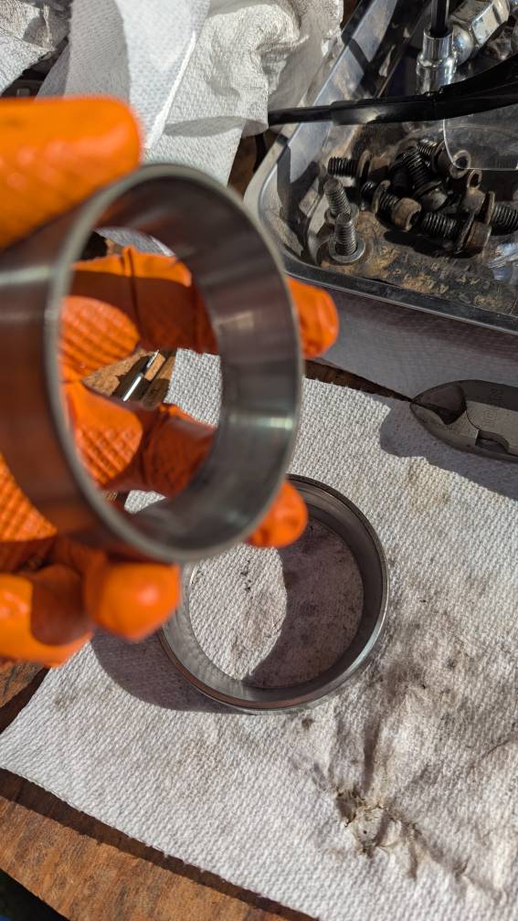

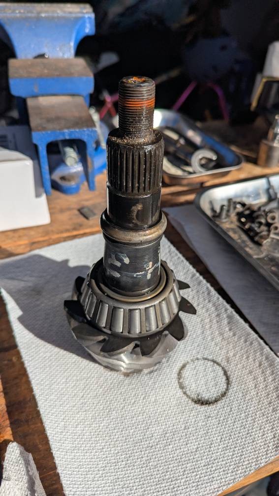

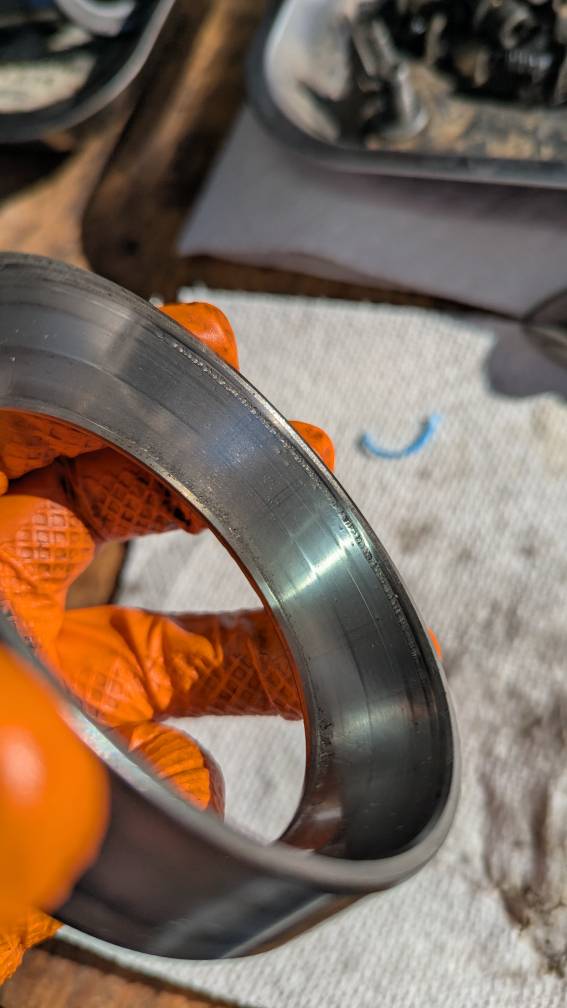

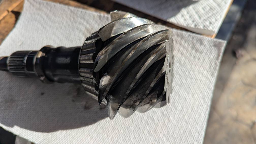

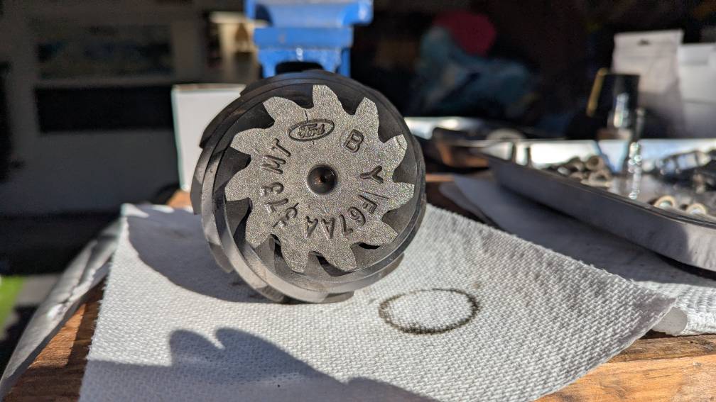

Is this pinion as bad as I think it is?

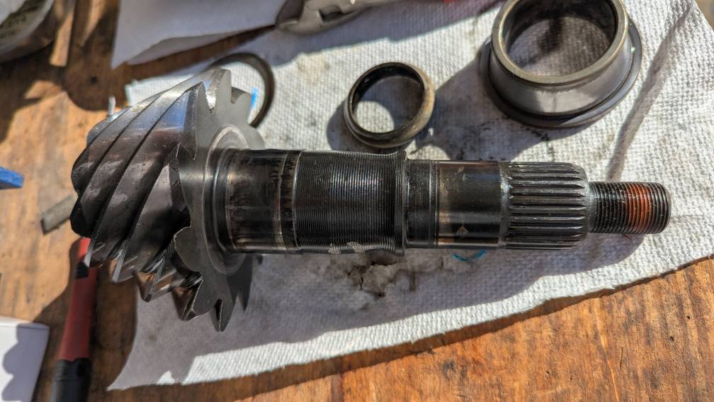

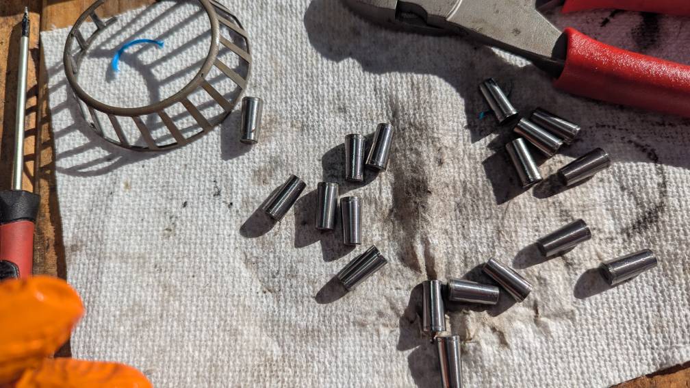

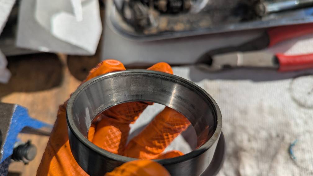

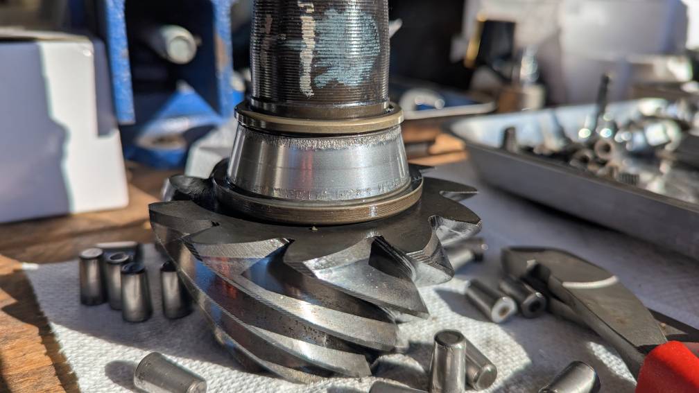

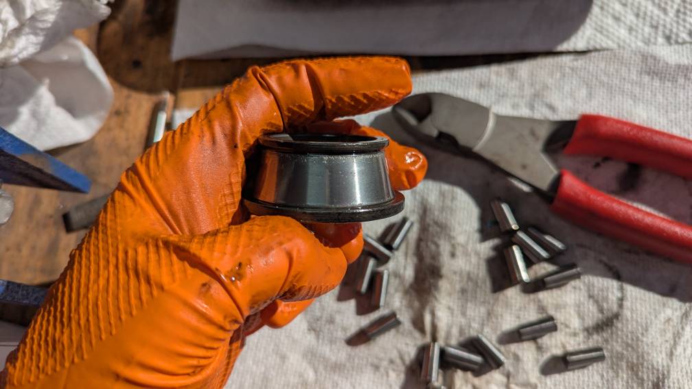

Okay got the opinion out. It didn't take much effort for my impact to pull off that pinion nut.
To my untrained eye, the pinion gear itself looks good but the bearing and races looks cooked
Sent from my Pixel 7 using Tapatalk
Yep. Thats your pinion opinion.

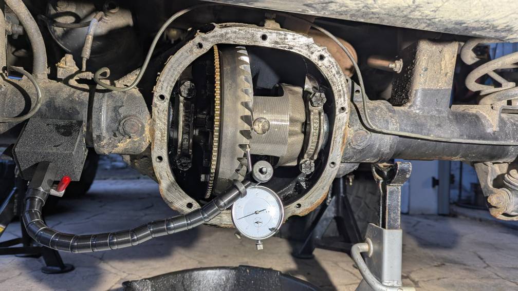

Things were going good today for a while, I had my backlash dialed into 10,000s and everything looked good. I decided to run a pattern before I buttoned everything up. From what I gather this is a pretty bad pattern. I applied way too much of the paint but the drive side looks pretty bad.
I'm not sure if I need to change the backlash by removing carrier shims or if I need to change the pinion shim. I'm open to any ideas.

I think I've got the carrier shims dialed in and I'm clocking about 9 thousands of backlash which is good.

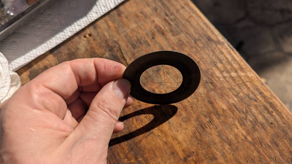

Pinion shim of 0.023 (this was the factory shim)
This much of a change ended up changing my backlash to about 0.05, and it should be between 8 and 12. I ran the patterns anyway just to see what they look like
