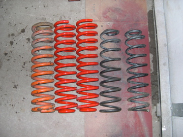

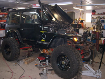

Here are a few pics
first is a comparison of coil springs;
Orange are 1979 F150 6" lift
Red are TJ 6" lift
Grey are TJ 4" soft ride
Second photo is how it sits today with 6" TJ rear coils, 6" 79 F150 coils in front.
