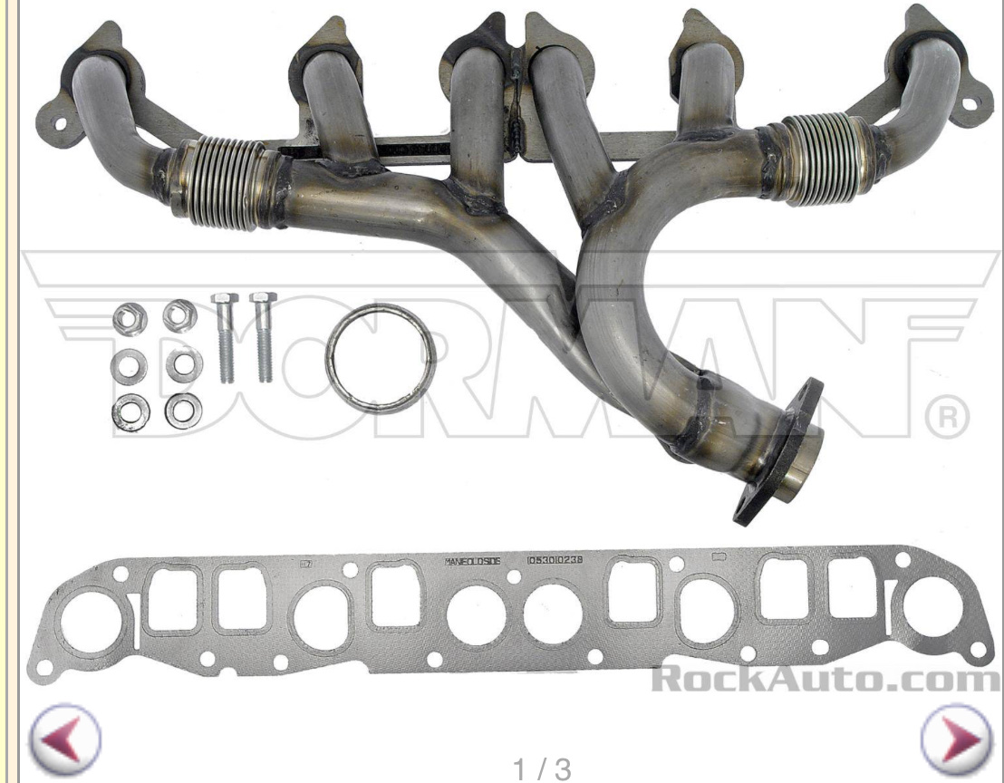

I do have a small exhaust leak right before the muffler. It's so far down the line that I wouldn't think it would cause any problems, but I wonder.

The 99 and earlier exhaust manifolds tend to crack on first or last cylinder
Replacementl like the below correct it. Is your miss a exhaust leak or an intake leak?

I don't mind changing the exhaust manifold, I've done it three times already. The mechanic who worked on it recently smoked the exhaust and the only leak that showed up was the one behind the muffler. If I can get my little smoke machine to work right I'm going to try and see if there are any leaks at the bottom of the intake.
Im not saying change your intake. I will always say prove out what is wrong before swapping. Im just saying the stock is known to crack.
