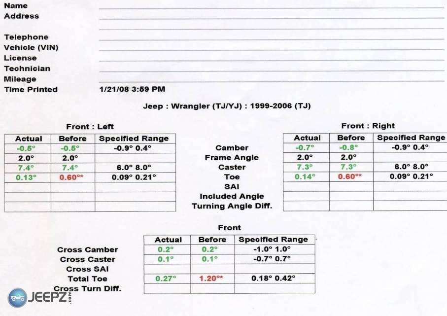

Your Jeep will have to be aligned (mine was off pretty bad after my 2.5" lift). The lift may also exacerbate existing problems (I had to change our my worn ball joints).
So, take it to be aligned. Ask them for a printout of the specs when you leave it with them. When you pick it up they'll give you something like this (after I installed a 2" spacer lift):
