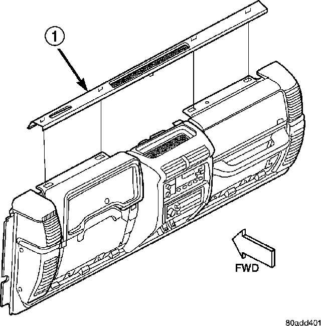

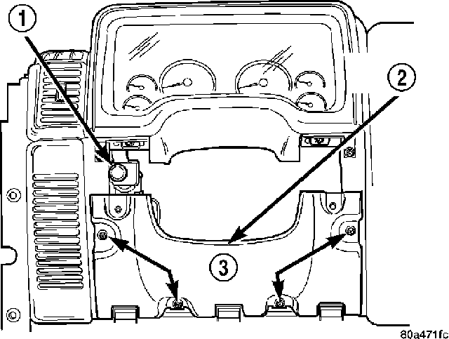

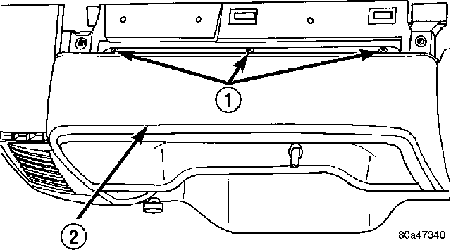

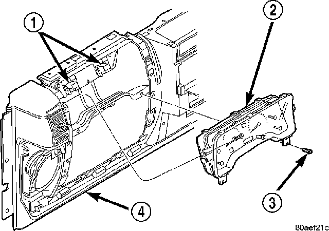

First , remove the top panel then the Knee blocker panel. remove the screws securing the instrument cluster bezel then remove the bezel. remove the 4 screws that holds the instrument cluster gauges then remove the Gauge cluster. Inspect the terminals for corrosion and pulled out connector pins.
