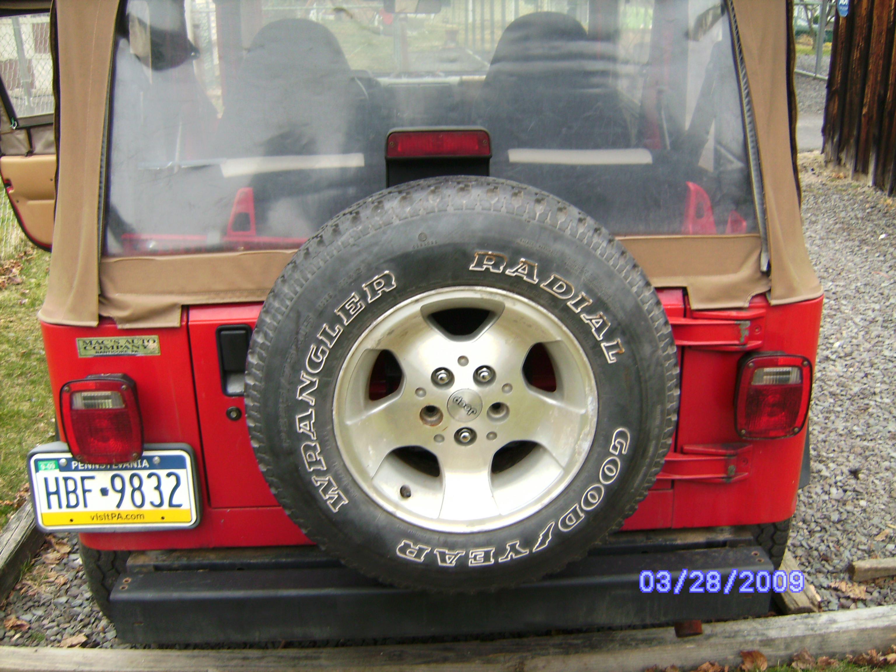

I noticed my spare was flat today.Thinking it was an easy thing to fix,take it off air it up and check for leaks,plug it if necessary.
Well this is where the problem started at.Tried to take the spare off,cant get the nut off that holds the spare to the bracket on the tailgate.
It looks like there is lug that was pressed into the mounting bracket.So it is completely flat on the inside of the mount.When I tried to take the nut off the whole stud just spun:x.I tried to use a pry bar to put pressure on it hoping it would grab enough to break the nut loose:x.Two people pulling on a ten foot piece of pipe and the silly thing was harder to turn but still spun.

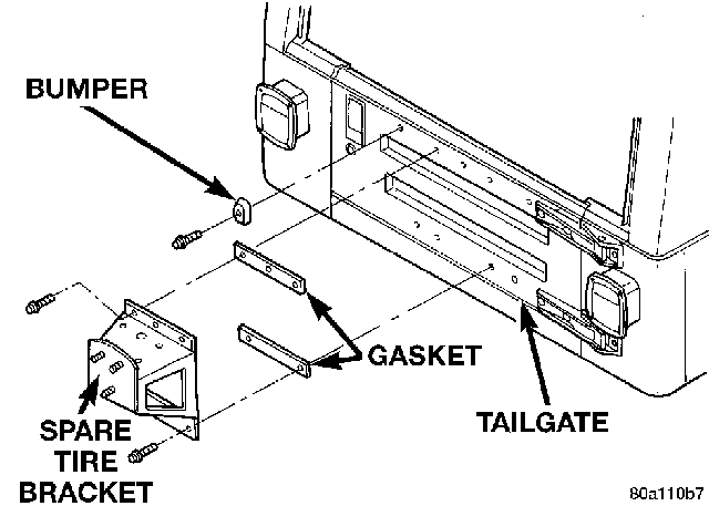

There are several suggestions to remove that spare off the bracket. to gain access to the lug bolt a little better is to remove the 4 bolts holding the bracket on the tail gate. If you have a Angle grinder, you can grind the head off the bolt. you can also use a cutting wheel to cut the top of the head in a cross cut pattern and use a chisel to remove it. also , if you have access to a welder, weld the bolt on the bracket and then remove the lug nut.

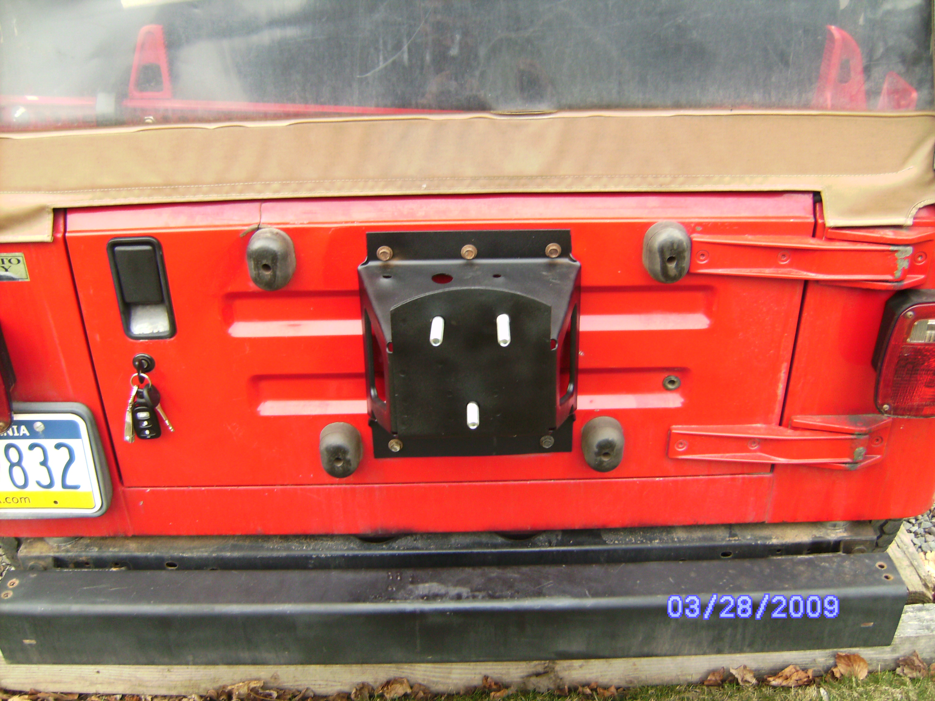

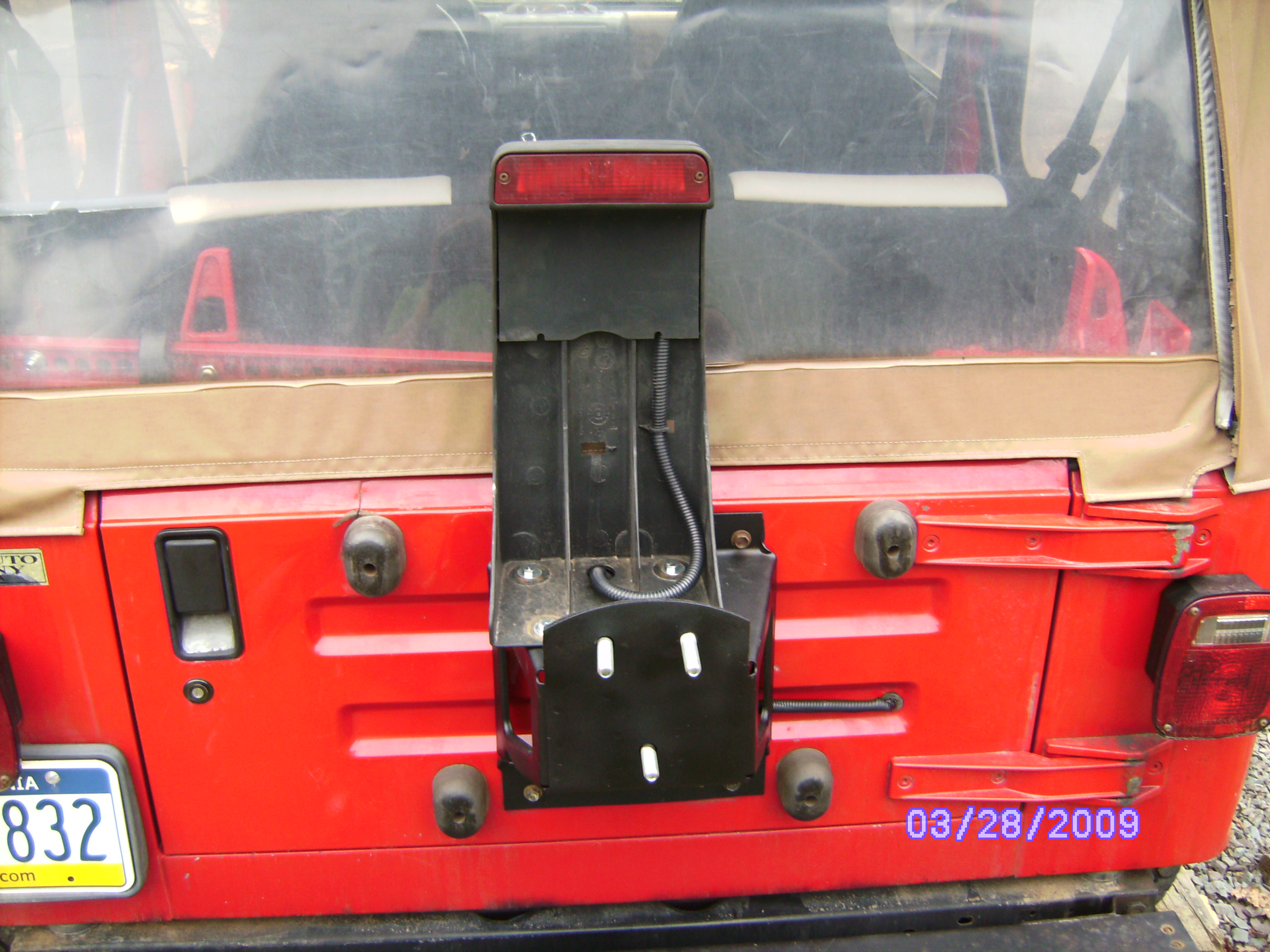

Thanks for every ones help.Got it off today.There was 5 bolts holding onto the tailgate.3 across the top and 2 on the bottom.
The 3 on the top where a pain because of the 3rd brake light.
It is off the jeep,the spare is off the bracket.
Time to sand the bracket,weld new studs in place.Then paint it,May try some spray on bed liner for the bracket.
Thanks for all the help.Finally got it all apart and new studs welded in.Since it was all apart i figured I would clean it up and paint it.
