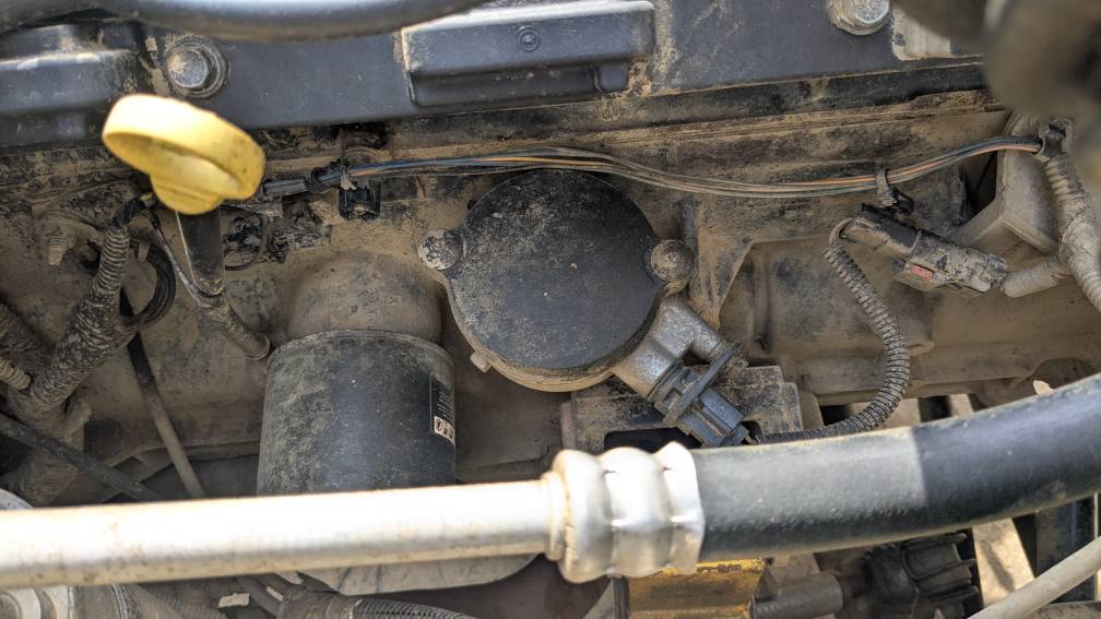

I replaced the opda successfully. It wasn't too hard and really only took me an hour.

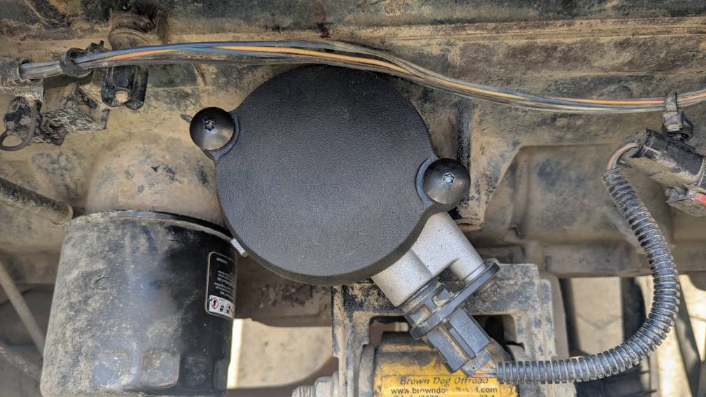

This is the original in place.

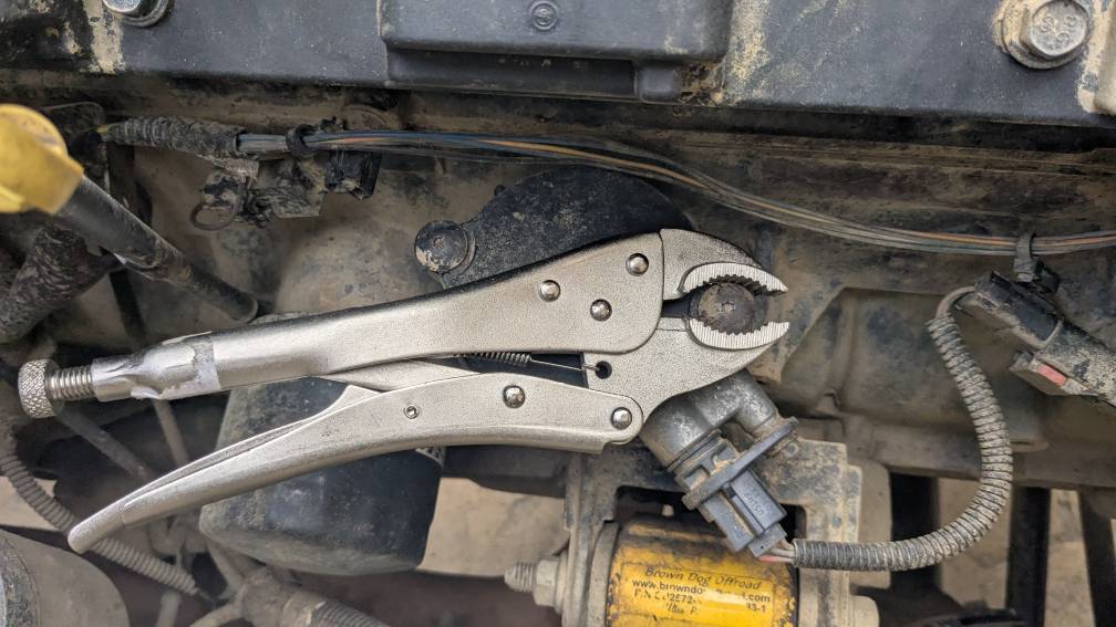

Getting these bolts off were likely the hardest part. The tiny torx stripped out immediately, but a pair of vice grips made short work of it.

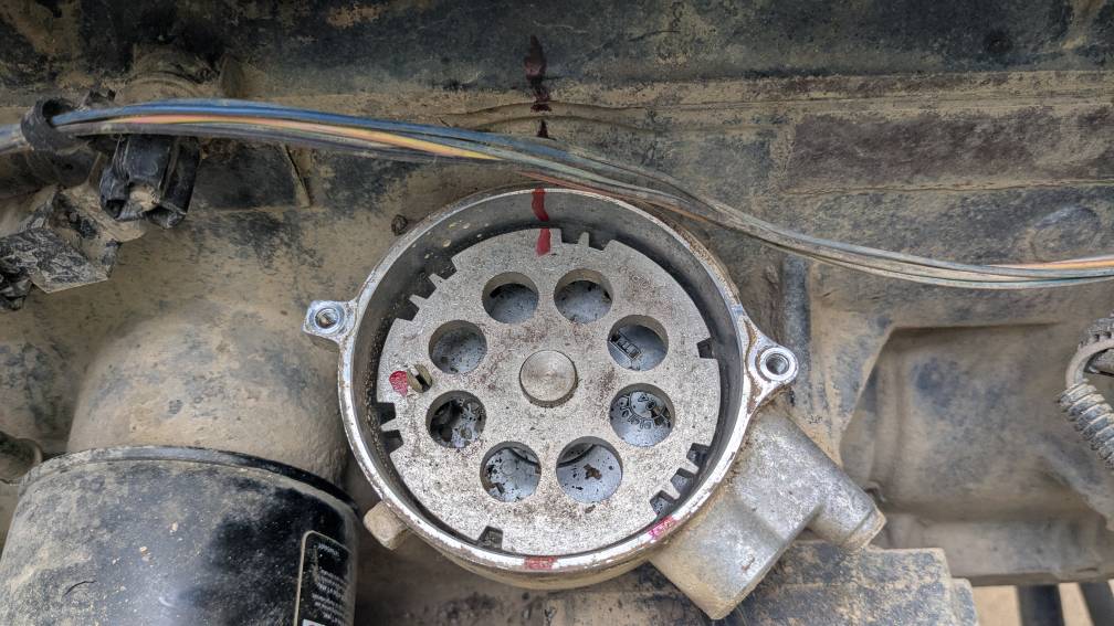

I rotated the engine until everything lined up and made a few marks

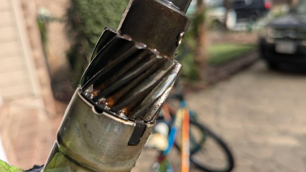

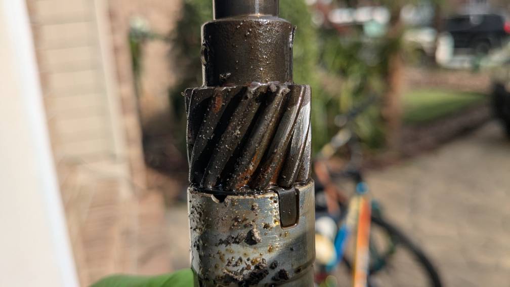

It does look like the gears were worn. I'm not sure how bad the camshaft is but I'm going to send it

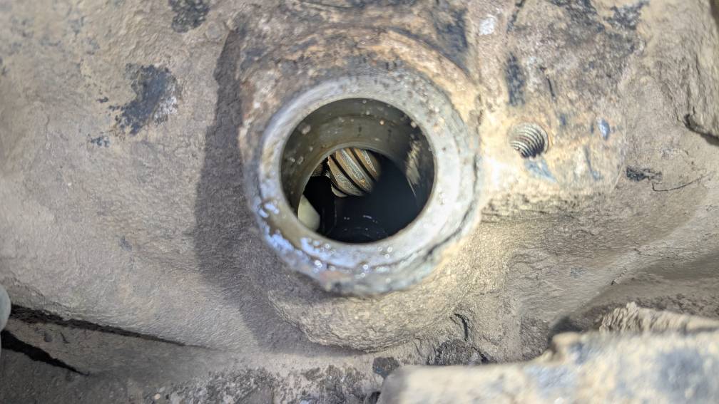

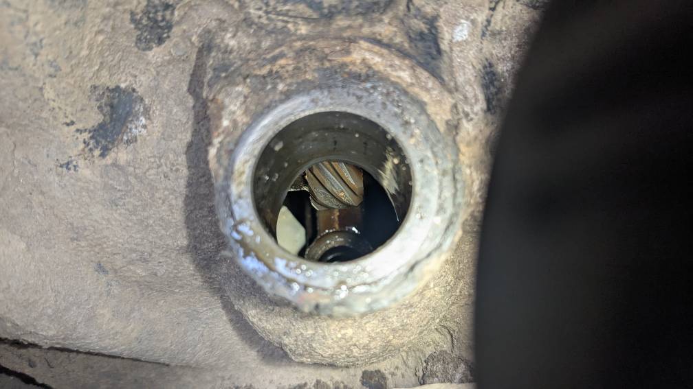

Looking in the hole I could see how the oil pump would line up and manage to drop it in place the first time. After that I buttoned everything up and it started no problem. I haven't driven it anywhere yet to see if codes pop up so that's still on the list.

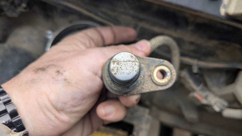

I was surprised to see that. The old cam position sensor had mud on it. I cleaned it off with Windex and reinstalled it.

It may be that the mud caused the monkeys. The CAM gear is worn but there is nothing you could do about it without changing the CAM. You may see a slightly improved mpg with the new opda. The worn gears throw sender out of sync with the actual lobes.
