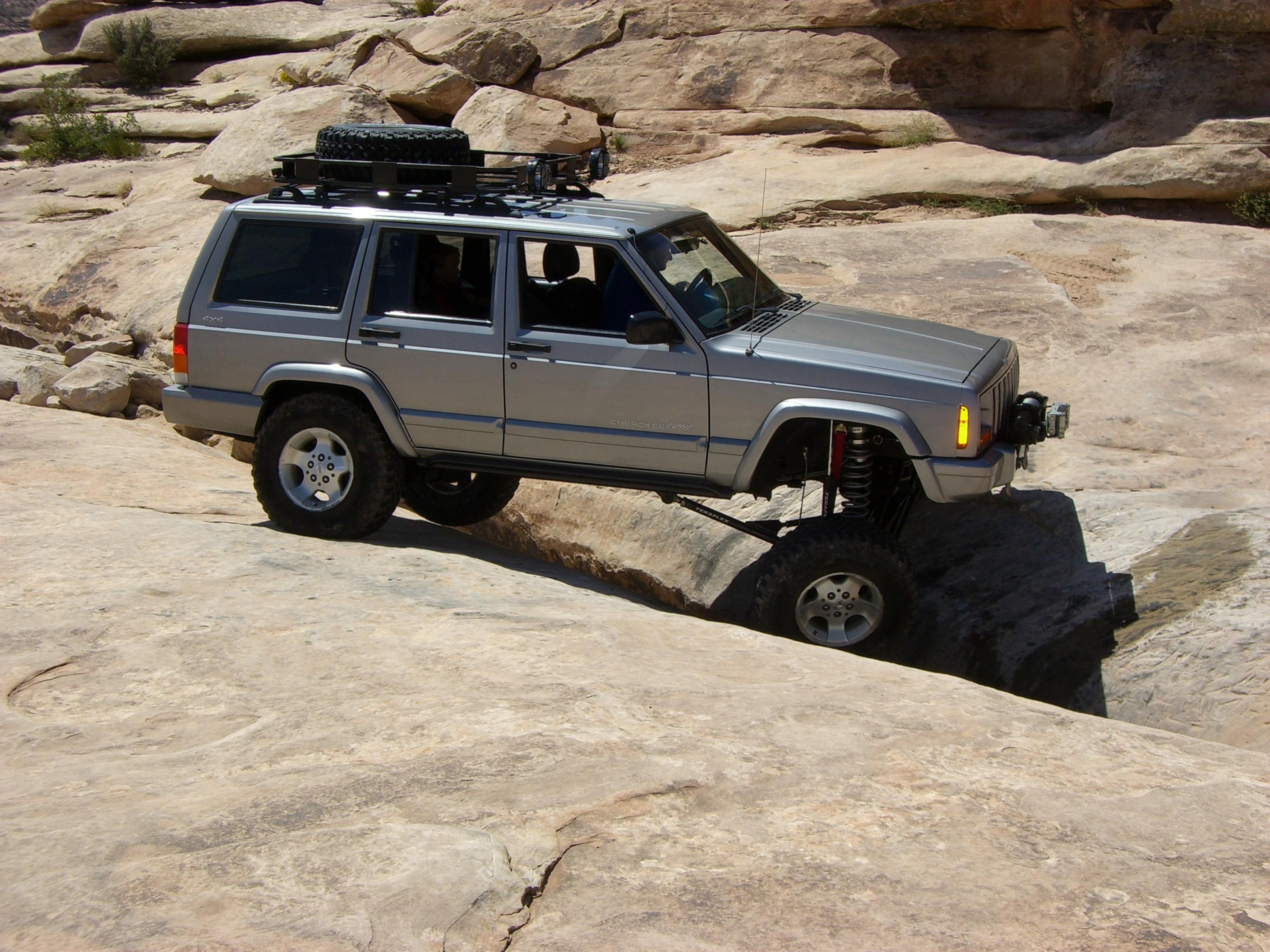

I run 33s no problem on 5"lift also ran 34s in past

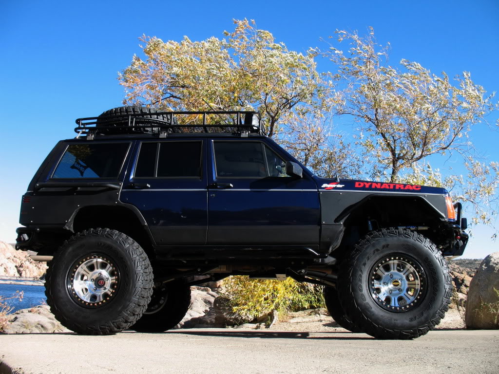

33s in pict
