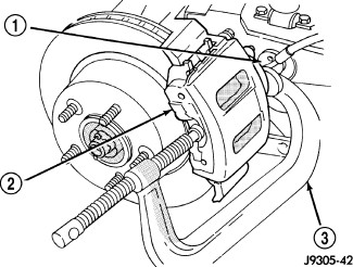

4.Bottom caliper piston in bore with C-clamp. Position clamp screw on outboard brake shoe and clamp frame on rear of caliper Fig. 1 . Do not allow clamp screw to bear directly on outboard shoe retainer spring. Use wood or metal spacer between shoe and clamp screw.
Fig. 1 - Bottoming Caliper Piston With C-Clamp
1 - CALIPER BOSS 2 - OUTBOARD BRAKESHOE 3 - C-CLAMP

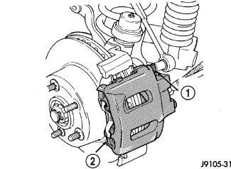

Remove caliper mounting bolts Fig. 3 .
Fig. 3 - Caliper Mounting Bolts
1 - CALIPER MOUNTING BOLT (2) 2 - CALIPER

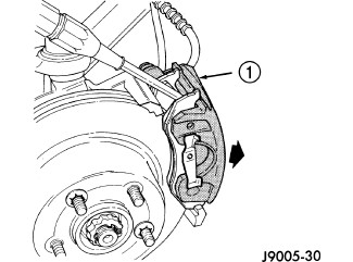

7.Tilt top of caliper outward with pry tool if necessary Fig. 4 and remove caliper.
Fig. 4 - Caliper Removal
1 - TILT CALIPER OUTBOARD TO REMOVE 8.Remove caliper from vehicle.
