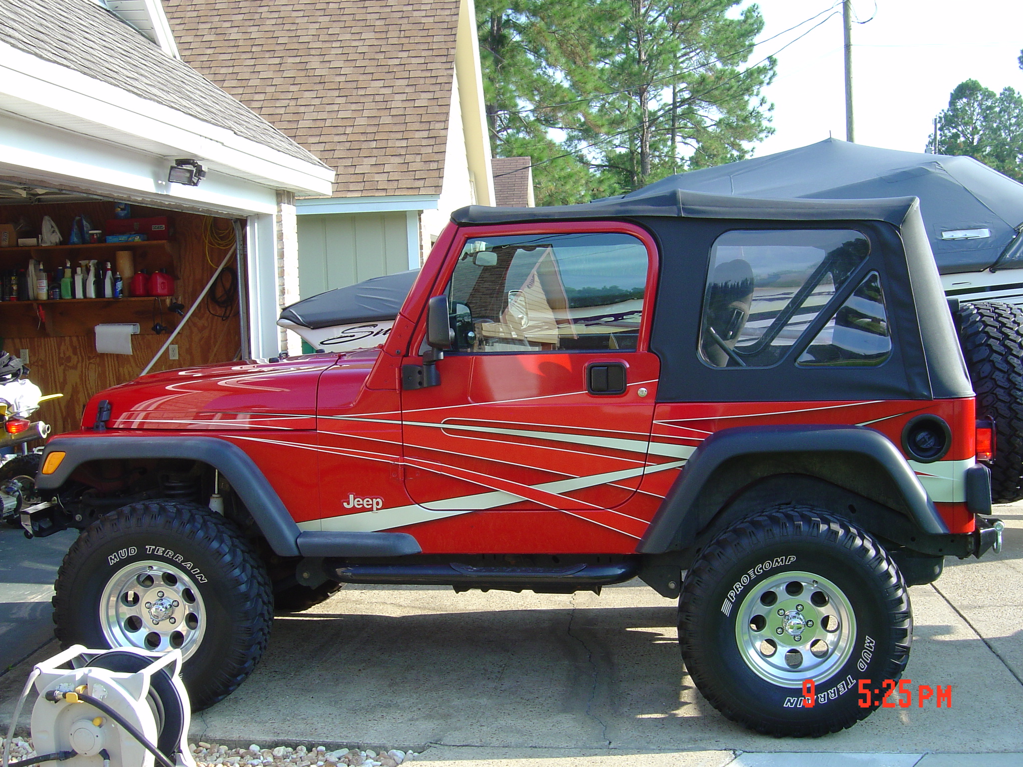

Just curious, not sure how much a caliper cost, would it be worth it just to replace them, or is there a way that i can clean them up and then put some lube of some sort to keep it moving free, also the jeep really doesnt go off road, im not much for mud or rock crawling, i keep it fairly clean. If the parts are cheap probably better to just buy new, but if i can clean them up that would be awesome.
