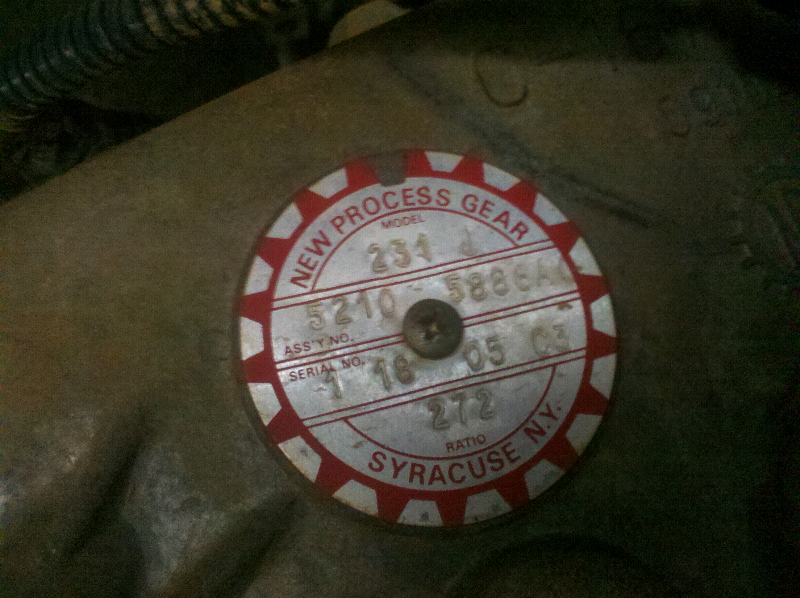

It'll turn over but not start... I looked once I got out of work & I ripped my fuel line off the frame rail... The transfer case is done, ka-put, toast... I'll post more pics of the carnage later... Which models of the np231 will work for my 2005 TJ X w/auto trans & 4.0L? The guy at Davey's Jeep quoted me $150-$350...
have to google the t-cases but i know any of them will work on the older wranglers but you have to redrill the holes that bolt it to the trans because hte engine leans a little more in a cherokee (i guess is why). but the t-case is usually the same as long as the input splines and the output to the front are splined the same.

I'd replace it with the same thing. This is the badge on my 231 transfer case off of my 2005 auto.

i think all of them after 93 or 94 are 231j trans cases. but new venture and new process are the same company, they just had a name change because their parent company got bought out in the 90s so some say nv231 and some say np231.
i put a 91 wrangler trans case into my 93 grand cherokee because my grand had that full time 4x4 and i didn't want it anymore. i had to change the output gear to the front axle because of the spline count being different and buy an adapter to fit my different style front axle but it was 100 for the t-case and 20 for the adapter for the drive shaft and took about a half a day or so to remove, open and swap gears, and then close up and reinstall.
