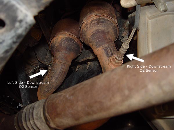

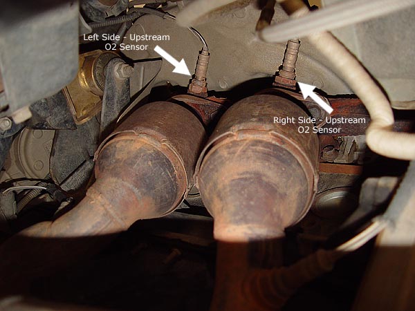

Thank you for your reply. I am not an expert on the mechanical parts of a Jeep in any way and so that's why I'm here asking for help. Though I would like to direct you to the following attachments I've included that may explain my confusion over your reply. The attached photo is the exact same configuration as my Jeep and clearely outlines banks 1 and 2 in addition to sensors 1 and 2.
Just wondering if you could clarify on your original post?
Thank you.
-Mike
