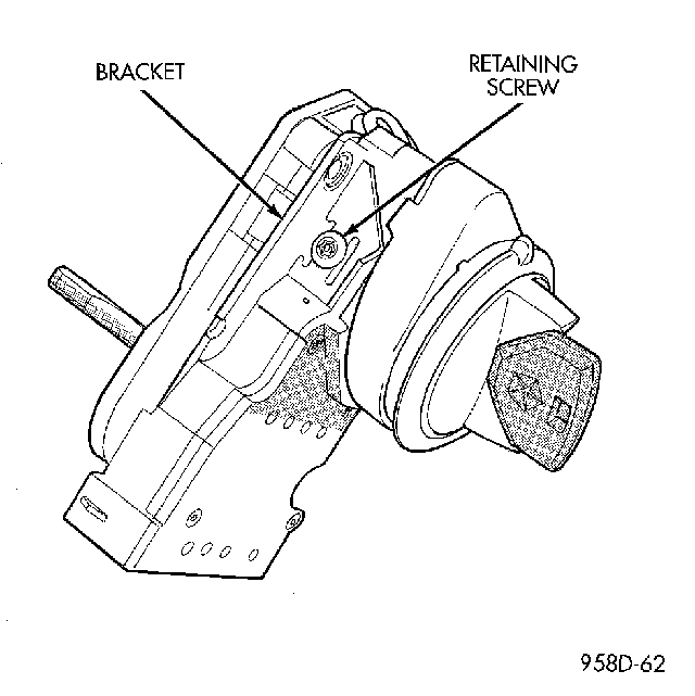

Ok is there a write up somewhere explaining how to put the ignition cylinder back in and it staying in, I cant figure out whats missing since i dont have one in perfect condition? I tried to find the drain tube and did not see it, is the passenger side of the fresh air intake supposed to have a solid back to it? Sorry for all of the questions, my bro was always the mechanic(I was the animal guy).
  1. With lock cylinder and ignition switch in Lock position, insert lock cylinder into ignition switch until it bottoms.
  2. Insert ignition key into lock cylinder. While gently pushing lock cylinder in toward ignition switch, rotate ignition key to end of travel.
  3. Install retaining screw into bracket and lock cylinder. Tighten screw to 3±.5 N·m (26±4 in. lbs.) torque.
  4. Install steering column covers. Tighten screws to 2 N·m (17 in. lbs.) torque.
  5. If vehicle is equipped with a tilt steering column, install tilt lever.
  6. Connect negative cable to battery.
  7. Check for proper operation of halo light, shift lock (if applicable), and column lock. Also check for proper operation of ignition switch accessory, lock, off, run, and start positions.
