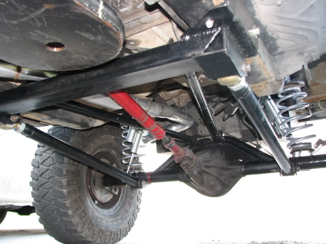

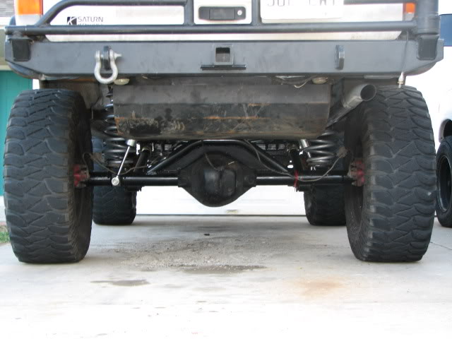

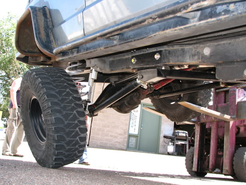

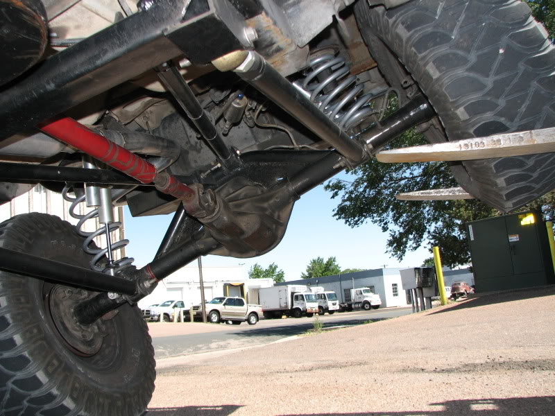

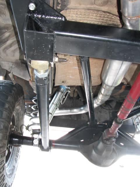

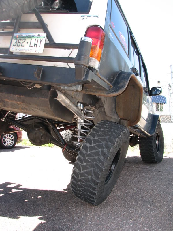

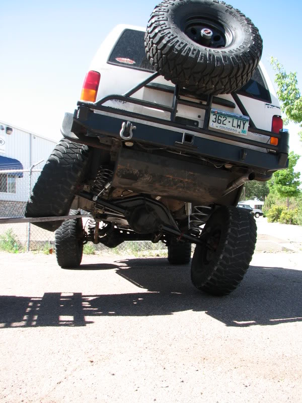

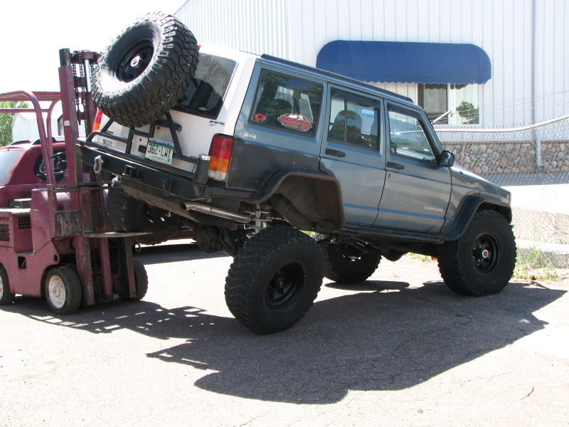

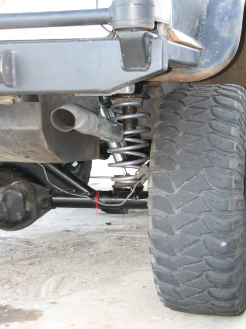

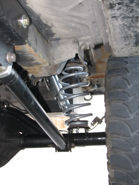

Bilstein 5165's are now installed and although the rear is a little stiff, the ride is still amazing.
I hope to get the brake hard-line finished up tomorrow.
Now I just need something to flex my rig on.....
Looks good, how much was the 4-link part of it and who made it?
Very cool, I've been looking at a bolt on truss 4-link that uses stock c/a mounts, I was curious what all the options are

My first impression was the incredibly smooth ride on pavement that the system delivered and the stability as well. Body roll is still evident but moderate since the springs have a very high spring rate and the shocks are valved very firm for an XJ (360/80). The road feel is still there but it's not In Your Face like the leaf springs were.
After turning off the highway near the top of Hoosier Pass onto the dirt road (County Rd 4) that took us to the trailhead the ride on the wash-board was simply amazing, even without airing down.

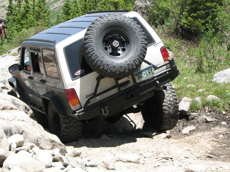

After airing down we got in line behind another group of wheelers and waited out turn to hit the trail. Since we had James family from Texas with us we weren't in a big rush and made every effort to enjoy the trail, the sights, the excellent weather, and the great company. the first minor climb up some rocks near the mine at the beginning of the trail caused be eyes to damn near pop-out.
The only word that comes to mind is Silk.....smooth as silk. The front long arms performed as usual but the rear axle moved like liquid metal. Easy transitions from compression to droop to level again.

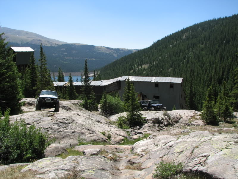

After getting out to take the obligatory pics at the water fall and a breif tour of the old mine we made our way to the obstacle.

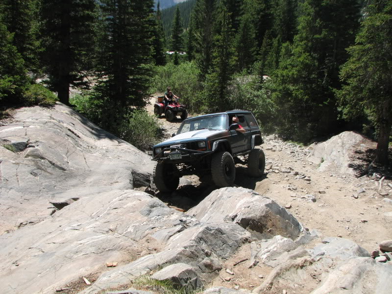

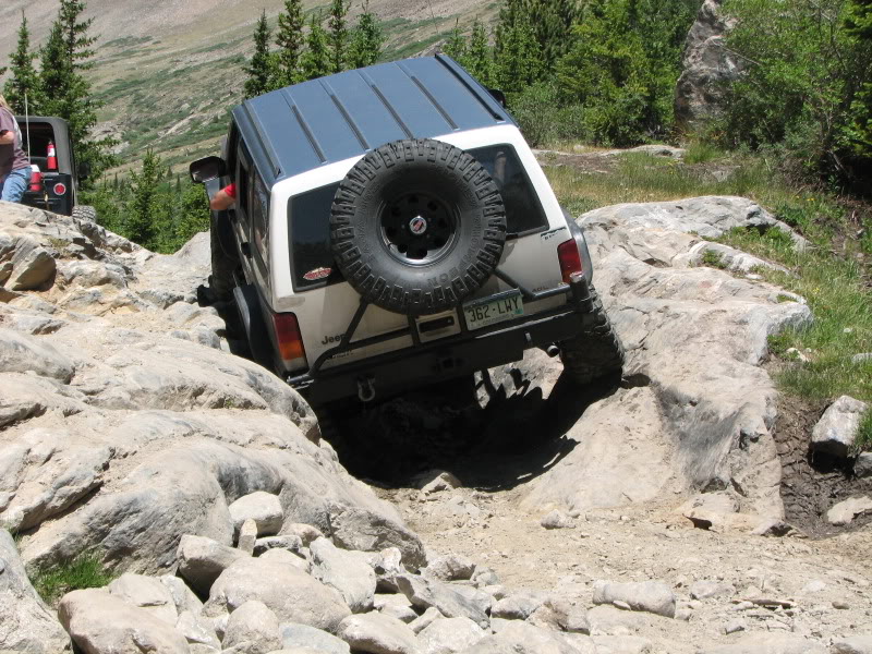

A small rock formation that is a bit dug out in spots and some sharp edges that push your rig in directions you don't want to go. More silk. No fighting the rocks, no dramatic rig shifts/swinging from left to right and back. No need to back up and try getting the rig 2" this way or 6" that way. A little throttle and the tires moved up and down with ease and we walked up without spinning a tire.

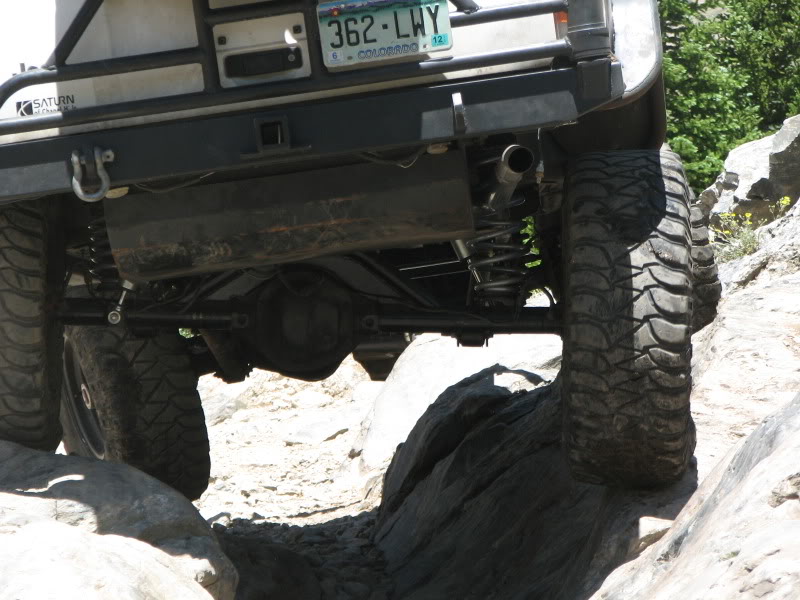

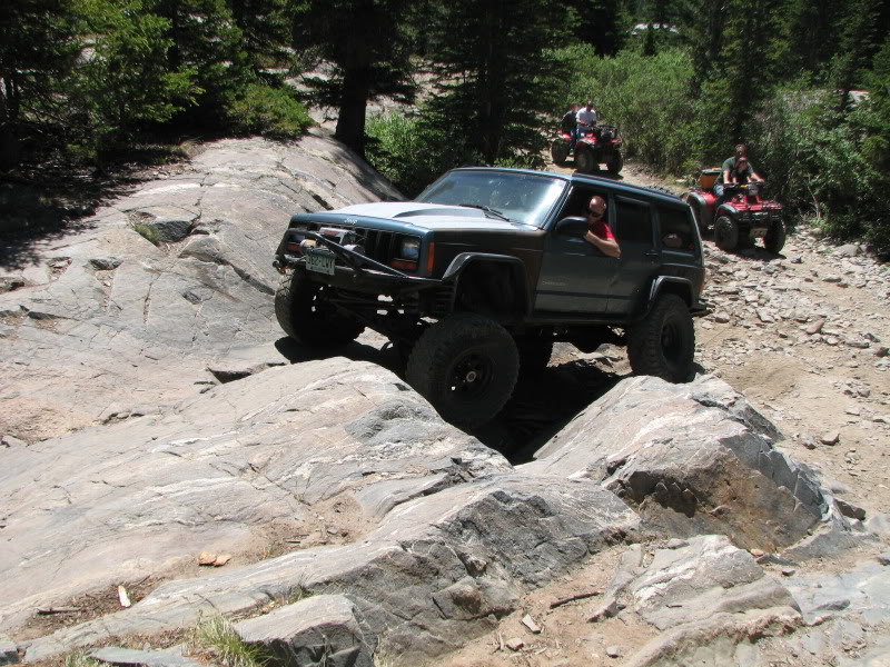

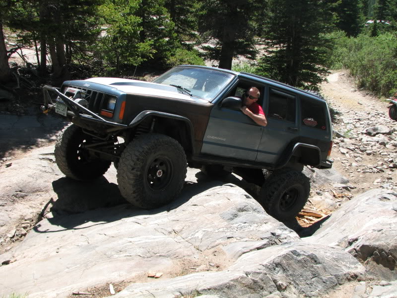

The group ahead of us was taking their time at the v-notch and the optional line next to it. I opted to take the line up the v-notch since it had given me trouble in the past. Again...Silk. All four wheels stayed firmly planted on the ground and the rear stuffed fully into the applicable wheel well.

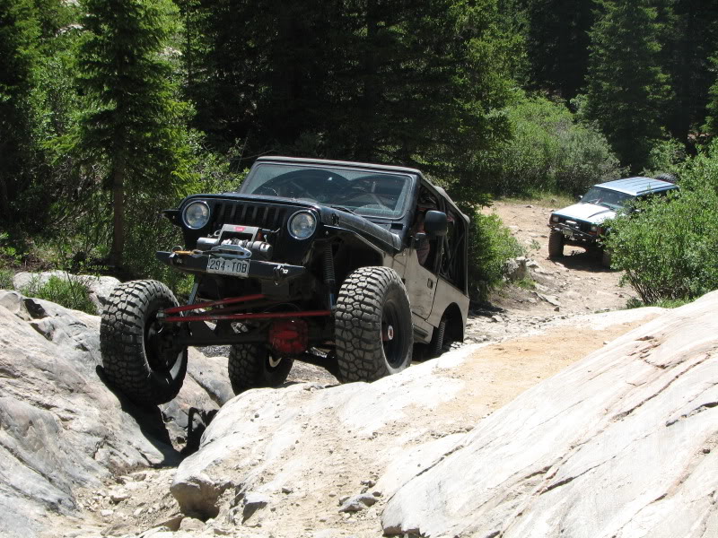

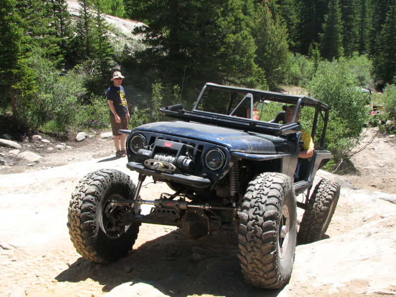

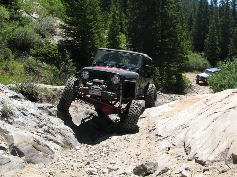

James' mom Susan in her 6.0L Vortec, front and rear Dana 60 equipped TJ at the V-Notch.

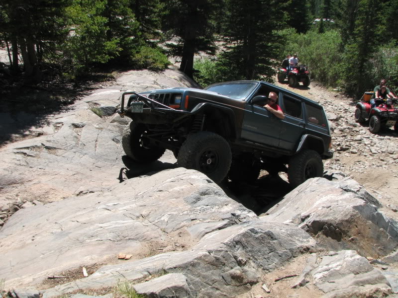

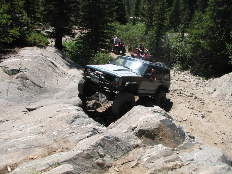

James in his 6.0L Vortec, front and rear Dana 60 equipped TJ on the alternate line next to the v-Notch.

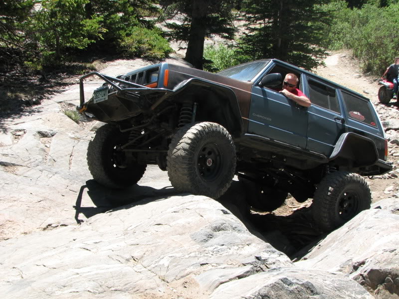

My turn.
