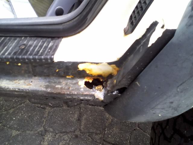

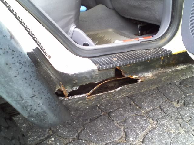

Well took a look at it yesterday and only issues i could find was the two rust holes on the rocker panels.Oh and one of the bolts that hold sway bar to frame broke off while owner was going to reinstall it and will have to be drilled and tapped out(right now,no sway bar)
seems like a decent jeep for the yr and price..
Check above the catalytic converter as well. From what is visible, I'd say that jeep is eaten up pretty good, I'd look for something more solid.
The day i looked at it,i did crawl underneath(checking for leaks) and nothing jumped out(as far as rot) but i'll see if i can meet up with the guy again to double check those areas you two mentioned..

Too much money, I live in Mass, XJ's with that type of rust/rot is very common. the easy fix is to just cut all the outer rocker off and weld in some 2x4 3/16 tubing and use it as a rocker rail guard, eventually you'll need to brace it into the unit body structure. again, too much money, offer 1200, if the guy spouts off, well it is lifted tire bla bla bla, simply tell him, $1200 if not, good luck with the sale.
i do plan on offering lower amount for cherokee considering the miles (177,000) and rust holes..KBB says approxly $1950.(for a stock 97)

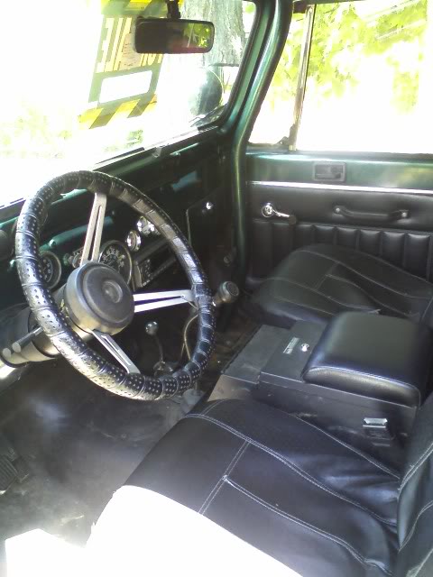

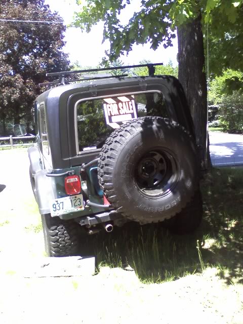

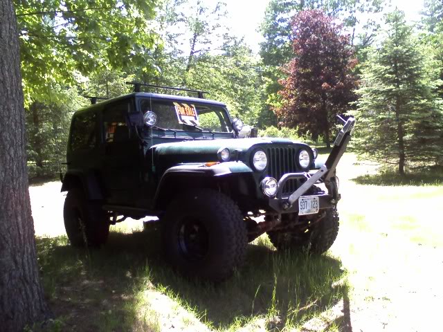

did see this on side of road today,it's a 86 wrangler CJ-7

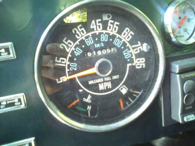

granted it's $1500.00 more.did see some rust but it's small amount of surface(on body).frame looks to be solid and freshly coated with undercoat(didn't have anything to poke around with).new ignition,new brakes,some new brake lines,new gas tank along with gas lines,new bushings(urethane),new carb,new guages.The odometer says 161,905.though it said on the sign "rebuilt 30,000 miles ago" (not sure if he meant engine or whole jeep..) sign also mentions $10,000. invested asking $3500.00 firm..
there was a bunch of other stuff mentioned but i can't remember it all..
Dana 30 front axle,Dana 44 rear,twin stick transfercase,5" lift with 35" BFGs M/T mounted on black steel wheels,swing out tire carrier with gas/water cans,tow hitch,CB antenna mount,locking center console,plus other stuff.has some shackles(front and rear) still in box plus couple other parts still in box..
just trying to figure if it's worth the extra $1500+.. :scratch:
