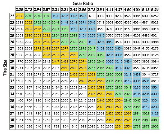

One other thing to keep in mind is the effect taller tires will have on your overall gearing. You didn't mention what gear ratio you have in your axles but the following chart will give you an idea of where your engine rpm will be with new tires.
YELLOW = Highway Driving, Good Fuel Economy​
GREEN = Daily Driver, Best Overall Performance
BLUE = Most Power and Towing, Reduced Fuel Economy
As you engine rpm drops you generally can cruise easier at freeway speeds but the trade off is no low end towing or take-off power. And if your lugging your Jeep just to get it up to speed, this will have a negative impact on mileage; it's got to work to hard just to get up to speed.
The other end of the scale is running to high rpm's. Sure, you can pull a tank and burn rubber all day long but maintaining freeway speed with the engine screamin' like a banshee will kill you mpg and could shorten engine life as well.

Guys, correct me here if I'm wrong but if yOozahOe519 got a 4-banger didn't it come with 4.11 gears? If that's the case and looking at the chart I posted going even up to 33" tires isn't going to make that drastic of a difference.
