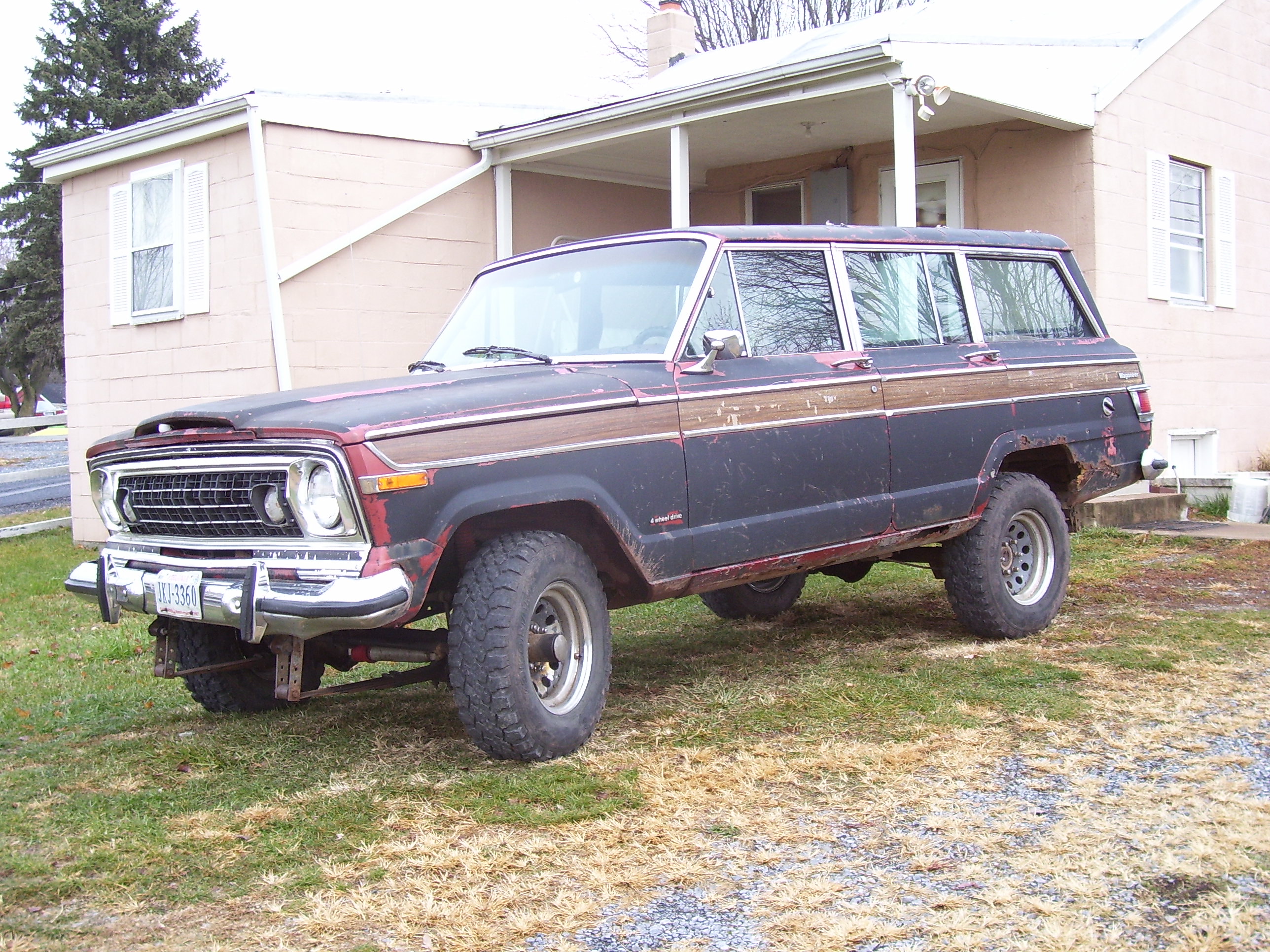

My friend has a jeep wagoneer with the same issue of it jumping when makeing a turn on pavement. I had suggested about removeing the front drive shaft, it just so happened that the previous owner was there and said that with out the front drive shaft in it will not go forward, it would go in reverse for a little bit ,that was it . He could see the transfer case working but no go with out the front driveshaft in, I dont know much but that leads me to believe that the viscous coupler has something to do with that.

The wagoneer the broken hearted jeeper has, is in four wheel drive all the time till he hits highway speed of about 45 mph. [ so he claims]

So what are the list of problems that could be causeing it, is it the viscous coupler?
It generally is the viscous coupler, that's the part that allows differential action between front and rear axles and is responsible for keeping the fulltime 4wd transparent on road.
