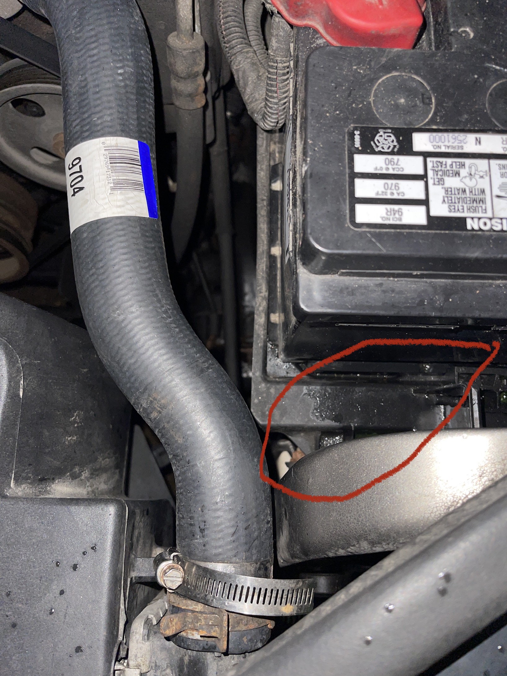

![FC408380-B6C0-4A56-B28F-B69FCC665BC8.jpeg FC408380-B6C0-4A56-B28F-B69FCC665BC8.jpeg](https://www.jeepz.com/forum/data/attachments/22/22596-f0b6d0fe5b68c4d3f48b72f04a9d088b.jpg)
here is the gist of things:
I have a 2005 Jeep Grand Cherokee Laredo with ~193k miles on it. V6, AWD, 3.7L, automatic transmission.
I’ve owned the vehicle for 3 years and have had no issues until recently.
At first I noticed my upper radiator hose was deflated when cold, and that there was coolant pooling in this little space near the battery terminal and it also will drip down onto the ground. To remedy the leak I tried the following: changing upper radiator hose, changing radiator cap, and also I replaced thermostat. I also checked the overflow hose, which was clogged, and i unclogged it. When i first changed the upper hose the leak stopped for like 2 days but now it’s right back at it. The temperature gauge never goes past the halfway point. Only one time did I notice white “smoke” from my exhaust, but other than that nothing. I have checked every single radiator/cooling hose and cannot see any cracks, wear, leaks, weakness, they’re not wet, etc.
Does anyone have any ideas?! There’s literally a 1.5 month wait to get into a mechanic where I live, so I’ve been trying to do this myself. I have diagnosed/repaired various things on different vehicles before, but I’m honestly at a loss.
Thank you so much. Pics attached.
[https://imgur.com/a/SqJavCD](https://imgur.com/a/SqJavCD)
