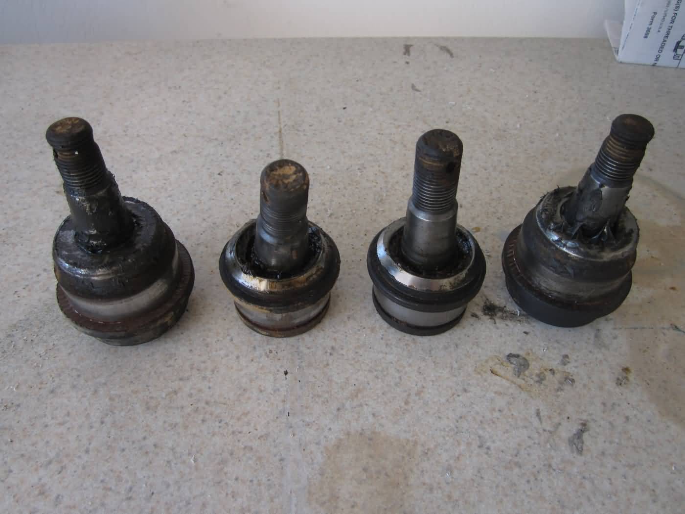

On your Jeep, the ball joints are responsible for connecting the steering knuckle to your axle. A worn ball joint will often cause sloppy steering and a popping sound as you go over pot holes and bumps. A simple check to see if your ball joints are bad is to jack up your Jeep, with a few inches of air under your front wheels. Use a long pry bar or broom handle inserted under one of the front tires to move the tire up and down. While the tire goes up and down, you may see movement in your ball joints. You should not see any movement.Here is an example of a bad ball joint:
and another (with the boot removed)

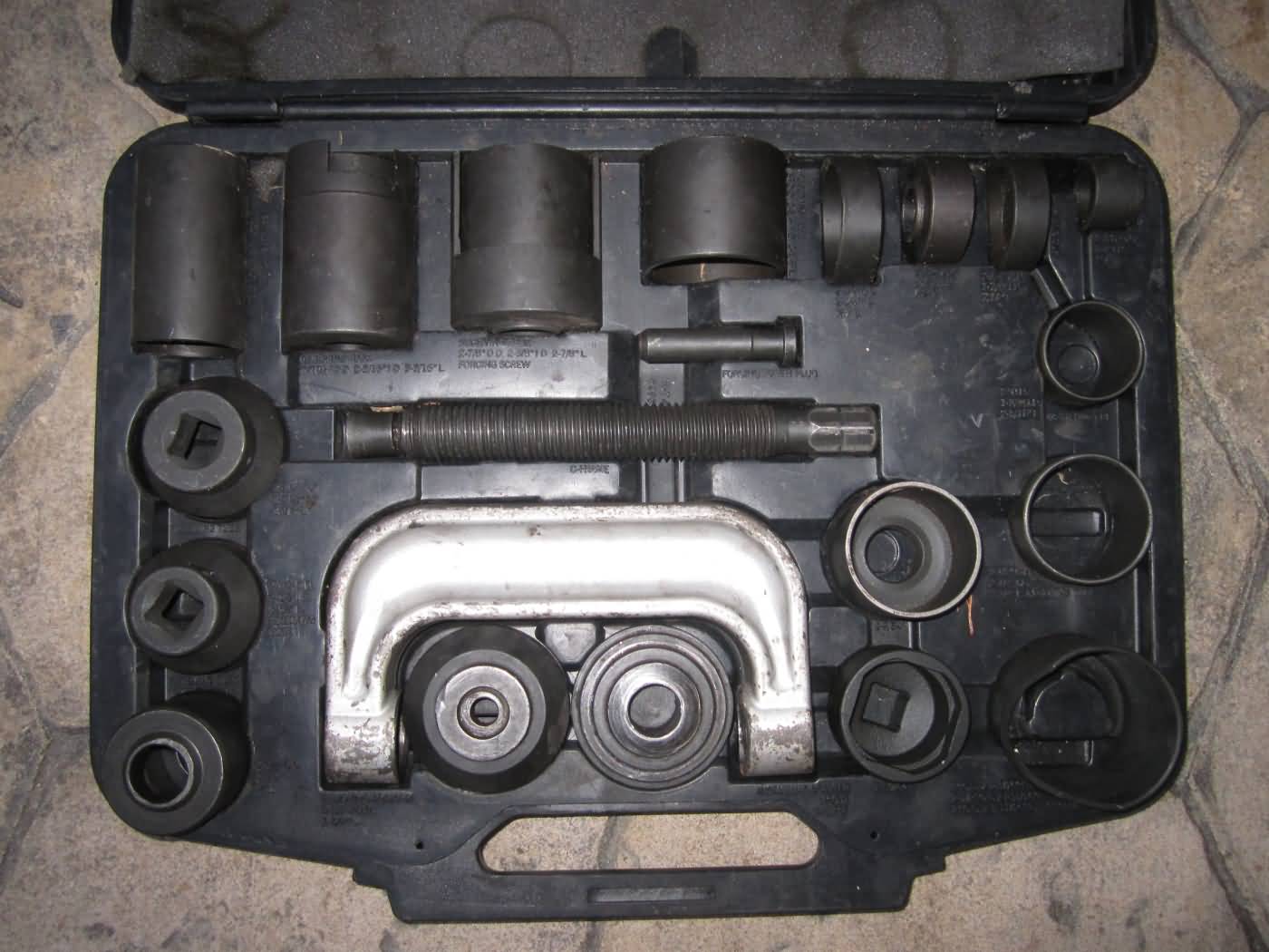

Once you've identified your ball joints as bad, you'll need to go about replacing them. Replacing ball joints requires a ball joint tool (inventive name huh?). This is a C-clamp with some extra fittings that allow you to press out the old joints and press the new ones in. I rented my tool from Advance Auto Parts for free (leave a $160 deposit, and then get it back when I'm done).
You'll also need a standard socket set, a floor jack, a grease gun (to lube your new ball joints), and some jack stands to secure everything.

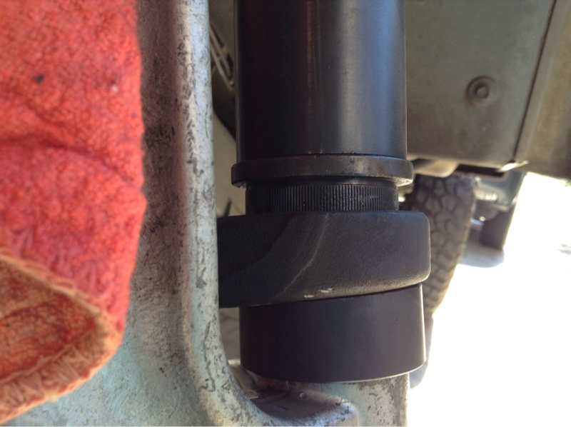

There is a Jeep / Dodge specific ball joint tool (OTC 7894) that is available at amazon:
Amazon.com: OTC 7894 Ball Joint Service Adapter for Jeep/Dodge: Automotive
This is used with the standard ball joint tool that you rent at the local parts store. What this does is give you a tapered cup. The Jeep knuckle is angled, so that if you use a universal ball joint tool you'll end up putting the ball joint in at an angle. In the photo below you can see the ball joint on top, then the knuckle below it, and the angled cup on the bottom.

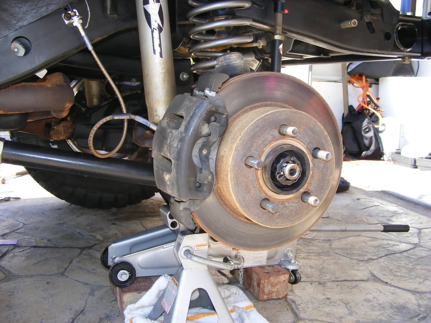

Removing the front brakes

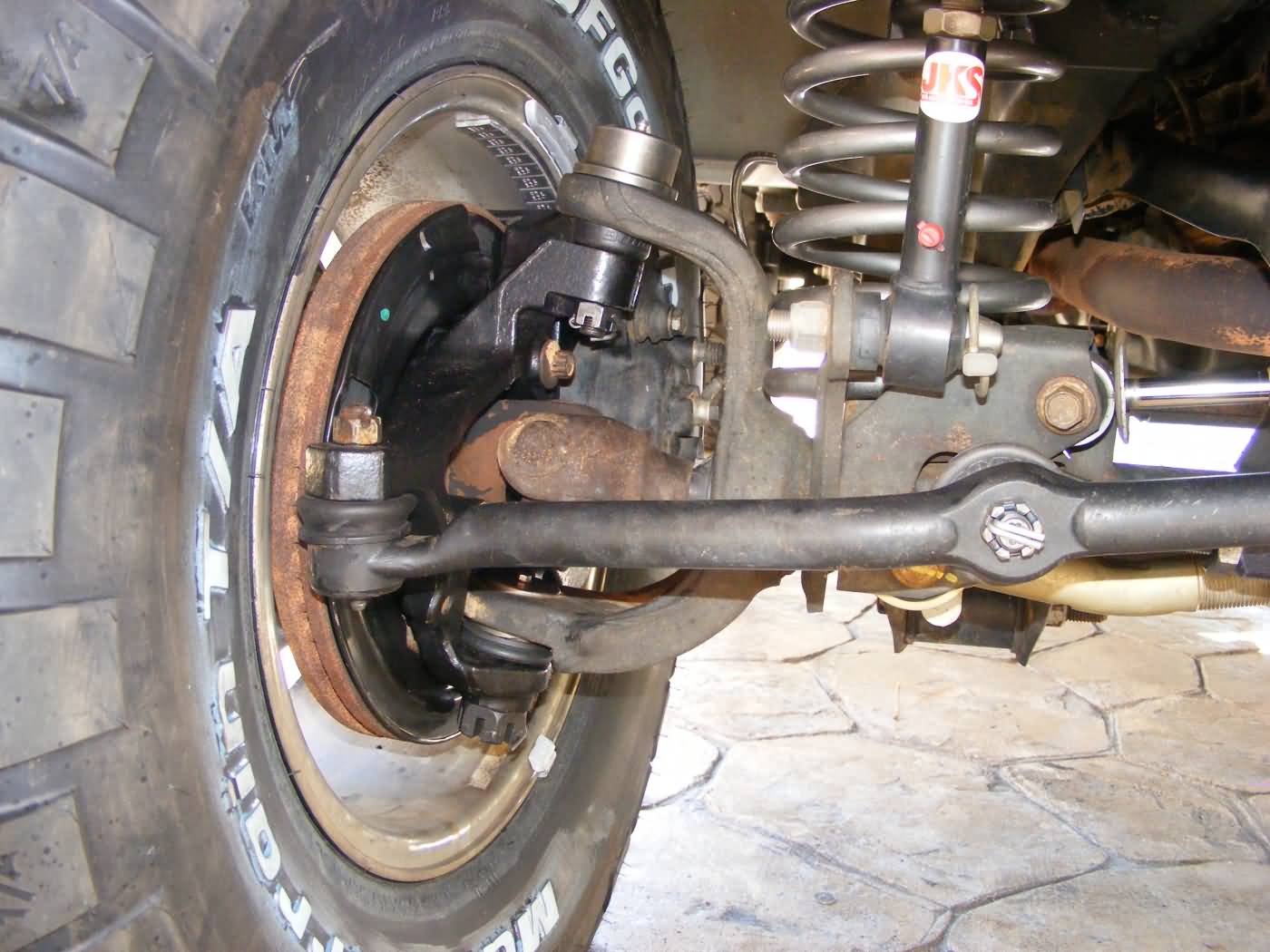

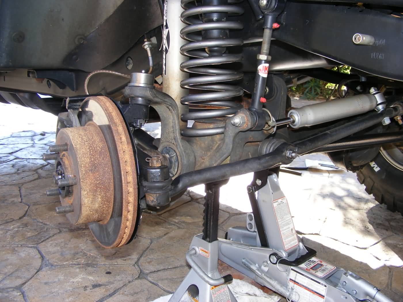

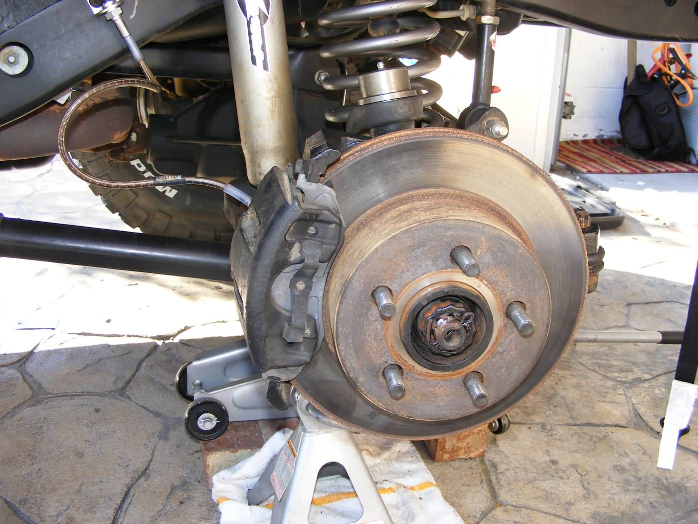

The first step in removing your ball joints is to take off the front brakes. Jack up the vehicle, remove the tire, and remove the two 13 mm bolts that hold the front caliper on

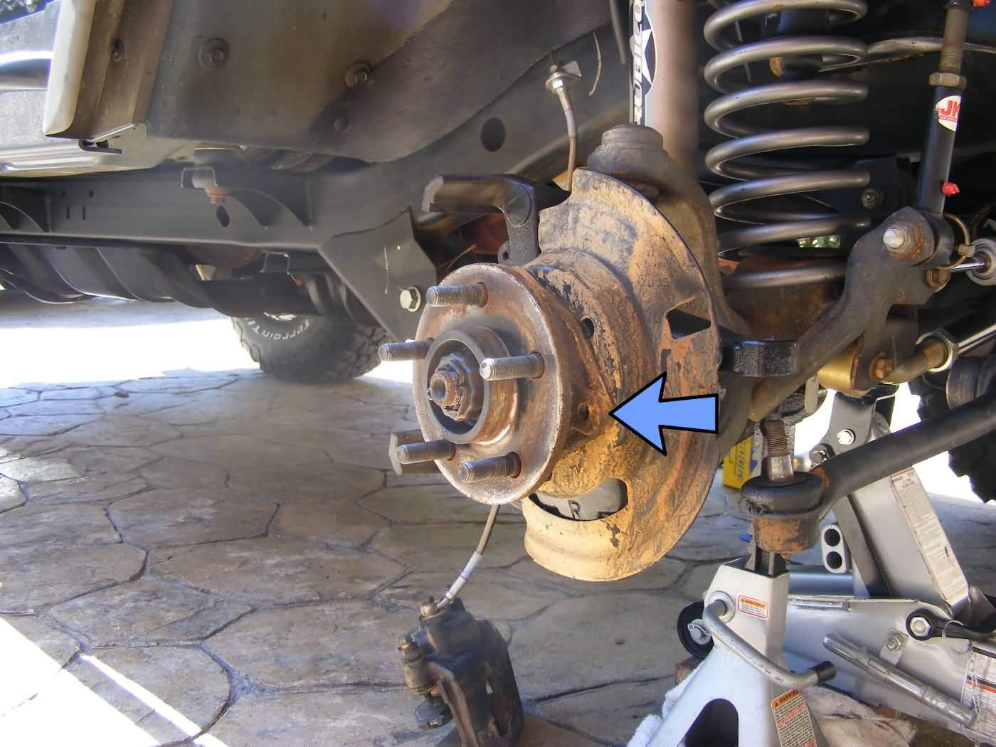

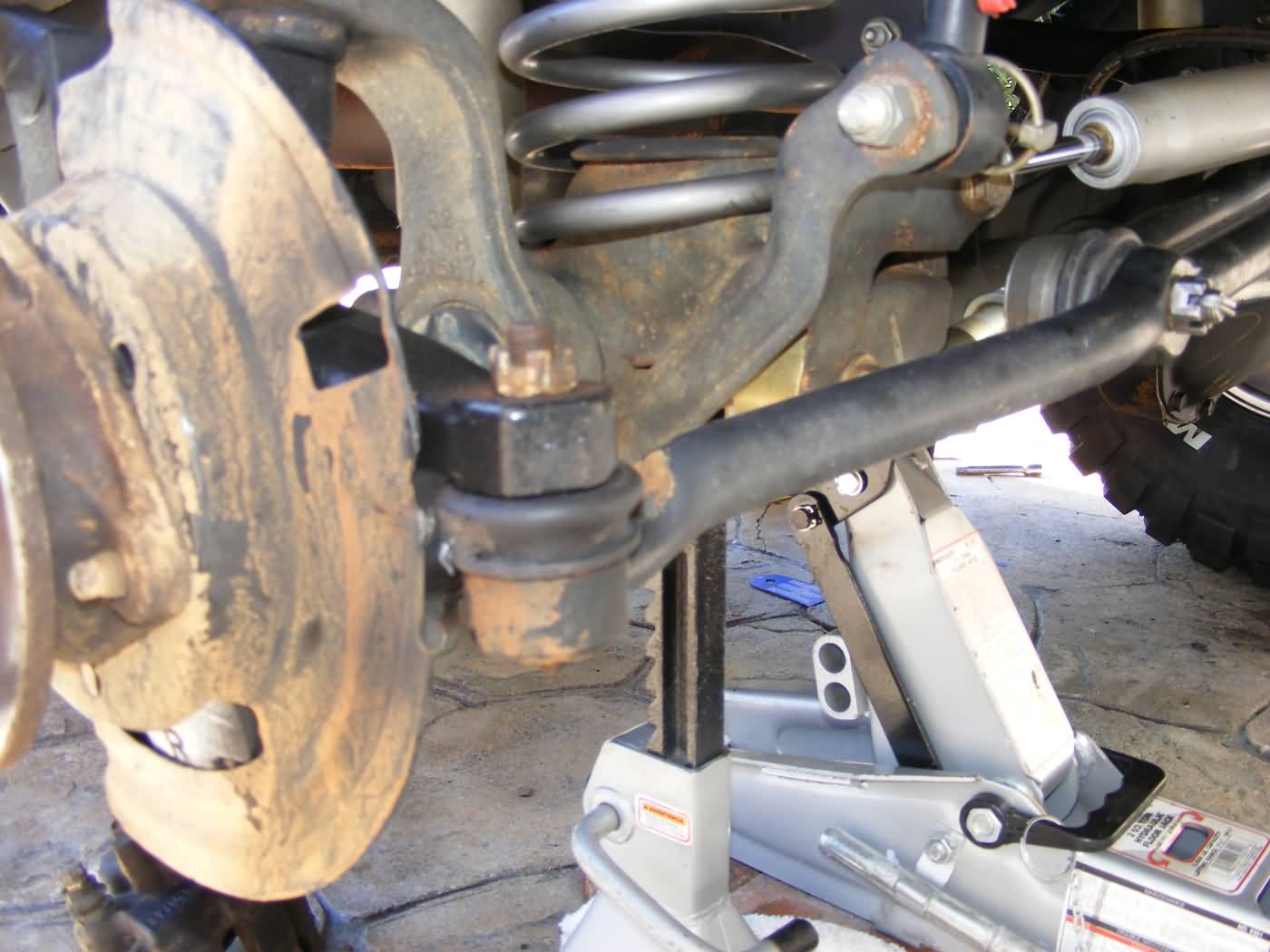

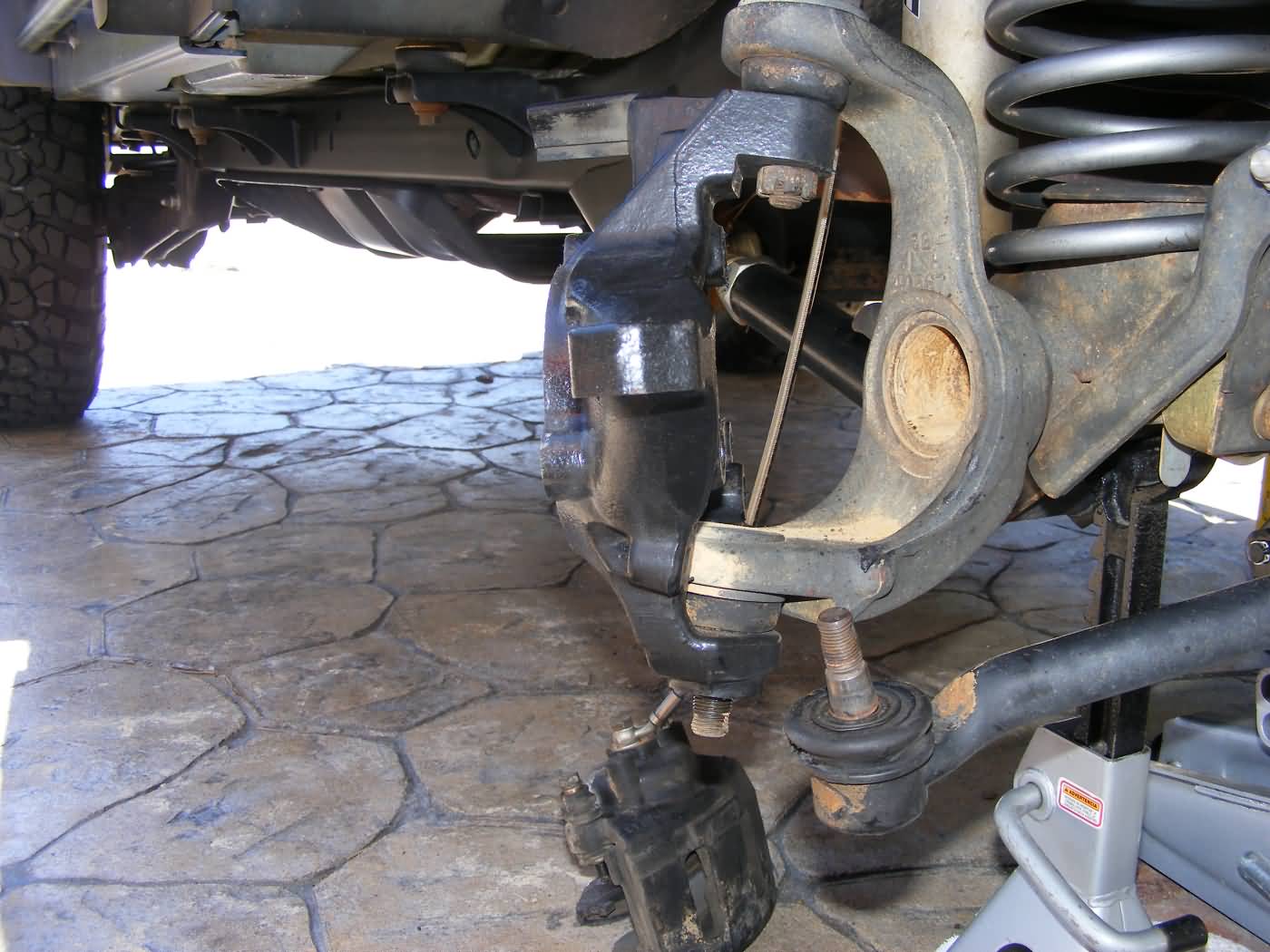

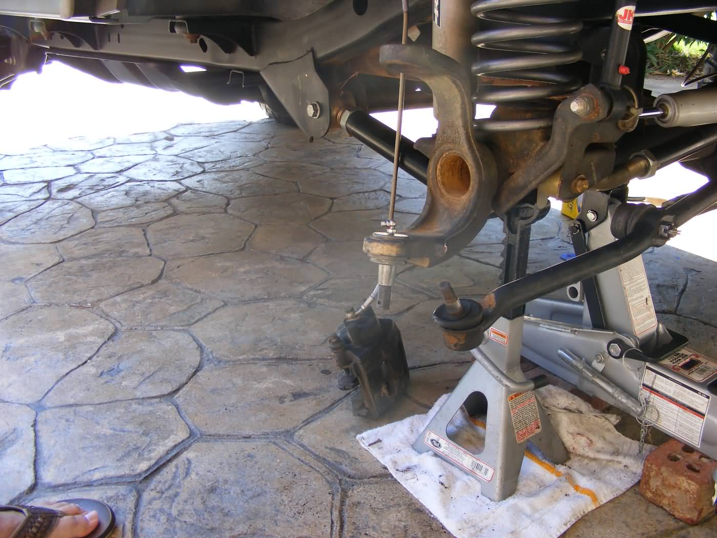

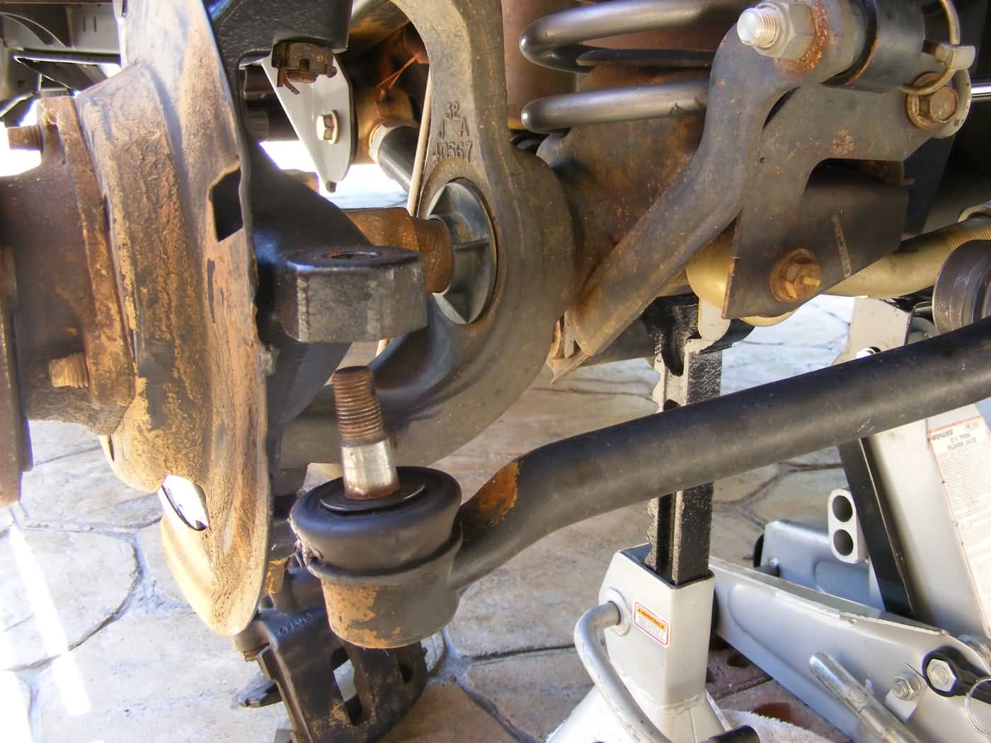

Once the caliper is out of the way, you can remove the rotor, and then remove the front tie rod end. You'll need to take out the cotter pin and castle bolt that hold the tie rod on, then using a pickle fork pry the end off. You can use a hammer to remove the tie rod end, but you risk flattening out the head and ruining the threads on the tie rod end.

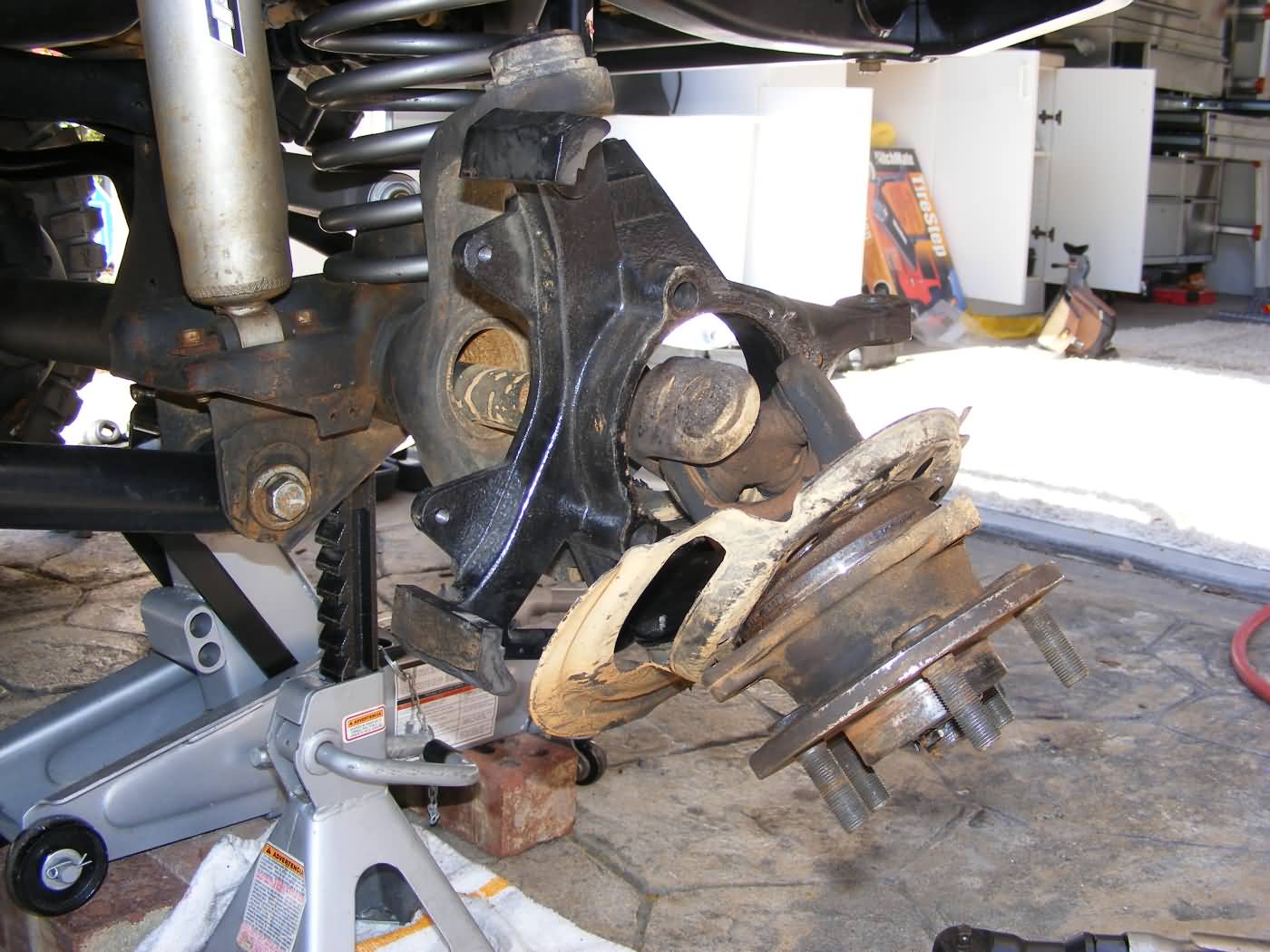

Removing the wheel bearings and axle shaft

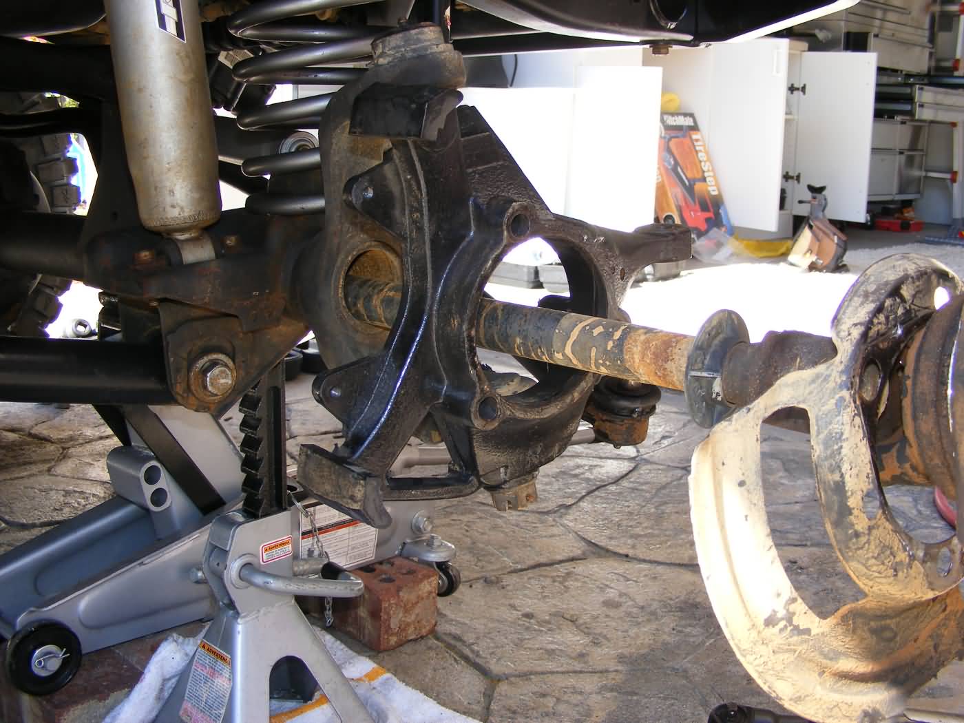

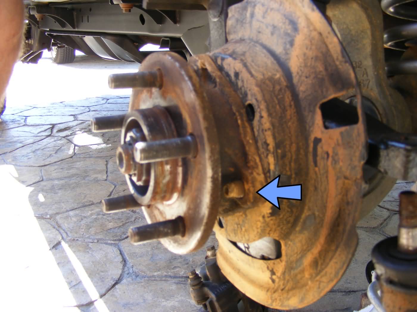

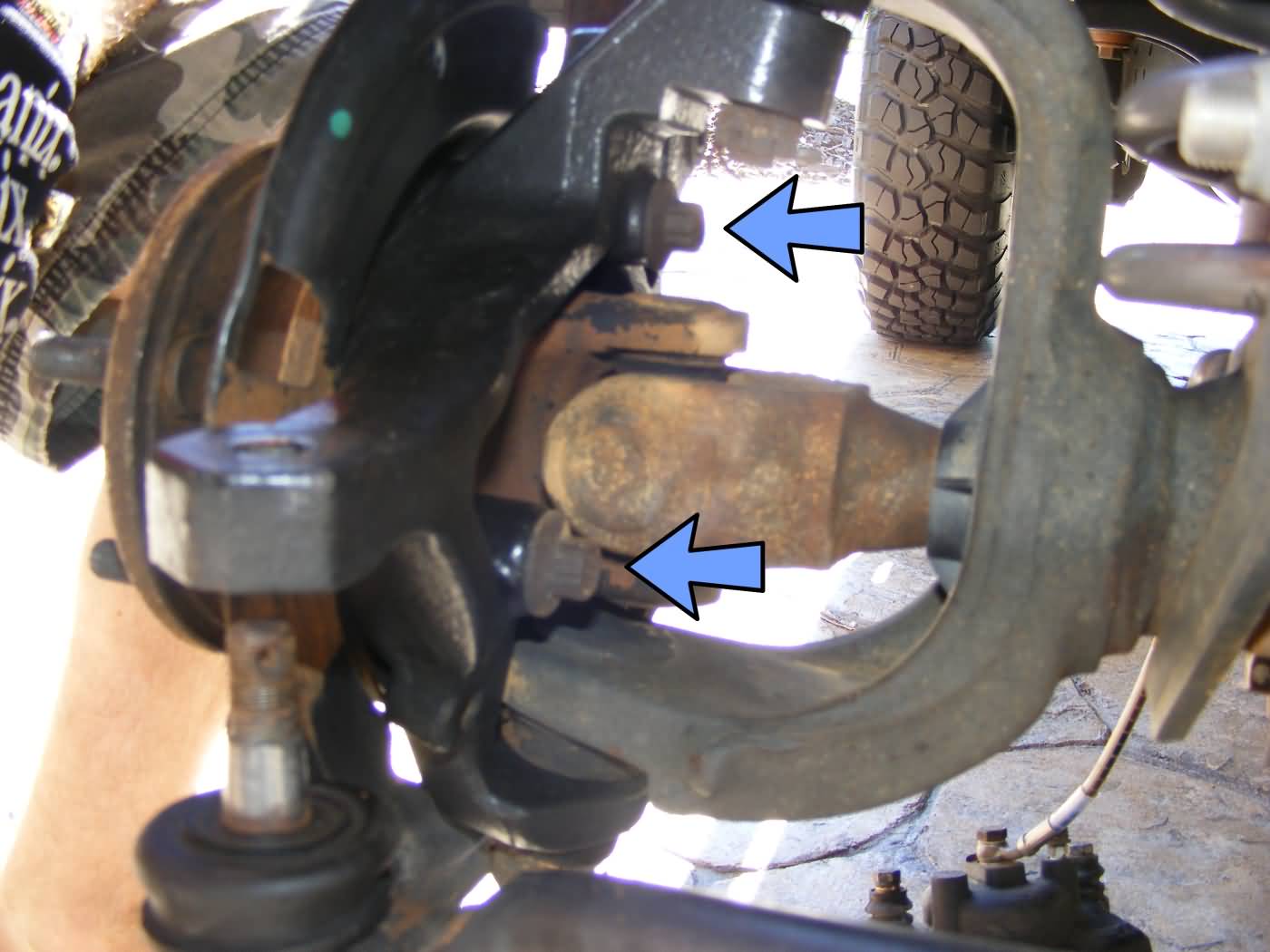

There are three bolts on the inside of the steering knuckle that need to be removed in order to get to the axle shaft. Just use your standard socket and pull them out.
Bolts still in:
And removed:

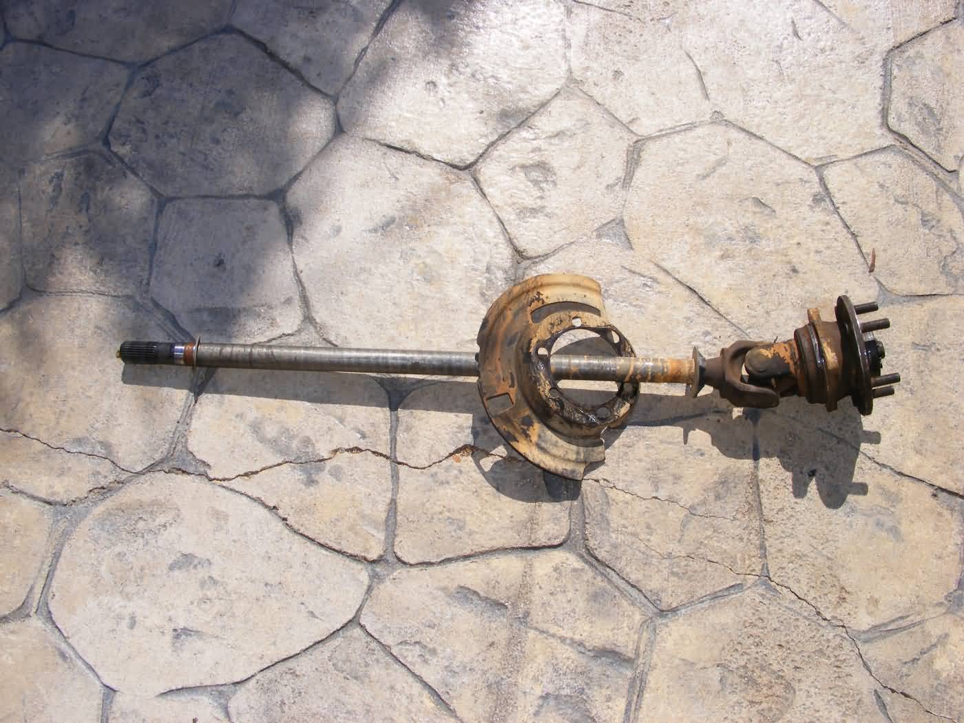

Now the axle should come out easily. Just pull it straight out.

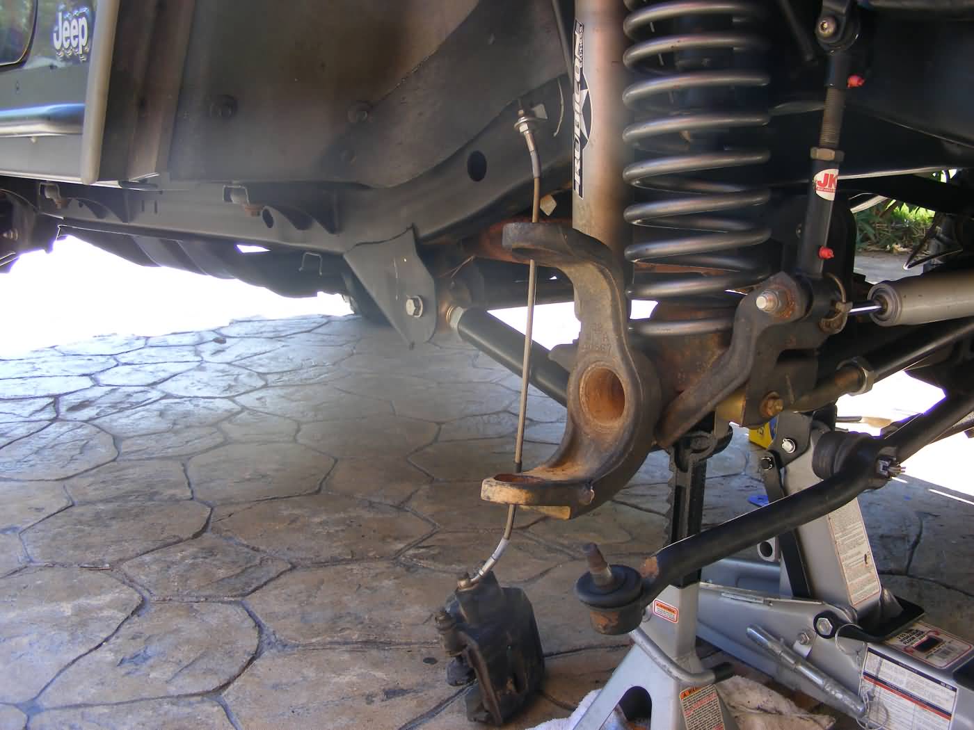

Removing the steering knuckle

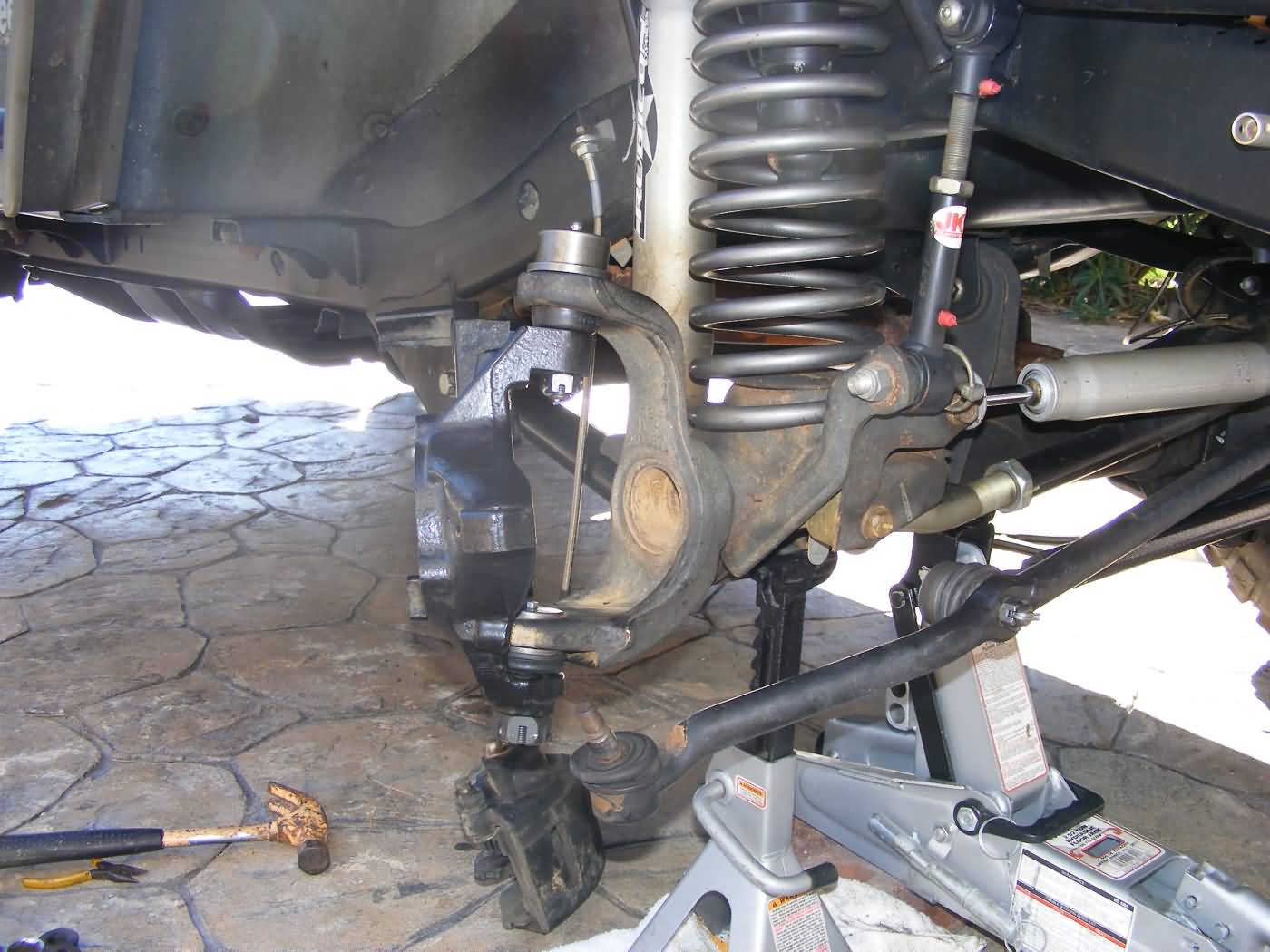

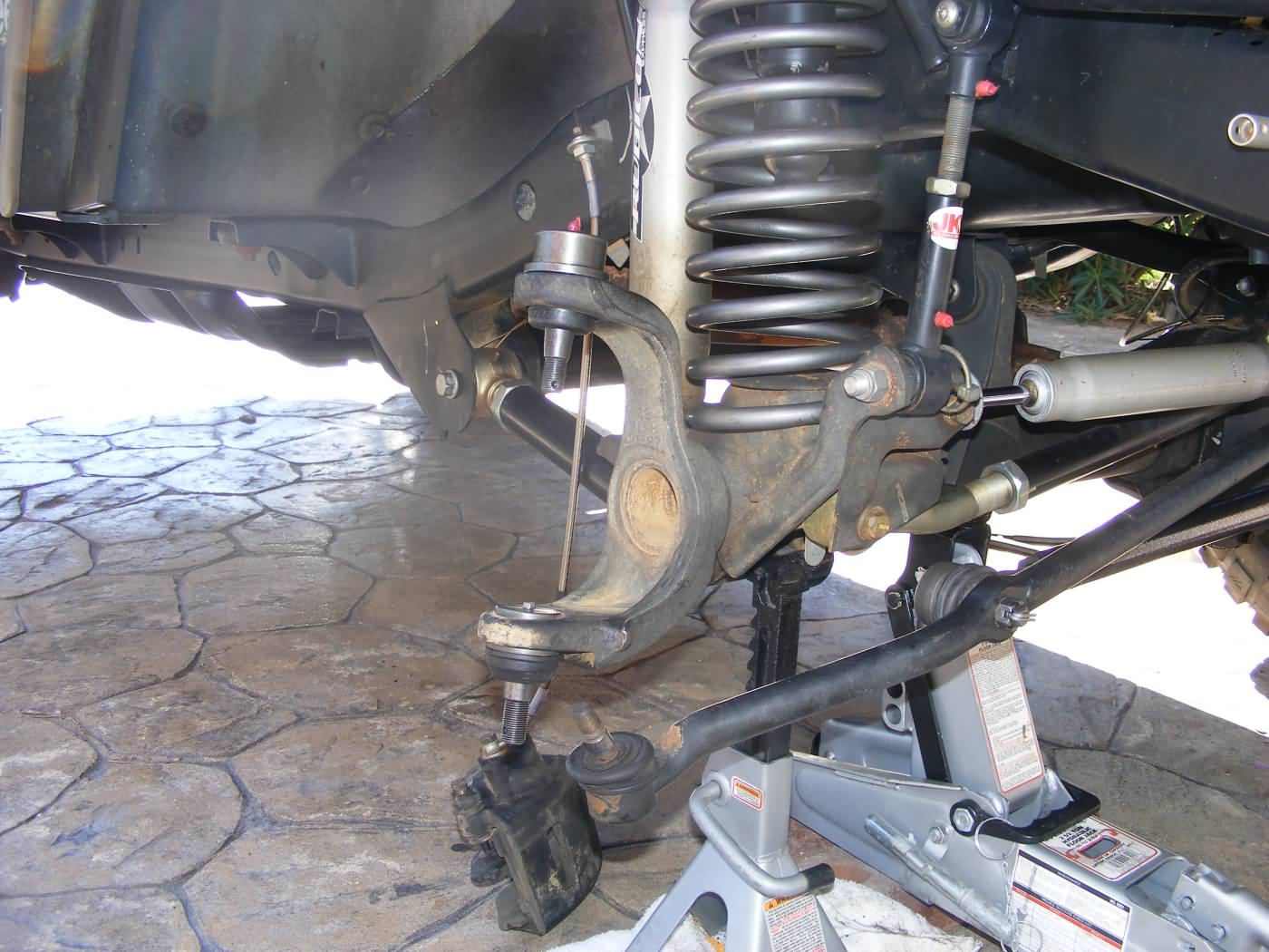

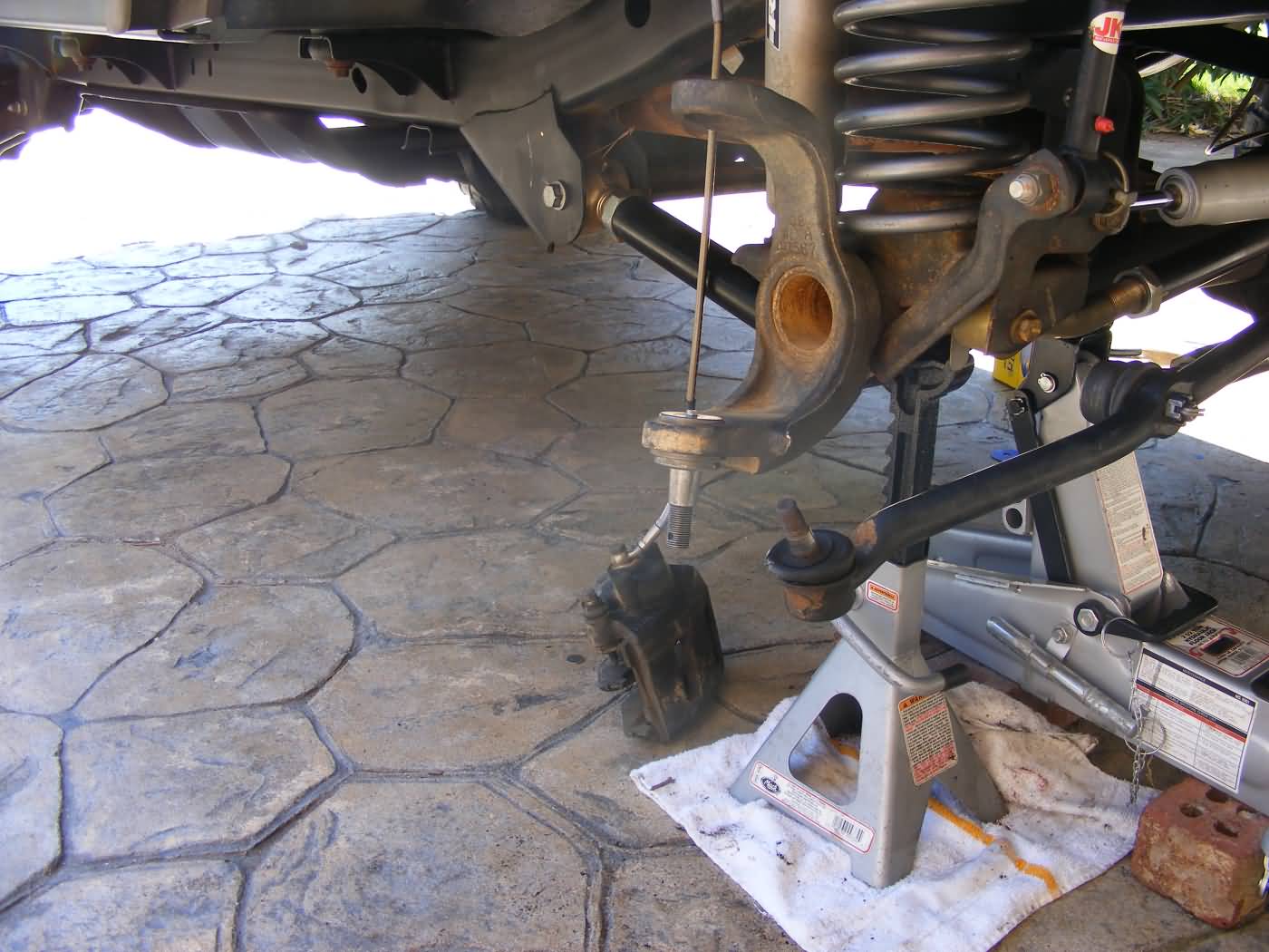

Now that the axle is out, you'll need to remove the steering knuckle. Just remove the bolts on the top and bottom ball joint. You'll now need to hit the steering knuckle with a large hammer several times. It will eventually pop and fall off (watch your feet while you do this).
Removing the ball joints

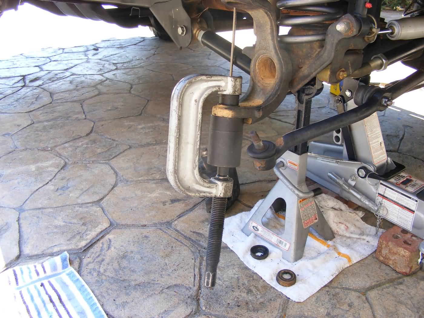

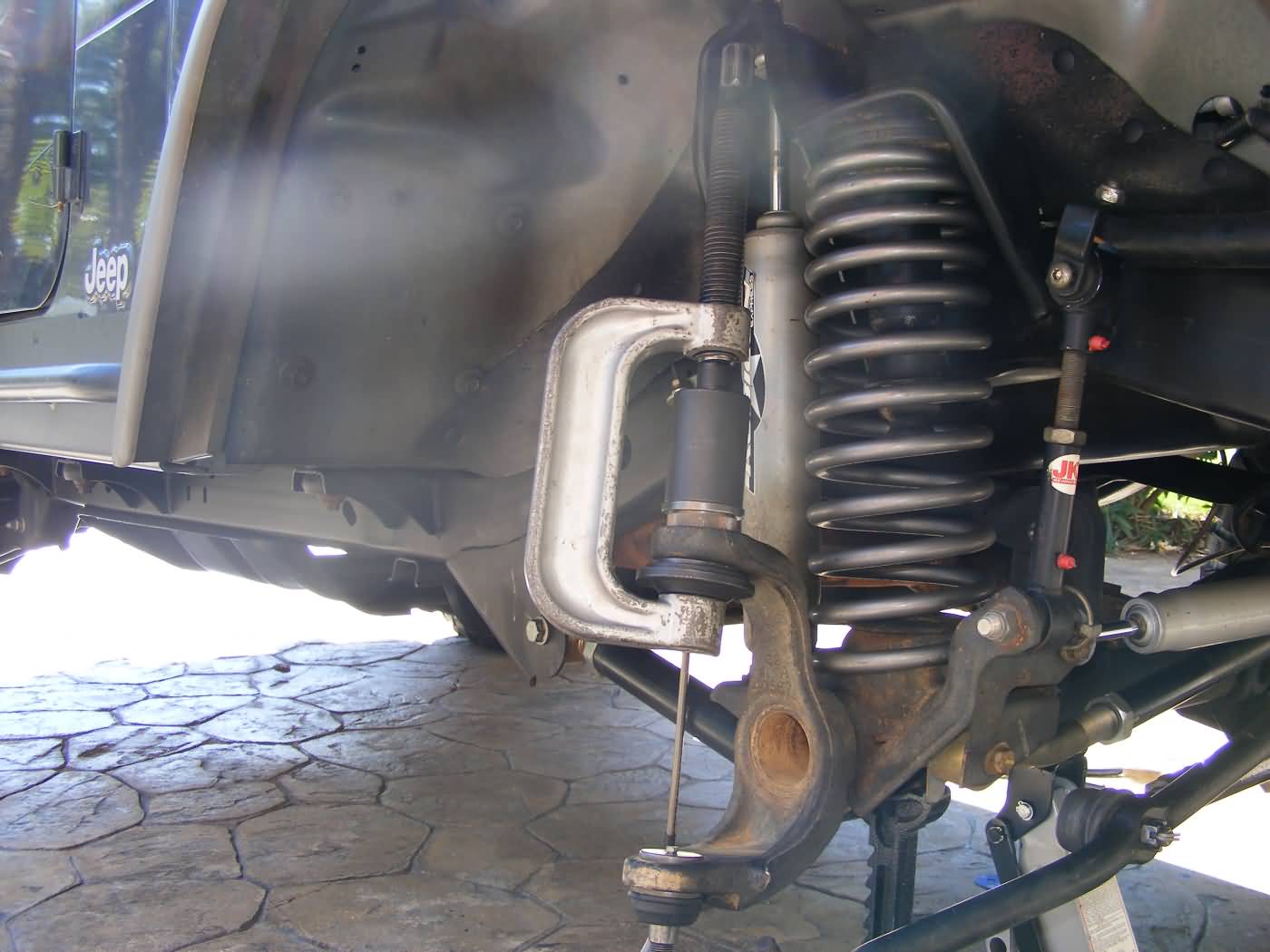

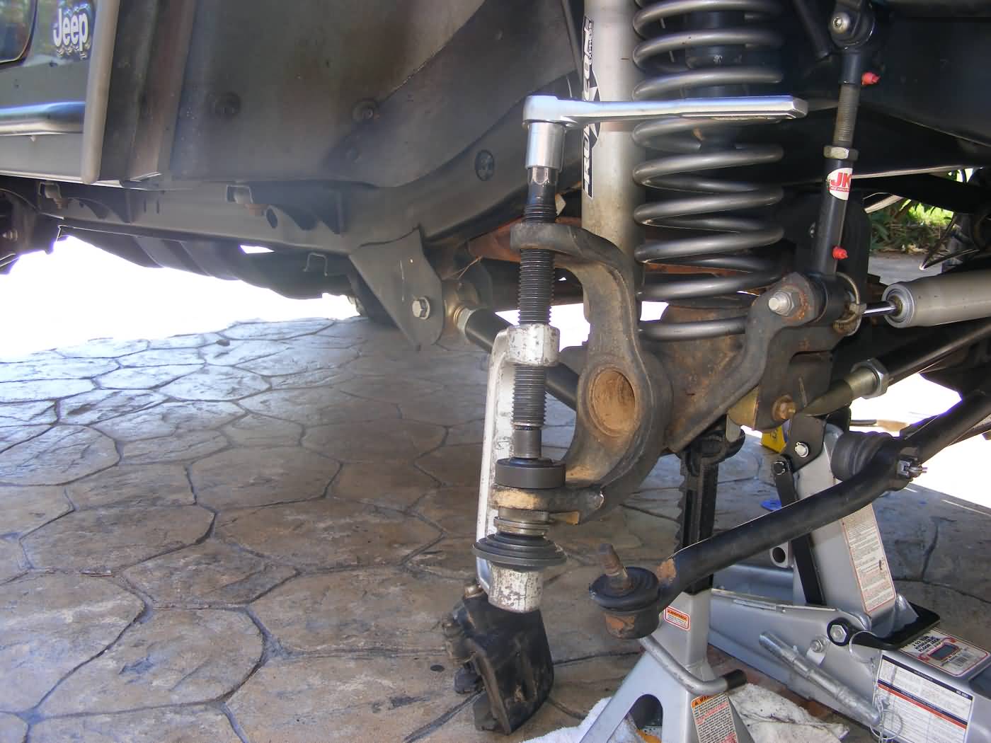

Now that everything is out of the way, we're ready to remove the ball joints. You'll need to use your ball joint tool, and press out the ball joints. Start with the upper ball joint, and arrange the tool so that it pushes the ball joint from beneath, up into the receiver cup. It will take a good deal of pressure, but eventually the ball joint will pop out.
Once the upper ball joint is out you'll move on to the lower one. It's the same scenario except that you'll be pressing down on the ball joint, so that it pops out bottom.

Using your ball joint tool again, press your lower ball joint into place (press up from the bottom). Make sure that it goes in straight (not at an angle), also make sure that the ball joint is completely seated.

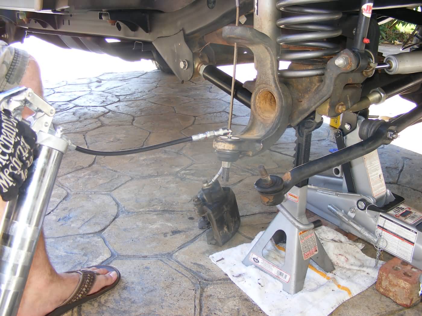

Once the ball joint is in, remove the plug, install the grease fitting, and grease it up.
16-lower-ball-joint .JPG 17-lower-ball-joint-grease-fitting.jpg 18-lower-ball-joint-greasing.jpg
And, when you're done, remove the grease fitting and replace the plug (you have to do this quickly, or the grease will escape). Once that's done you can move on to the upper ball joint.

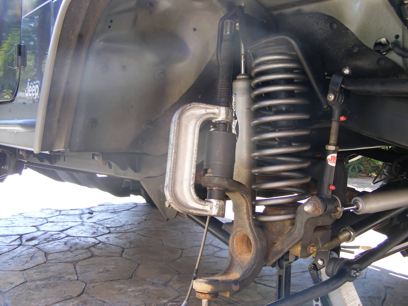

The upper ball joint will go in similar to the lower one, except that you'll need to reverse your ball joint tool, to press it in from the top. Again, just take your time and make sure that it goes in straight, and seats completely

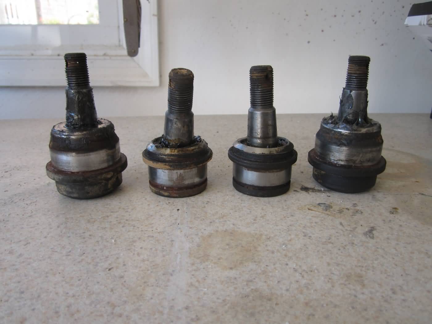

Bad ball joints
The new ball joints that I installed were tight enough that I couldn't swivel / wiggle them with my bare hands. On the contrary, the old ball joints were so lose that just moving them up and down would cause the sockets to wiggle around. Defiantly worn out.
Bad ball joints:
