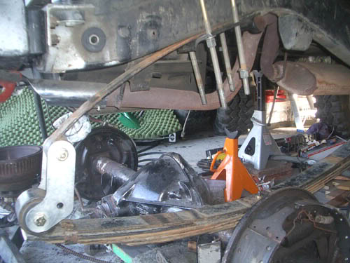

It wouldn't be hard at all...except for maybe the 4 (or however many you want) link part.
Like this: (sorry for such a big pic):

TwistedCopper said:
Buggy springs look like (or are) cut leaf springs. One end goes in the frame mount, the other at the axle. It requires that you install a 4-link because the springs will not be locating the axle anymore.
Close, but no quite. Your are thinking of 1/4 elliptic springs where you cut aspring pack in half and use it upside down. Yes 1/4 eliptic does require a 4 link.
Buggy leaf springs are merely the top spring out of a spring pack, cut in half. You drill drill a hole in the spring and bolt it to the frame (or a piece of channel welded to the frame) upside down. The eye of that spring now becomes the mount for the upper shackle bolt like in the picture. You use your same springs you have now just like they are sitting except that they will get twice the droop because they buggy spring will drop down. The axle is still located under the Jeep because you are still using the "fixed" spring hanger at the other end.
It's really pretty simple and not at all hard to do. I would advise not using the u-bolt method in the above picture though. That just looks like it may come apart..

BryanJeep wrote:
As for the buggy spring setup, it still will not extend the WB. THat is what I am looking to do. Besides, if I got the rear with a buggy, the front would need it too. Do you recommend me getting the BTF rear axle kit and just buy new main eye holders for my current springs?
You're right the buggy spring setup alone will not extend the wheelbase. To do that you will have to do coilovers, airshox, move all the mounts and brackets for your current springs & extend the frame or run offset centerpin springs from a Ford F150.
Never, ever, ever do a buggy spring in the front. If you are not shackle reversed the front end will raise up and get very light on hill climbs. If you are shackle reversed then application of the throttle will turn the pinion toward the ground and also scary when you hit the brakes in reverse.
You don't notice any ill effects of a buggy spring in the rear.
