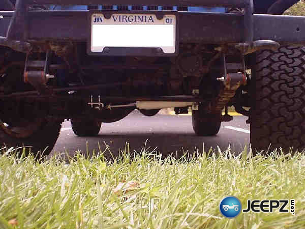

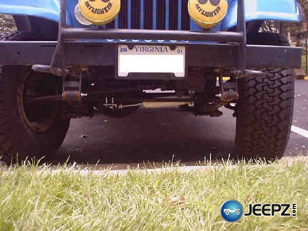

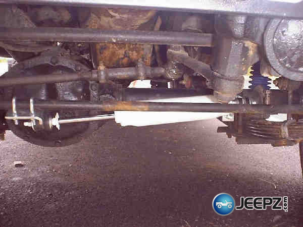

This is a pretty simple upgrade, simply unbolt and remove the existing steering stabilizer, then install the new one using the included hardware. The new stabilizer didn't mount the same way as the old one, one end linked the the axle, and the other to the tie rod (the original mounted to the tie rod on one end, and to a special mount point on the other).​
