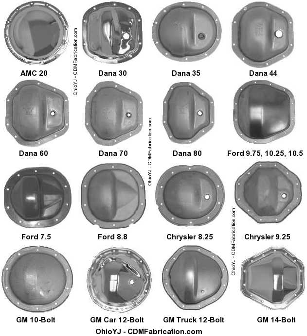

TerryMason Administrator Staff member Mar 13, 2012 #2 I'd suggest using this form and request a "build sheet". This will give you a list of everything on your Jeep when it was built: Contact Jeep In the short term, you can look at the axle - if there is a plastic / rubber fill plug on your back axle then it's a Dana 35. Dana 30: Dana 35: Dana 44:

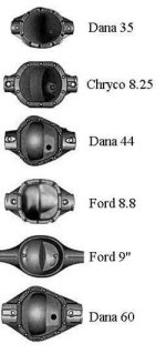

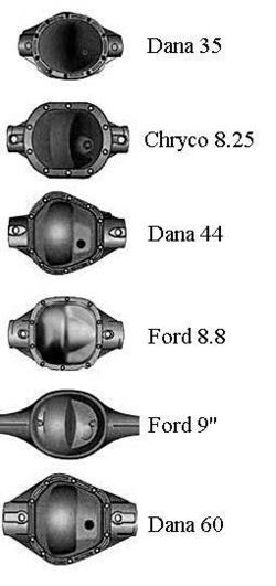

xjmarc New member Mar 13, 2012 #3 Front will be a D30, rear could be a D35 or Chryco 8.25. If you have ABS good chance it's a D35.

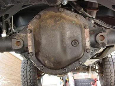

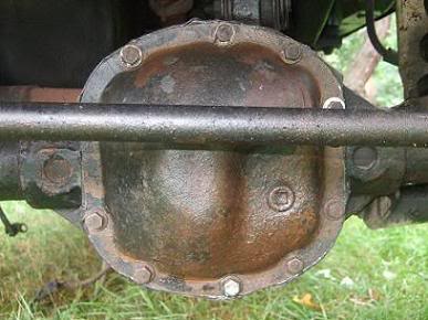

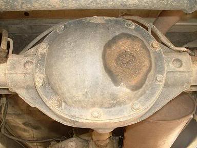

bugleboy New member Mar 13, 2012 #4 heres some helpful pictures i have collected over the last year Attachments image-1071490059.jpg 45.8 KB · Views: 1,385
