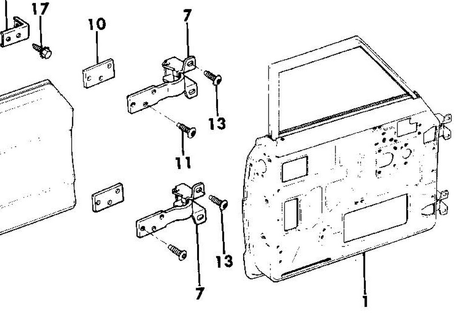

This is the hinge I'm trying to rebuild (labeled #7). So far, all I've found is a full replacement hinge. Seems odd that I can't find a repair kit to replace bushings and pin.

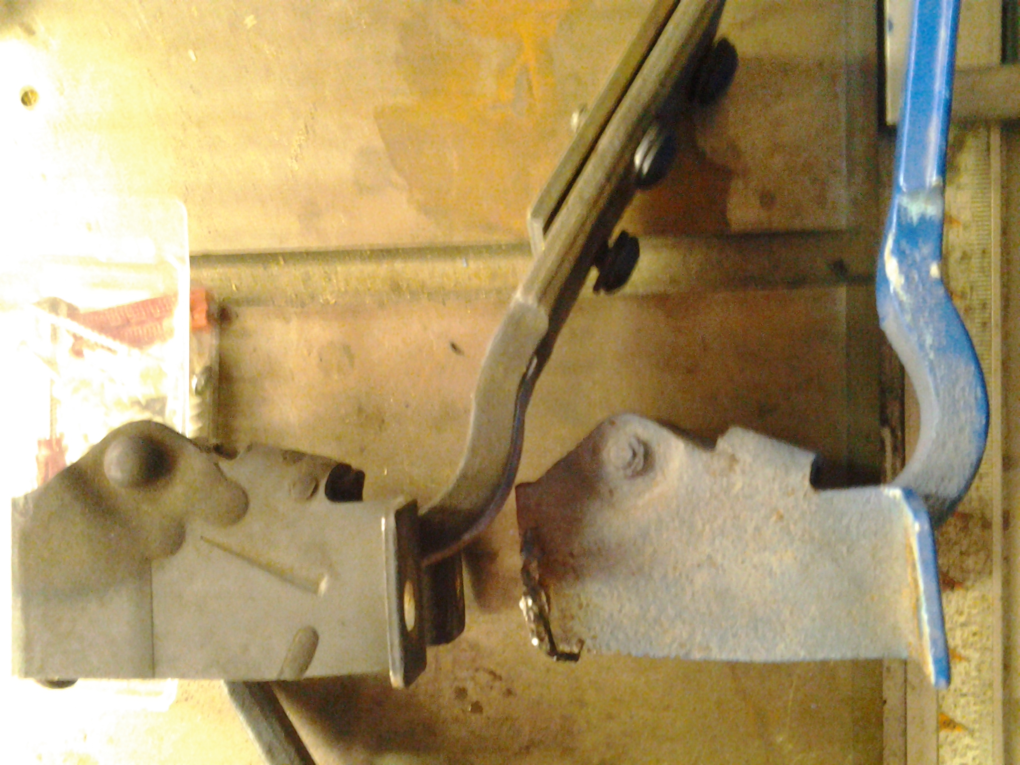

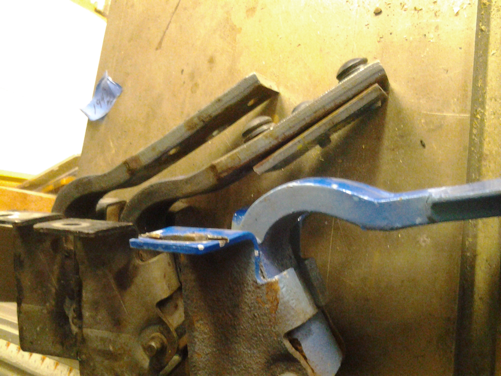

Well... I bought a pair of hinges from an ebay seller, and when I started to swap them out, I found out that the ones I got are SLIGHTLY different, and won't work. They are from a GW, and I definitely need a GW... but the differences between the current and new (to me) hinges are there. Any suggestions on what I HAVE and what I BOUGHT?
The blue one pictured below is what I currently have, and need. The dingy ones in the pic are the ones I got from ebay seller...
As you can see, the "question mark" shape of the actual hinge part is slightly different. In addition, the holes that mount the hinge to the B-pillar are different. Mine are slotted for adjustment. The new ones are not slotted.
