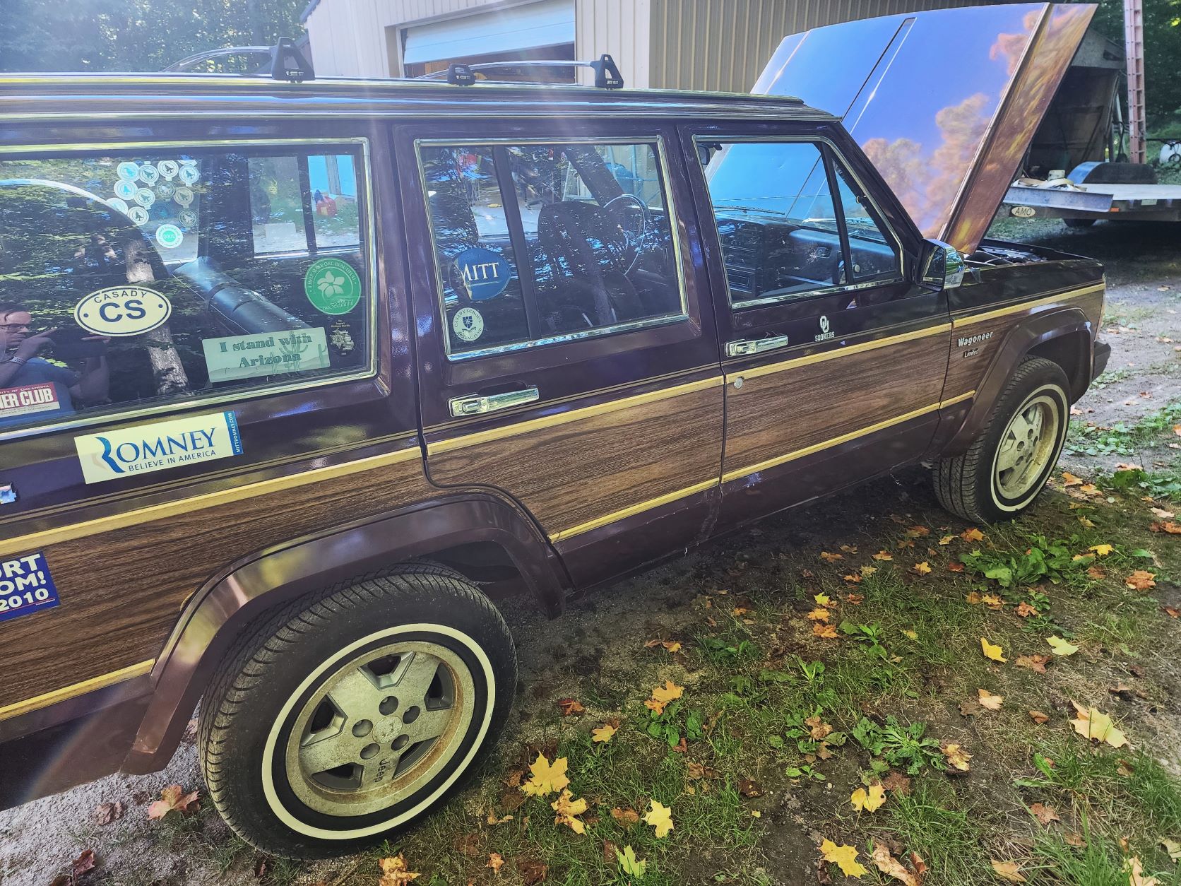

I really love the look of this vehicle. I attached some photos of it! I'd really like to get it running nicely.
The frame is in good condition, but I'm working on the body. There are rust holes I'm going to fill with foam and Bondo, then treat. I have access to these materials for free, thankfully.

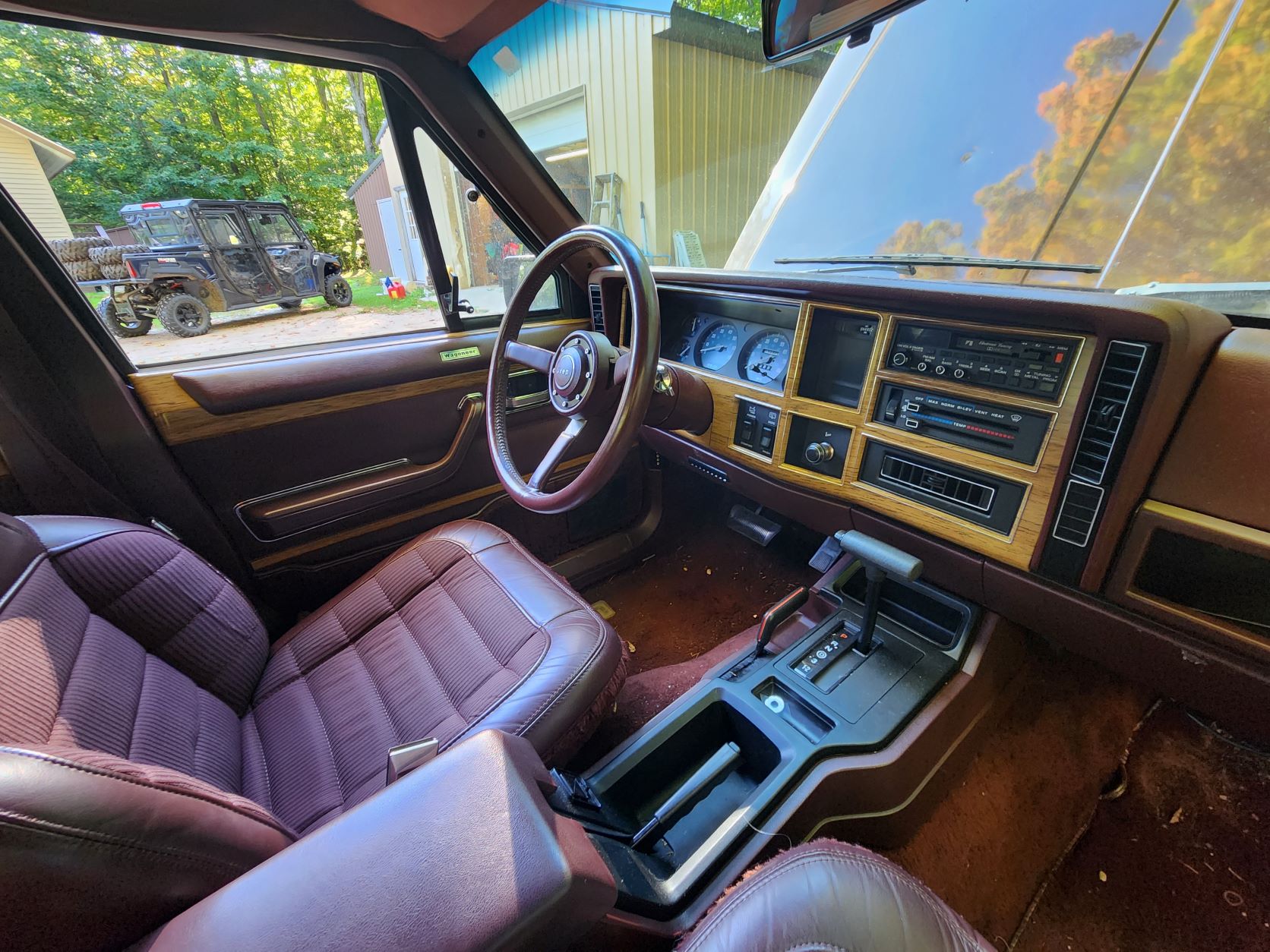

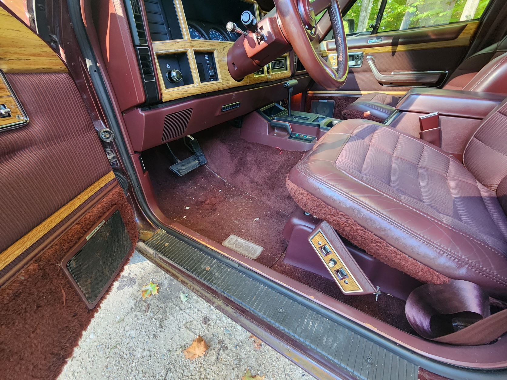

I'm REALLY surprised at the interior. Only ONE rip, and a droopy headliner. Other than that I think it looks great! Of course the speakers don't work well, but that's not that important.
The power seats work (but the controls on the driver seat are falling off and I don't know how to fix it), the window regulators work (mostly - the passenger side regulator seems it's about to die), power antenna works.

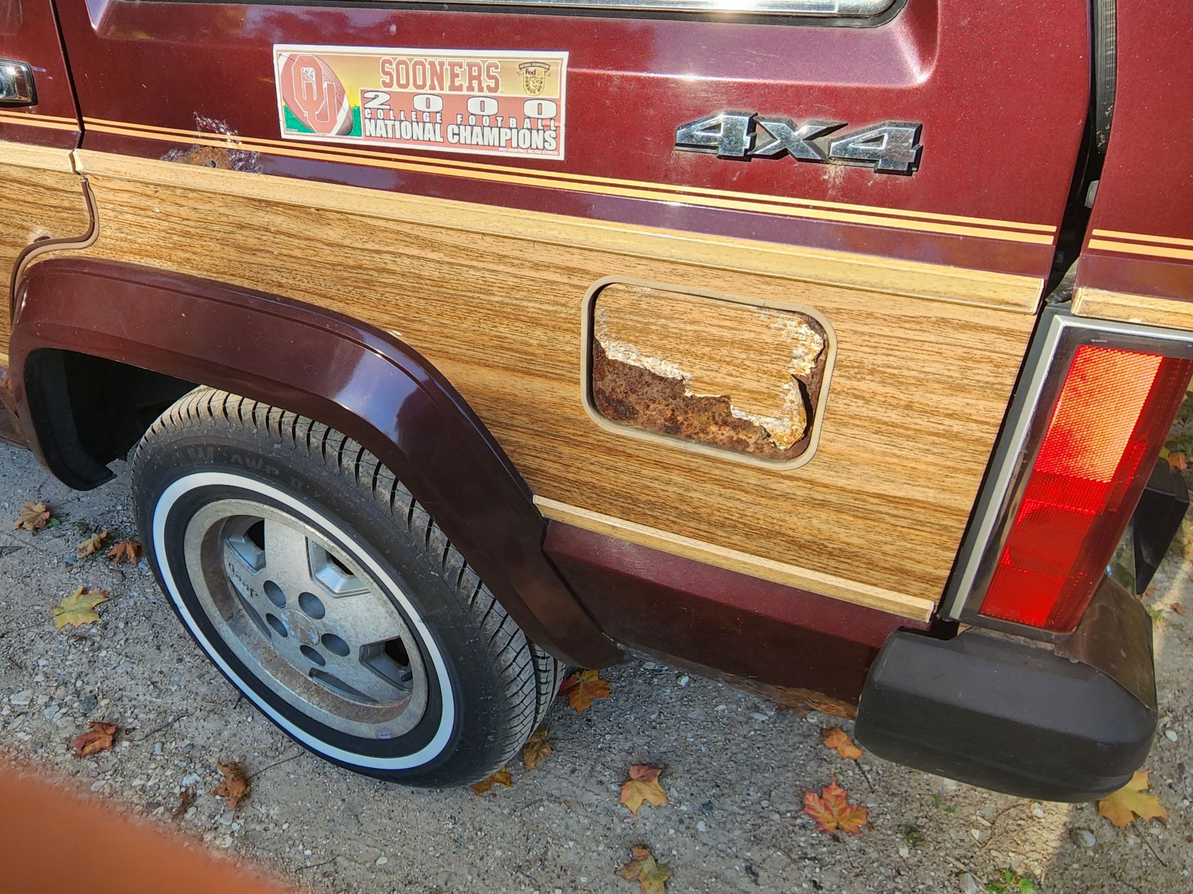

Mechanically it runs well. It runs at really low RPMS when climbing a hill. Need to floor it. The exhaust has a couple holes in it. Transmission isn't that bad! I've driven much worse. Air conditioner and heat works. Shocks are done for, and is a future investment. Wheel wells need a little work. There is a soft rust spot over left/driver rear under the wood decal that I could punch through if I wanted to. Ha. I would like to fix this but would need to purchase a complete decal kit. I plan to buy some all-in-one 4B mocha brown spray paint soon too!

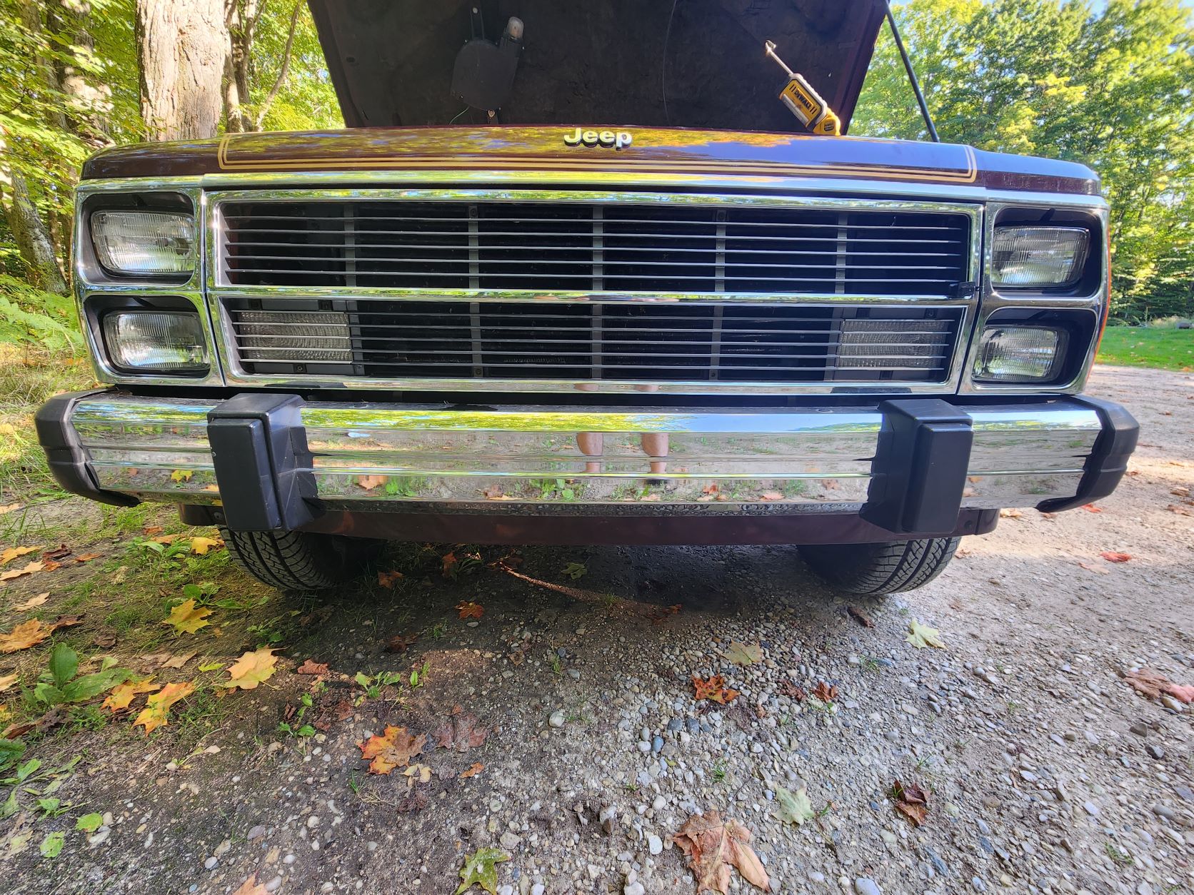

and you forgot the most important picture of that jeep. the front. do you have the four headlights? you should and its such a rare jeep that you have. i would totally fix that xj up and keep it
just take the switches out for now and clean them. usually cleaning the contacts makes them work again. and you can pull the door panels and make sure there is power to the motors with a little test light. if there is, you can clean them and they should start working better. if not, than you have a broken wire in the black plastic tube going from the body to the door in the door jamb area between the hinges.

As for the picture of the front of the Jeep, I reached an upload limit on the initial post. It's in GREAT shape. Here it is!
man!!! you got the jeep we always hope to find at a great price, and have spare money for, ha ha ha. those are awesome and so rare
