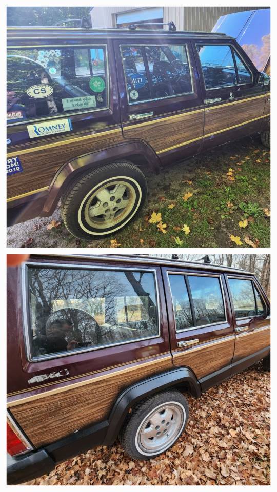

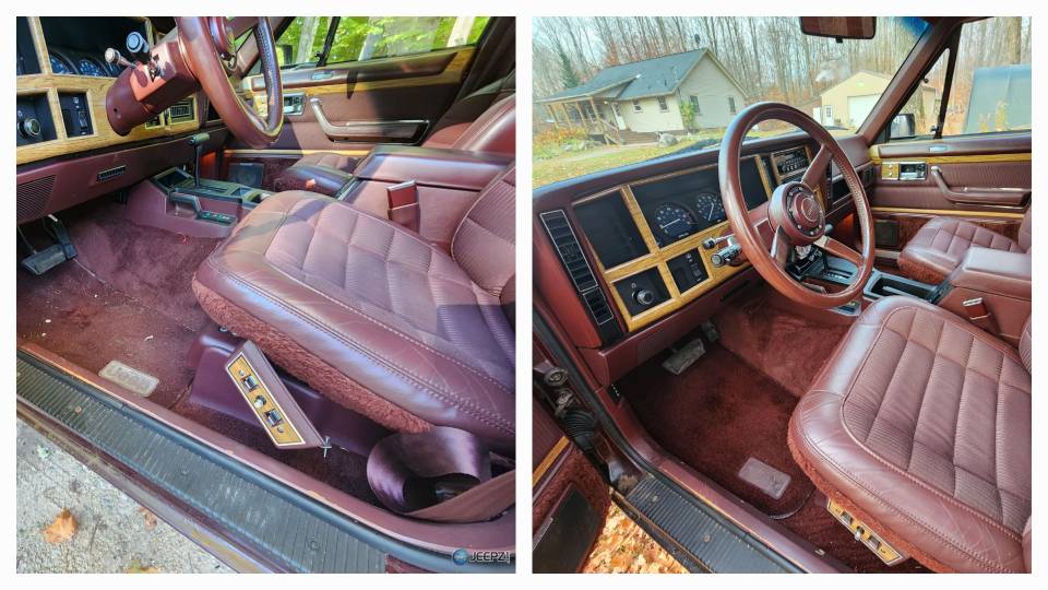

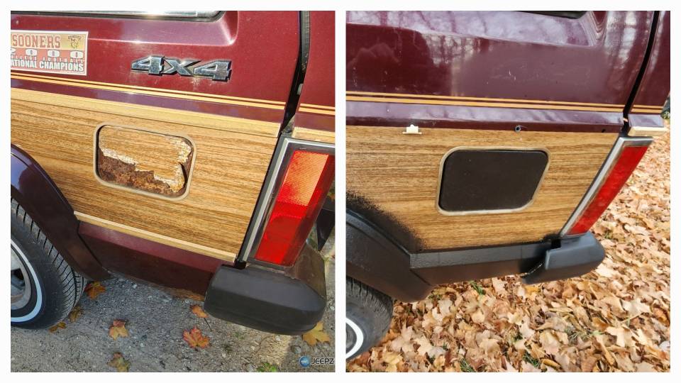

Attached are a couple before and after pictures.
Thanks for the interest and support everyone.![20221103_104219.jpeg 20221103_104219.jpeg](https://www.jeepz.com/forum/data/attachments/22/22613-b7342f1110f57fe958e10841837458a8.jpg)
![20221103_104147.jpeg 20221103_104147.jpeg](https://www.jeepz.com/forum/data/attachments/22/22614-edec2e9bf02c2f4424ad634c656ee92e.jpg)
![20221103_104115.jpeg 20221103_104115.jpeg](https://www.jeepz.com/forum/data/attachments/22/22615-69cbea888371d92101ef324eb184b751.jpg)
