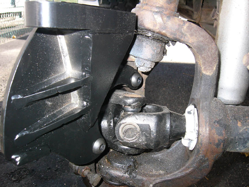

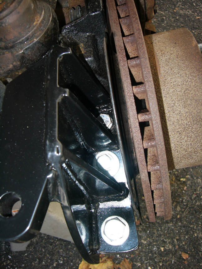

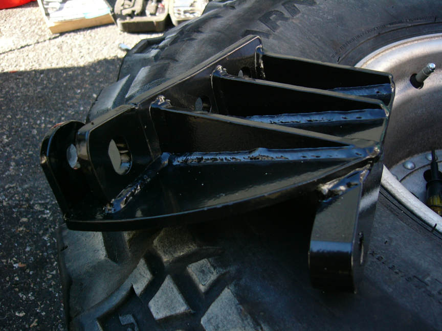

These Brackets are pretty beefy, they are mounted to the knuckle with 5 bolts... 2 of which hold the axle in place. I am very impressed with this conversion, I wish I could have done it with a D44 but it's just not in the budget not to mention this is my only vehicle for now.

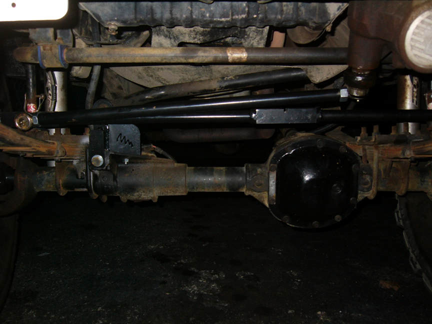

The track bar relocation bracket they sent me is awesome too. It actually bolts on in two places on the axle side, there is no way it's moving like my last one (which was bolted AND welded then still broke). Everything is powdercoated and very well made.
I am currently making some new brackets for my dual steering stablizers so they will work with this system, once those are on the jeep will handle even better. I am getting an alignment tomorrow, if you guys have any questions go for it!

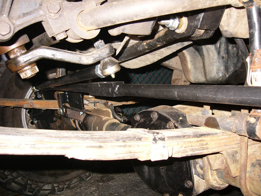

You may want a flatter pitman arm to get the draglink and trackbar parallel, I used one from an SJ.
Hey there, sorry i was away on buisness....
The drag link will be more parallel once I get the pitman arm on the box more, it can probably move up another half inch but not with the tools I have. I am still doing work on it before it's aligned, but the front end shop will snug that pitman arm up for me and the bars will be closer to parallel. I don't have any bump-steer right now as it is though so that's good.
I thought the bolts were grade 8 but I guess that one looks like a grade 5... I'll have to check, but they are staying for now... I don't see them breaking anytime soon.
Stupid me forgot to change the ball joints on the pass. side when I had it apart.... the Stomper goes under the knife again tomorrow now.
The pitman arm doesn't go up any higher. If you have that nut reasonably tight, then it's all the way up. Just make sure the nut is tight as hell.
