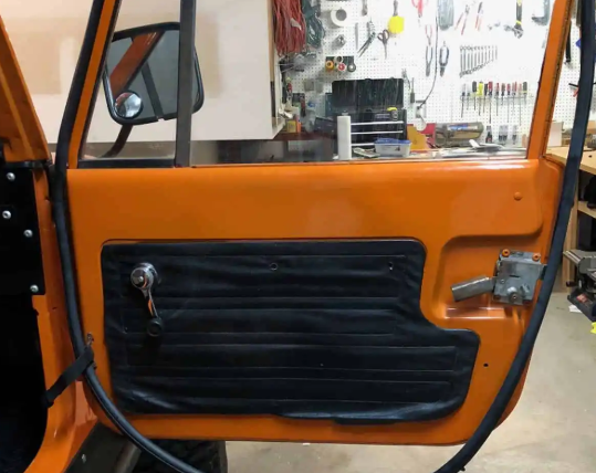

Are you sure that you have YJ doors? I believe that you can put CJ doors on a YJ. Maybe someone swapped yours?
you can put cj doors on a yj. the pull handles are different to open the doors, is how you tell. yj have little plastic pull handles that pull horizontally and cj have a larger pull handles that pull vertically.
yj door
cj door
i also think the striker is different, if i remember right. i had some cj half doors i ran on my 87 yj and i had to do something to put the cj doors on when i took my full yj doors off. i just cannot remember what i had to do. i want to say the cj doors used a striker post and the yj used a bar but i might be mixing up the sj, yj, and tj doors on that part
